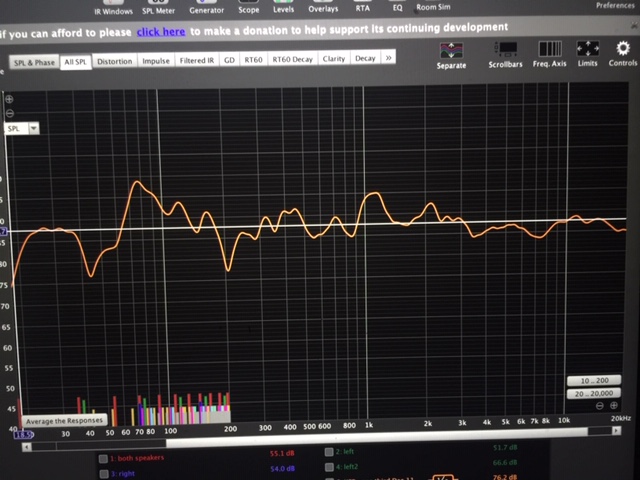

I understood that my room needed to be treated with my Spatial M3 Sapphires but being new to understanding room acoustics and purchasing a number of absorbers and diffusors from GIK, I was curious to do a room measurement of my room 16x18x8 hard wood floors. I purchased the UMIK-1 and using REW did my first measurement. I'm hoping I used it correctly but I did set up the mic in my listening position. I think I read somewhere that there's a lot more than just the sweep but the difference between whats generated and what's recorded. Not really sure what I'm looking at so if anyone can assist me in understanding the graph I'd certainly appreciate that. Thanks in advance.

It's true, I almost never look at simple response graphs. I think the time-based measurements give us much more an idea of how the room actually sounds. Spectrograms, waterfall graphs, ETC/Impulse responses, RT60 times, etc. Keep in mind sound is a time-based phenomenon so the time-based data is critical, much more so than a frozen snapshot in time from a graph.
The main thing we are after is consistent decay times across the frequency spectrum, in the bass range I'll look at a waterfall graph, or the spectrogram is great for a "view from 30000 feet". And the Impulse/ETC gives us a lot of info about early reflections and clarity. My very first article years ago on the GIK site was about ETC if you are interested in that.
Tons of good info in the REW help/manual also.

Nice. See how the waterfall mimics the graph above. You have some wooly base to tame. And your 150 to 500 is dipping down ever so slightly.
Trim you graph from 20 to 20,00 and play with the resolution to say 1/6 for less busy-ness. Most folks hate that smoothing level of 1/6 but you need to adjust the big hitters first before worrying about the minutia.
You have the mic vertical? It's at ear level? At your normal sitting position. If using a tripod, move the mic forward and backward and take measurements just to satisfy your curiosity about how the room influence the sound. Then try moving the speakers out from the sidewalls and front wall. It's fun.

I believe the mic should point straight up, not forward. It won't make a mega difference but I believe that is the recommended orientation.  Curtains and rugs will not do much for you. Your bass hump is the gorilla in the room right now. But move the mic around and see how the bass changes in the graphs (frequency sweeps) and the light will go off for you.
I ended up sitting back farther than I normally do because I could not avoid a null where I usually like to sit (62% back from front wall). So I measured about every 8 inches from there backwards until I found a spot that leveled out the response. I have poor mathematical numbers 8 x 16 x 20 so lots of frequency boosts to deal with.
I spent time getting my speakers located first to get more even bass response and you can see those results (but keep the mic location consistent so you have apples to apples).
It will take a ton of trapping that is not feasible to flatten that bass hump unless you move your chair or your speakers.
Plug your room measurements into this and see if the frequencies line up with your measurement. Your room is the gorilla's mom!
http://www.bobgolds.com/Mode/RoomModes.htm
I'm not the expert. They'll be along soon.
Keep notes and save those files with good names that mean something next year.

I have recently taken some frequency response measurements, and other than the bass region (which is a big deal, I know), I am fairly happy with the shape of the curve.
But, when i hit the waterfall graph option, my setting seem to be all messed up.  The entire frequency range is pushed against the front....when I know only the bass region normally shows this. Can someone please offer some guidance on the waterfall graph settings?
