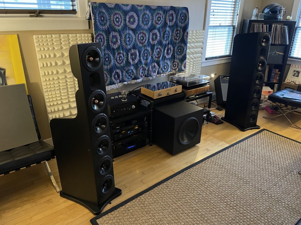

That is probably the best glamour shot of the Oticas I’ve seen. Congrats on having one the best sounding speakers in the world!
Chewbacca
Re: NX-Otica Build, and Something Personal!
« Reply #41 on: 24 Nov 2021, 07:47 pm »
Thanks mkrawcz! The speakers certainly are photogenic! :lol: And yeah... It's an amazing feeling knowing I get to go home to them! They're wonderful :green:

No doubt in my mind these are my favorite looking Otica's. I'm not sure why because they are "just black" - but something about the paint job just looks spectacular as does the cool lighting in that room. I'm so glad to hear that you love them - these NX series of speakers are lights out.
Chewbacca
« Reply #43 on: 24 Nov 2021, 08:01 pm »
Thanks, subsonic1050! That's quite the compliment!... But for real, there is something about the black on these. I'm really glad I went with the "just black" :lol:

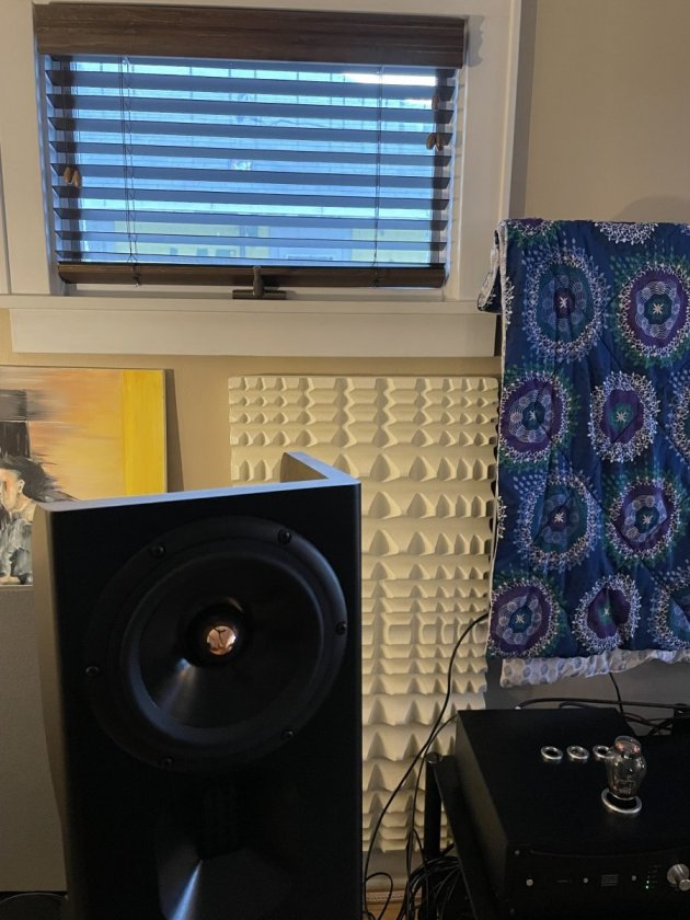

BUT! It's not perfect, and there are some inconsistencies, mainly on the inside of the left speaker. I went out and bought some 1000, 2000, and 3000 grit sandpaper to try and give them a wet sanding (going to try an inside wing first lol). It has two layers of finish coat on them, so there shouldn't be any problem having enough material to smooth them out!

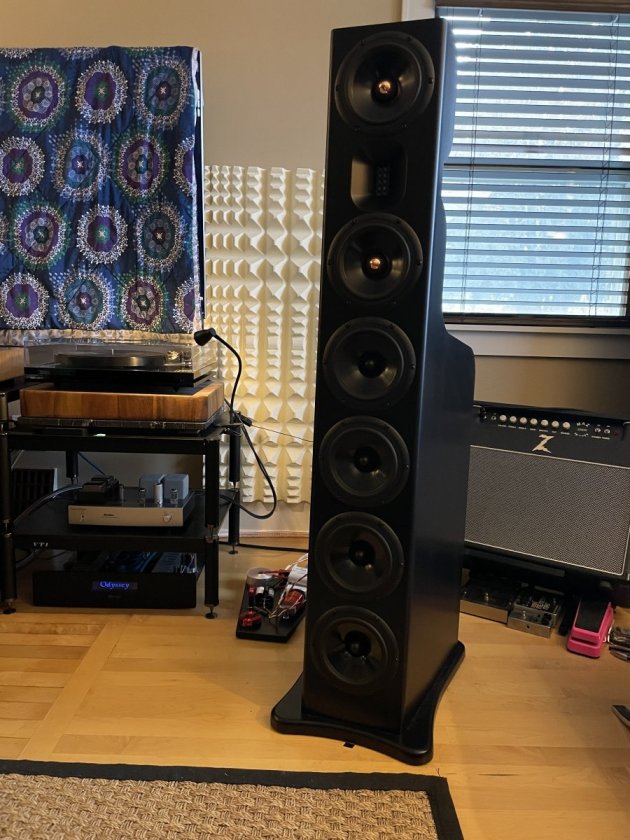

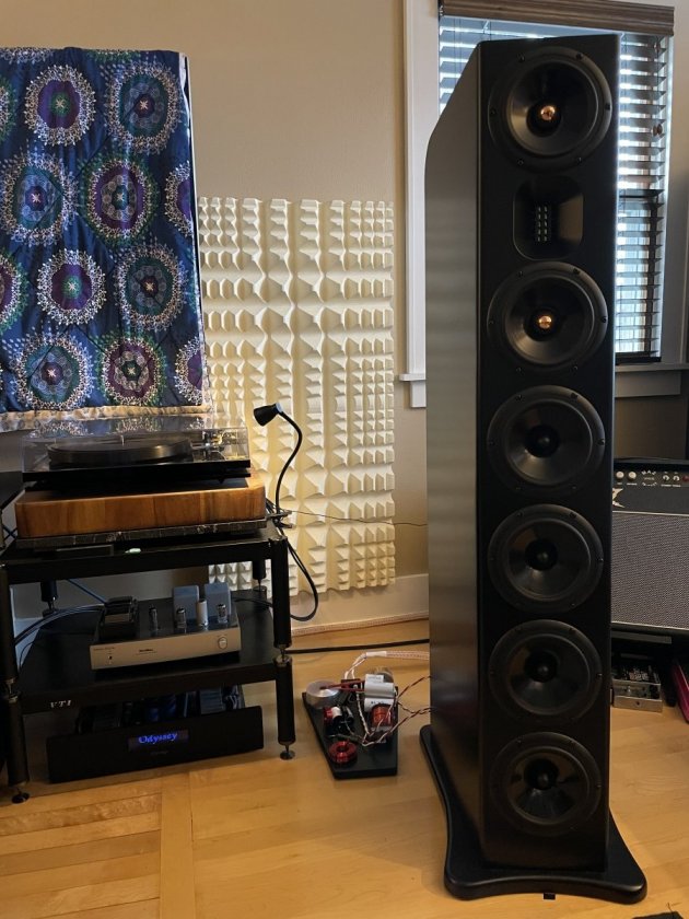

Well, while I'm here I may as well give an update. I've been running the speakers most of the time since they've been up, Music/TV during the day, pink noise at night. Probably somewhere around 30-40 hours on them. I also worked in the sub. It took me maybe 3 minutes to get it 95%. It was the easiest integration I've ever experienced. I had my previous speakers in the (near) exact spot I have the Oticas, so the phase was already locked in. With my room the Oticas play flat down to 50hz, then have just a wonderful drop to them. On the back of the amp (Rythmik F15HP) I have the crossover set to 35hz, so it crosses around 42hz I'd say. I have the sub down maybe 1.5db, so it doesn't draw attention to itself (still being a boxed speaker)... and it sounds AWESOME! Honestly, the first day and a half I didn't even use the sub. I didn't even reach for it. These things could EASILY play without a sub in my room. Everything it produces it just produces SO well. The mids and lows have really opened up the past 20 hours. The slam, the grit, the detail, is just unmatched... But, the tweeter still needs to be burned in. It's hit or miss. Every hour it seems to change from harsh, to pretty smooth, to shrill, to amazing, to "I can't listen to this... But everything else is so good I can't stop!". So if this tweeter can live up to the challenge of the best mid bass (no doubt) and absolutely astonishing bass... This is end game.
I could not be happier! I'm literally just giggling when I'm listening to music. Or shaking my head in disbelief.... I haven't even put the NoRez on the inside yet. I should be able to get to that this weekend. Awesome awesome awesome...
Some pics of the current toe in. Doing a 8' equilateral triangle. In addition to using the golden ratio for speaker placement (1.618). So my speakers are a distance of 1 (44") off the front wall and a distance of 1.618 (~71.25") from the side walls. I don't see a need to change it currently. The stage is unreal.
