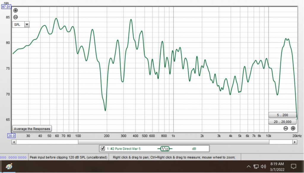

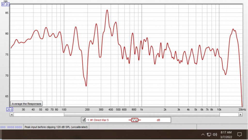

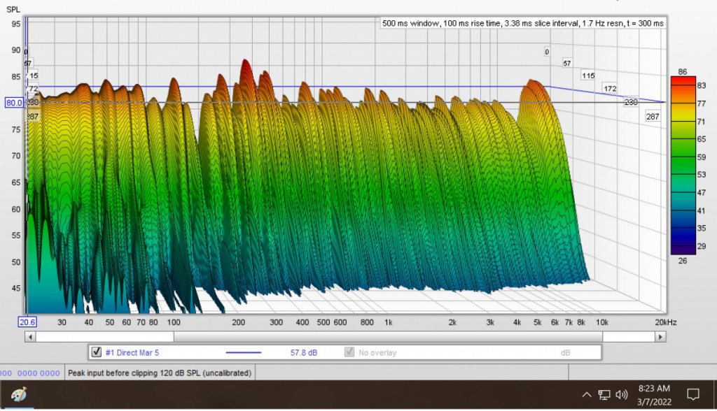

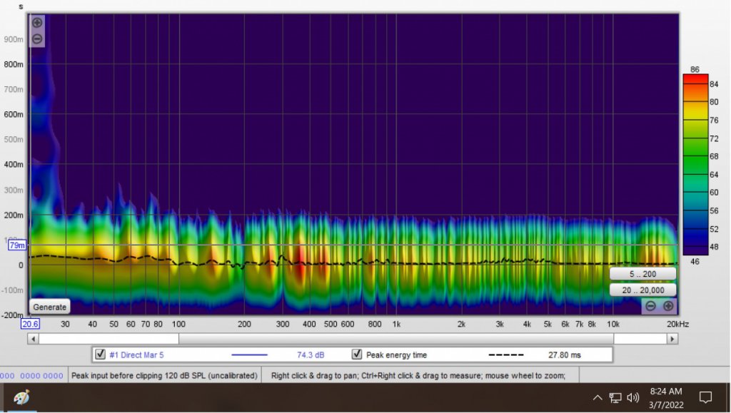

« Reply #87 on: 7 Mar 2022, 05:01 pm »
So I finally got around to measuring my room with new speakers and subs placed about as good as they'll get. I'm sure if I completely reorganize the room I could find a better solution, but this is already pretty fantastic and A HELL of a lot better than my old Klipsch were. It's a shame that I'm in the smallest room in the house, but my wife said I don't get to monopolize the garage and the bigger spare bedroom lol. I'm using the dsp in my receiver to knock down the 60-70hz small room bass hump a little and bring up the 4Khz a touch which is a result of not using extreme toe in directly to the mic. I do like the clarity of no dsp better but it is one of the necessary evils in this small room at the moment. Right now I have the speakers in a semi-near field setup about 5 feet apart and 4'8" from listening position and toed in to just behind the listening position. This setup in my small room keeps things as consistent as possible but there are 2 big ones @190hz and 360hz that I still need to fix, but that's a different project. All in all, they sound freaking fantastic.  :thumb: While it is a fun sound for more bass on live rock tracks, it muddies up everything so I'll opt for clean and smooth at about +5dB. Also, please excuse the rats nest of cables. Merely a temporary deal that will be cleaned up. Now that speaker placement is solidified I can finally scale down wires to size and install tube connector ends.
Response with DSP on receiver
Response w/o DSP
Waterfall
Spectrogram
Room

« Reply #89 on: 8 Mar 2022, 03:12 pm »
It's an extra 4" thick acoustic panel I had around that I placed there to try and tame the room resonances. I would need to resize it to fit on the wall there, but for the meantime I just have it leaned up against the wall. Having one there really helps smooth out some of the 150-500 funkyness. I also have one on the sides at first reflection and one just above my head on the ceiling. I know having the door closed does make it less jittery on the graph. It also increases a spike in pressure at 50hz so I tend to leave it open. My ears don't hear the jittery graph line, but they do hear the spike in bass. There's a lot of work to do with acoustics, but those are my next set of projects.
The biggest thing was getting the positioning right in my small room and integrating the subs. I know the nasty dip at 190hz looks gross but it was a compromise from a similar cut at 100hz and spike at 70hz and 140hz. I ended up pulling everything farther out into the room (front baffle 36" from front wall), running my subs much lower power (20%) but crossing them over much higher at about 110hz.

When taking a room response measurement please remember to only measure one speaker at a time.

« Reply #92 on: 10 Mar 2022, 02:07 am »
Hi Danny,
Thanks for the tip! I'm still fumbling my way through learning how to work REW, so I'll take any bit of advice I can get. And yes, I was measuring both speakers at the same time. I'll measure again this evening one at a time and see if I can get it any better. I'm already super happy with how they sound but if it can be better then I'm all for it!

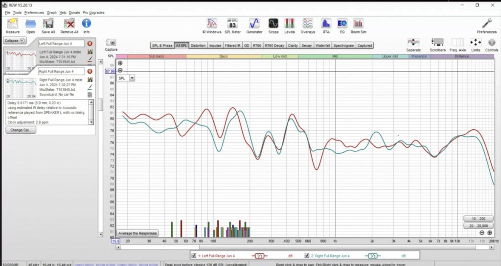

Hey Danny,
Thank you for the tip on using REW properly. I feel silly that I was doing it wrong the whole time, but the improvement is amazing. I went crazy measuring a bunch of stuff, changed settings, placement, and even rearranged the entire room 90°. In the end, I came back to a somewhat similar layout in the room. It's part of the gig for listening in a small room, but also an absolute testament to how fantastic these speakers are that they can be presented with that kind of physical limitations and still shine. Holy crap!
Thank you again for all the help from you and your team.
Current in-room real measurements with subs turned up a little for good bass impact. Not sure if anyone checks this thread anymore, but just wanted to reference measurements since I didn't know what I was doing when first building these speakers.
