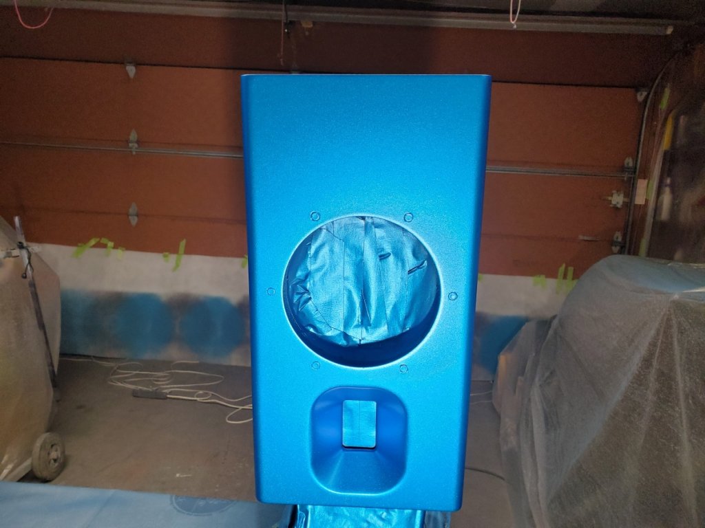

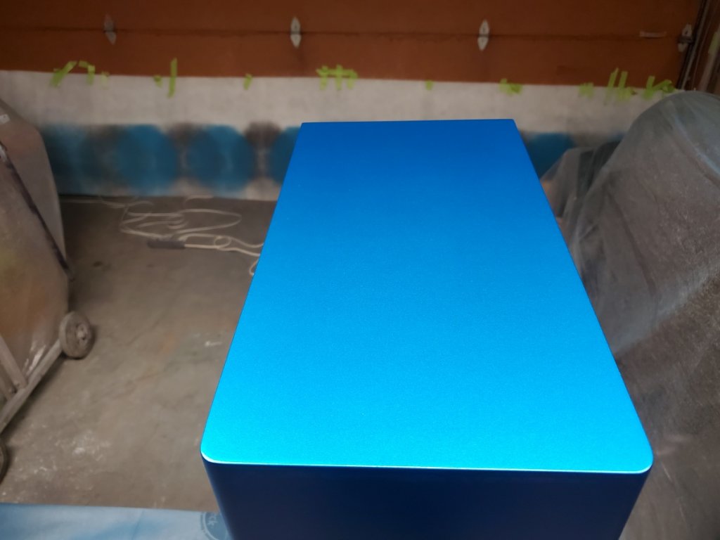

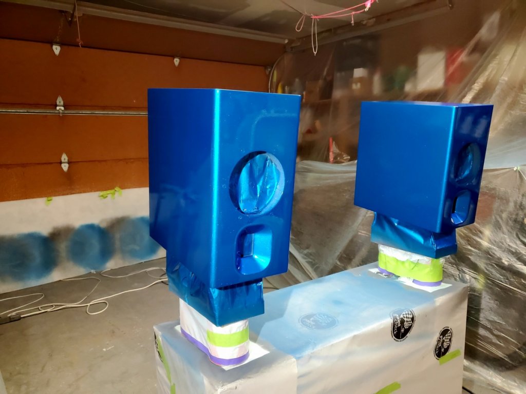

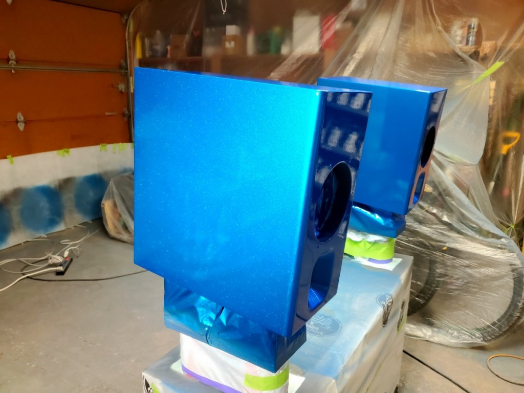

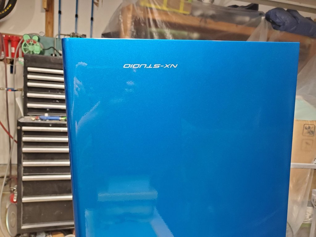

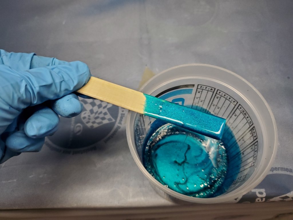

Pictures DO NOT do it justice, but here are some teasers.
The base color is a specialty blue flash metallic that shows sparkly green shade blue head on, but rich red shade blue on the side. The candy is a blue candy with some glitzy PPG Liquid Crystal series pearl tossed in there. Without the light flashing directly on it the color is a rich blue, but once the lights hit, holy crap.
Tonight the temp dropped and some rain fell which spiked the humidity in the garage. Not good weather for painting at that point. I'm going to clear coat these in the morning and then these things are going to look really something special.

That color looks incredible! :o

Amazing, dude! Very nice.

Once they are dry and fully finished you should take some pictures of them outside in daylight - that will give you much better pictures.

Oh there will be some good photos later. Just trying to post as I go and be as informative as possible for anyone wanting to follow along to the painting process steps and tips. Once I get clear on them today, they'll really pop. Still a long way from done, but I can finally see the light at the end of the tunnel.

Got clear on them last night. Going to let it cure through today before I start sanding it all flat to spray logos on and airbrush a bit.
Really I just can't wait to sit and listen to them again. I need to remember to slow down and enjoy the process. More to come soon!

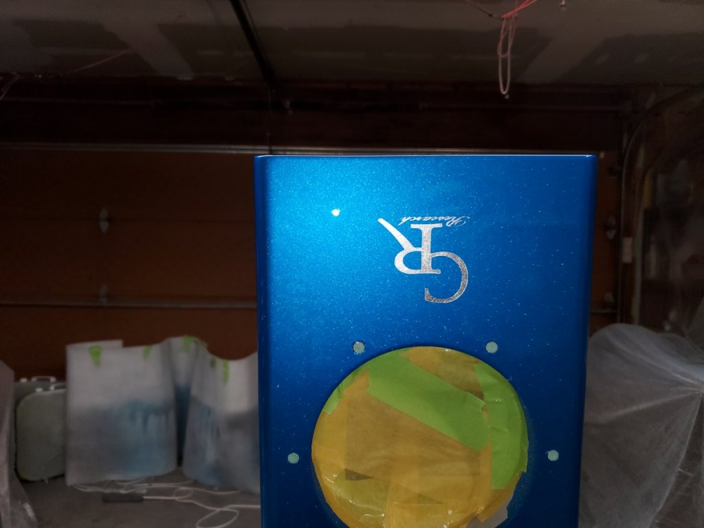

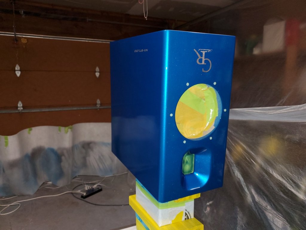

Last night I was able to get the NX-Studio stencils sprayed and the GR Research logo silver leafed and also added a little more candy to darken the waveguide to make it look even deeper than it did. The silver color for the nx-studio stencils was a special ultra fine bright silver that's in a couple fancy car paints like the Nissan GTR or the SLS Mclaren Mercedes. The silver leafing is always such a pain with how delicate and ultra static clingy it is but it looks so good! I brushed it with a slightly stiffer bristled brush than the usual ultra soft makeup brush in hopes to distress it ever so slightly. Since it's been pretty cold here during the evenings I didn't feel comfortable hammering on a ton of clearcoat to really bury the lettering. Instead I decided to do 3 medium coats which typically results in a little orange peel and thinner film builds over the lettering which would prevent sanding and polishing straight away. Better safe than sorry, so instead I spent this evening sanding them dead flat again and will get the final coats of clear on them tomorrow afternoon. After that I'll sand and polish them, then spray the top ramp section in SEM trim black (satin black) then I'll be done painting! My hands will be excited when this is all done. Did I mention that sanding is labor intensive? :lol:
The end result will be awesome but I'm enjoying the process.
