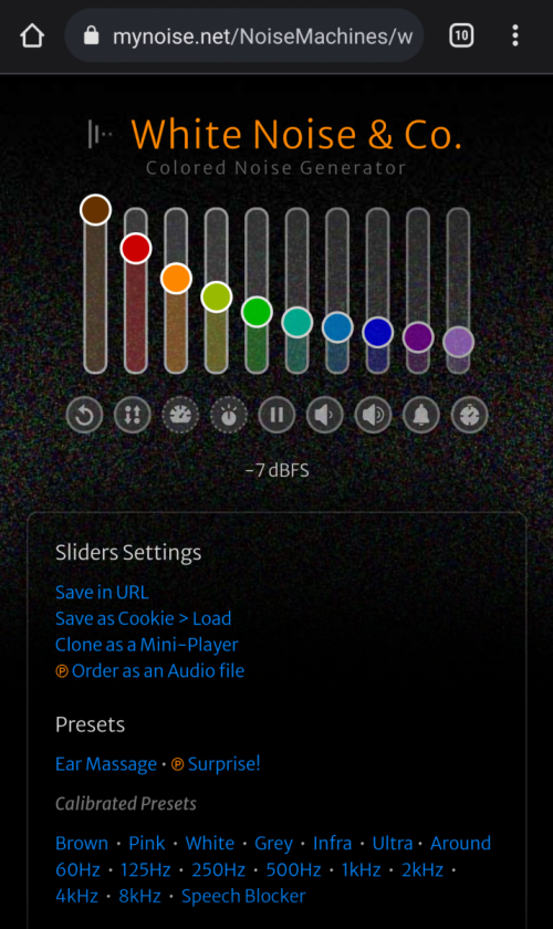

There's a couple ways you can go about it since you're using a PC.
The easiest will be to use a free online noise generator:
https://mynoise.net/NoiseMachines/whiteNoiseGenerator.php
Here are the slider settings I used.
Or if you dont mind manually restarting the video every 10 hours this video has more focus on deep bass than the generator.
https://youtu.be/hXetO_bYcMo

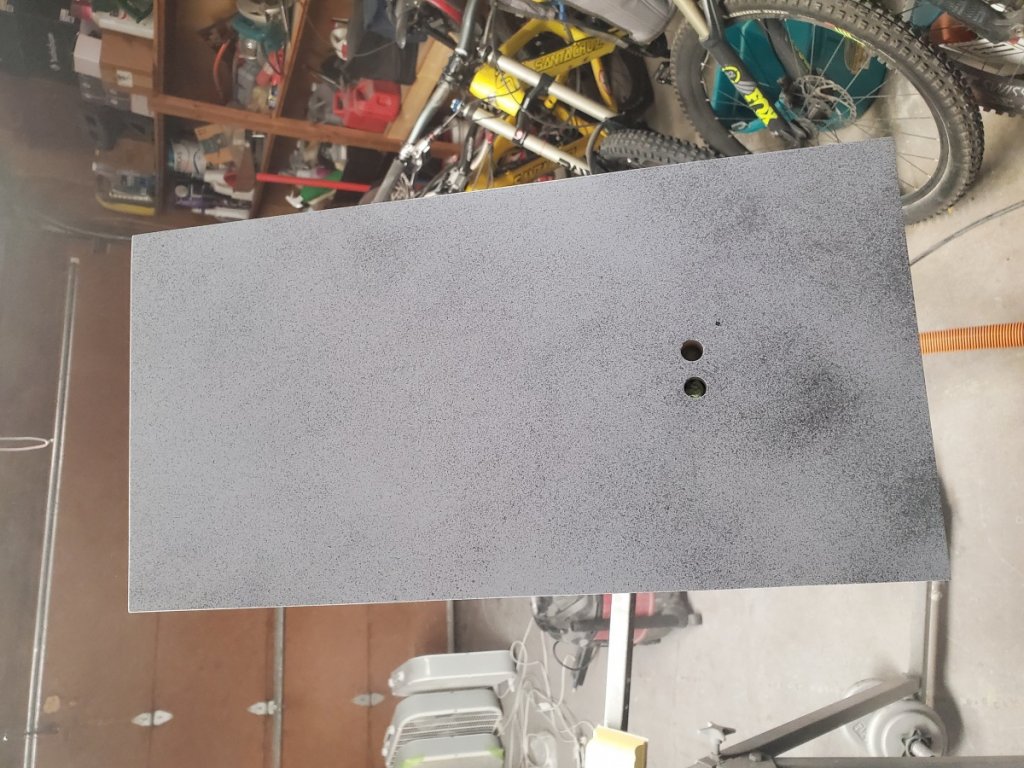

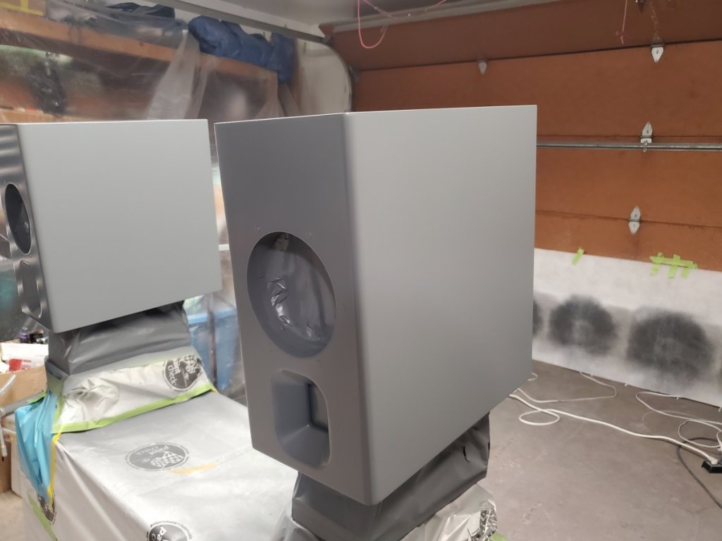

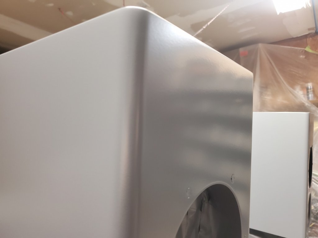

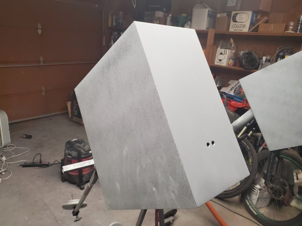

Just wanted to post an update along with some more little tips on prepping for a paint job. Right now I've applied the 2nd round of primer and am block sanding with 320 grit before finishing to 600 on the DA sander. I should finish sanding today and begin cleaning the garage for painting this week. I wanted to mention when building these that no matter how careful you are with clamping inevitably the corners will need to be flushed up unless really rounding them off. One help with getting smooth flat sides from edge to edge is using guide coat while you're block sanding. There's aerosol versions or dry powder versions but essentially it's super thin spray paint that will quickly show any high and low spots as you sand so that all your sides are super flat and smooth. Without that it would have been terrible on where the sides join together.
I'm getting super anxious and excited to get color on these. Let's be clear, I HATE body work and sanding, but I'm not willing to shortcut these steps. They're too important to making a perfect paint job. As you can see in those photos, the backs had a tiny bit of a high spot where the sides poked out a bit farther that I never saw until after the first couple swipes sanding with the guide coat. In the end, all the work will be worth it. Another thing that is mandatory for proper block sanding is a hefty size bottle of ibuprofen. No matter your age or physical conditioning this is still hard work.
