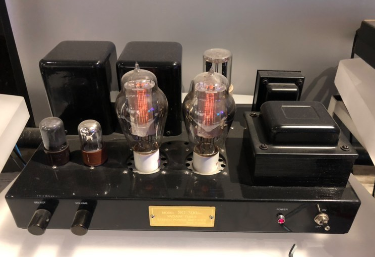

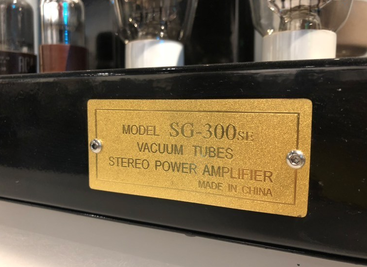

Wondering if anyone on the forum has experience driving the M3TM's with an 8-watt 300B tube amp?
I know next to nothing about transistor amps, so let me preface this Q with that.
More details on the amp:
300b amp that has mesh plate px 25
8 watter
Some pics:
A friend is offering me a great deal, and I've always wanted to add some tube gear to my 2.0 rig. I've had headphone tube amps, but I've only used a Marantz 4300, and my current Schiit Vidar (x2) and MiniDSP SHD with my Spatials.
Is this amp a good pairing for the M3TM's?
Will I be severely disappointed with the 8-watts compared to the other solid state rigs I've had? Is an 8-watt tube amp enough to push the M3TM's?
Also, any thoughts on what a 300B like this should sell for?
Thanks in advance.

It depends. 8 watts of quality SE tube power could work well in a modest room if the Spatials are ~93db to 97db+.
If you already have the Spatials I would just try it. Otherwise it will depend upon the efficiency of the Spatials and the quality of the Chinese made tube amp, which are often made to meet a pretty low price point. The transformers are usually the weak link.
Agreed. I have the same single ended 2A3 amp that I tried 3 different output transformer pairs in and they all sounded very different.
The potted transformers (like in the pic) are tricky because you don't know what is in there
