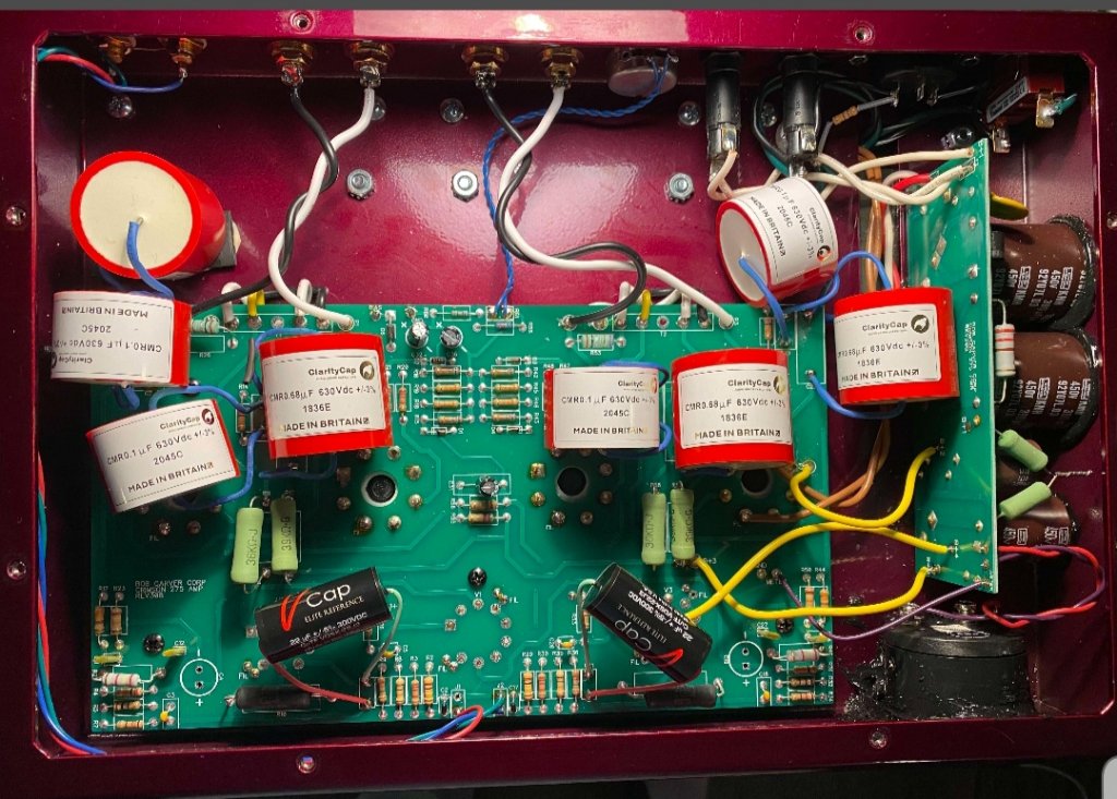

Yes.  The noise was from the transformer but it wasnt the transformer that was bad.  Bob Carver knew how to design a transformer.  After all, he learned from David Hafler so many years ago.
BTW..... I've modded the Carver just about a month ago.  (Kudos to jbhiller for the design idea and photos.  I actually used Mundorf caps but I'll be damned if i can find the photos.).  I changed out 10 caps and 4 resistors and really made a nice upgrade.  Mostly in the depth.  But also it just has a more pleasant midrange and bass.  The Klipsh speakers with the crossover mods and damping the speakers, (courtesy of Don Sachs' idea and design), and the Carver amp are a real great combo.  I swore I would never own a box speaker again but those things changed my mind.
