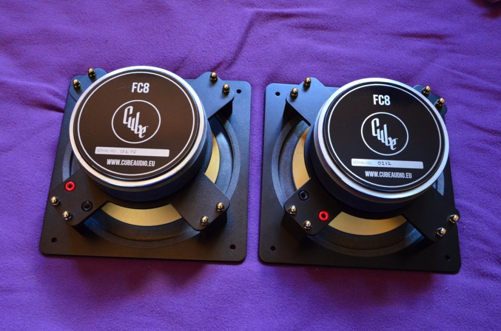

Just arrived and really looking the part. The last full range drivers I owned were Lowther DX4s - these look in a different league. Engineering and finish is superb.
Will try to get them connected this afternoon.

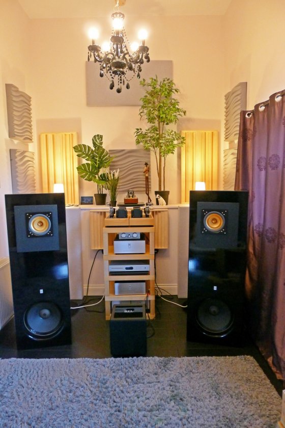

Now mounted in my baffles.  Its nice to chat. :)

I am still in the installation phase, but hope to bring the 15" drivers up to just kiss the FC8s. My starting point will be 300Hz using a second order Butterworth low pass of quality single inductor and capacitor.
Until then I am quite happy to run the FC8s as full range drivers.

Still by far and away the best 8 inch drivers I have experienced. The added benefit is that the high frequencies are fully taken care of so no need for tweeters and high frequency crossovers. I run the FC8 full range - no crossovers, notch filters etc to degrade the sound. It reaches happily to about 200Hz in my baffles and the whizzer cones are 'invisible' unlike Lowthers (even rolled cones)
Aside from sounding real, the sound stage is very big, sometimes instrumentalists are standing beside me - its a bit unnerving at times.
Also I have recently added a First Watt B1 no gain pre amp into the mix to replace a top quality ladder passive volume control. I like it a lot. I have also upgraded the digital cable to great affect.
I continue to play with the 15" driver.
