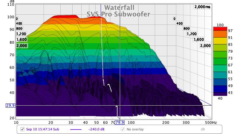

The usable ProAc Tablette 10 Signature bass response ends at circa 50 Hz, and I felt the need to extend the available bass below that range by adding a single SVS Pro subwoofer. The overall frequency response for ProAc Bass/Middle, the ProAc Tweeter and the SVS Pro Subwoofer is shown below. You might like to compare this graph with the one shown in my blog from 22.Sep. 2021. All measurements are taken at very close range with REW and miniDSP UMIK-1 calibrated USB measurement mic:
The SVS Pro subwoofer has a wide adjustable range (by smartphone App and at the rear panel) of volume, phase, polarity, parametric equaliser and crossover adjustments, of which I only used volume and Crossover point adjustments with the above result. By including this subwoofer, the improvement is impressive, positively affecting the overall tone and the lower frequency response. Boosting bass is a feature enjoyed by many, but walks a thin line to becoming unpleasant due to the potential for room resonances and 2nd / 5th order harmonics peaking, i.e. coloration. I set the SVS Pro sub woofer crossover frequency to 80 Hz, and will probably go even 10 Hz lower to 70 Hz to reduce room resonances.

SVS Pro Sub Woofer Waterfall alone (without Bass/Middle and Tweeter):
