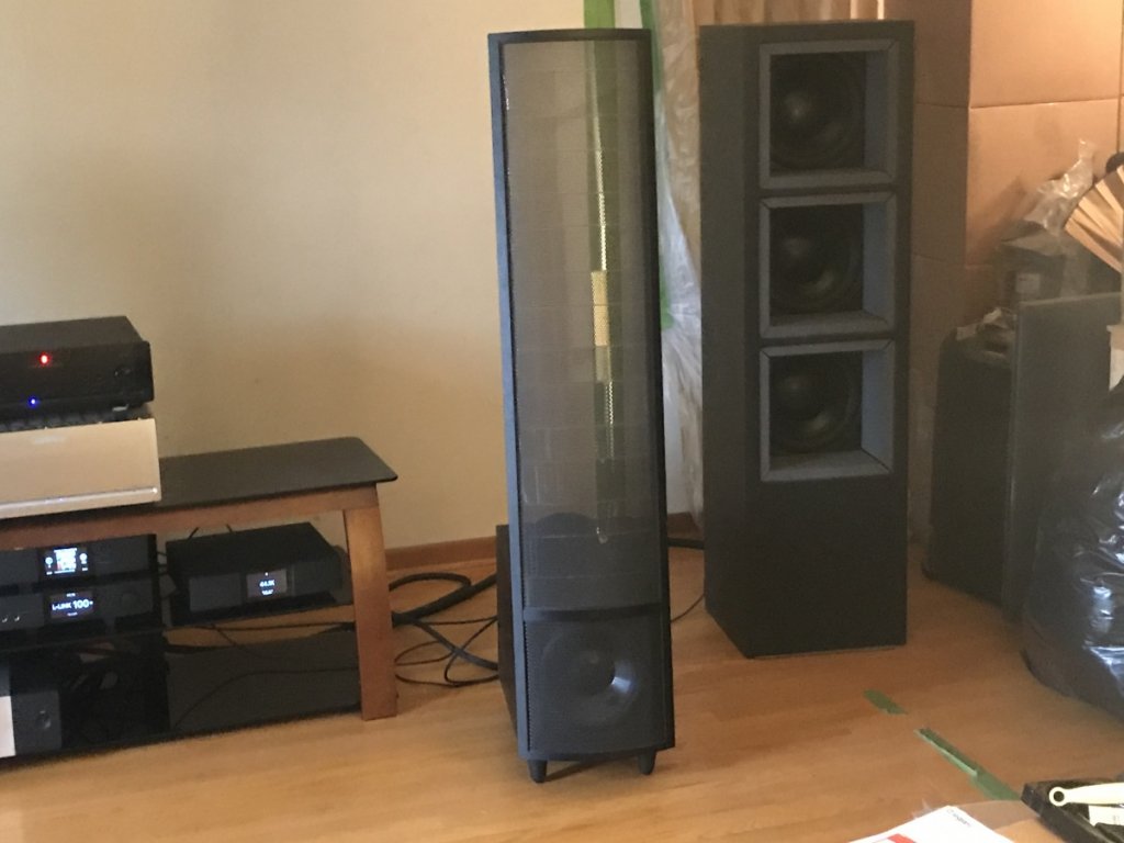

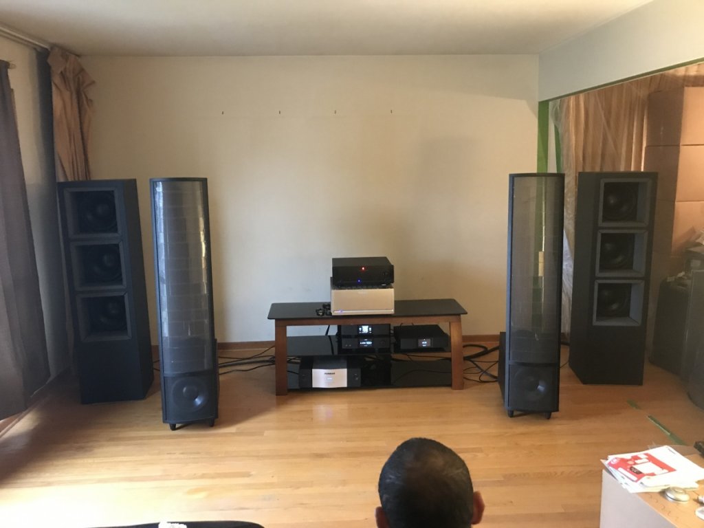

You might want to consider triples instead of duals. They take up the same floor space, have better performance, and will visually match Maggies better. If you go with duals, be sure and use the 16 ohm drivers. That way if you want to add a 3rd driver down the road it is easy to do.
Here are some pics of a pair of triples I built for a client in Chicago paired with his Martin Logan Summit X speakers.
These are actually taller than triples normally are. This is because the amps have been built into the cabinets under the bottom driver. I'd stick with the amps in separate boxes behind the subs. Much easier to build and handle.
