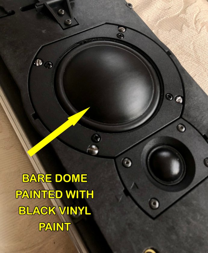

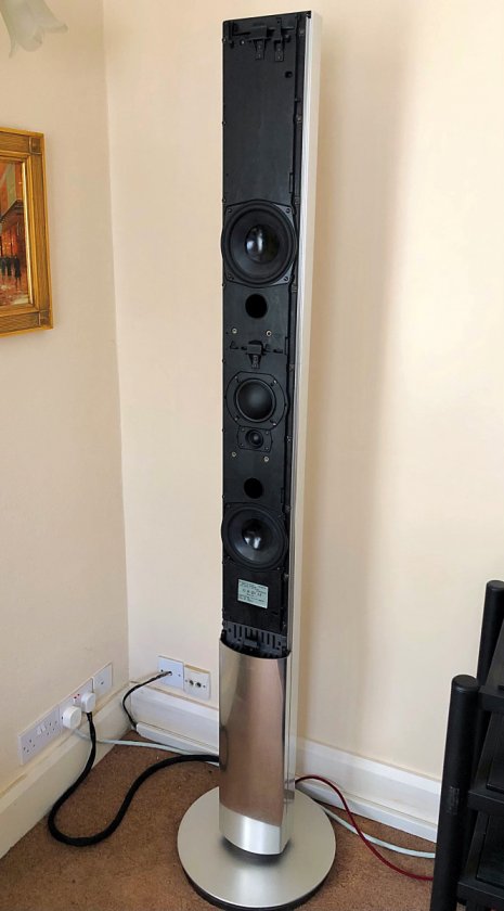

Here’s what I did with the midrange driver after removing the pointless grill that covered it…

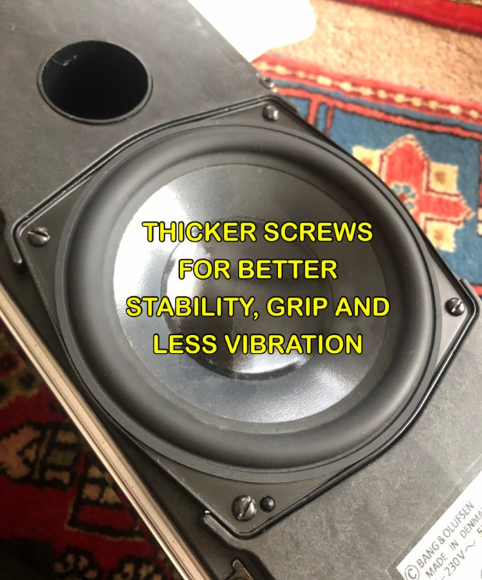

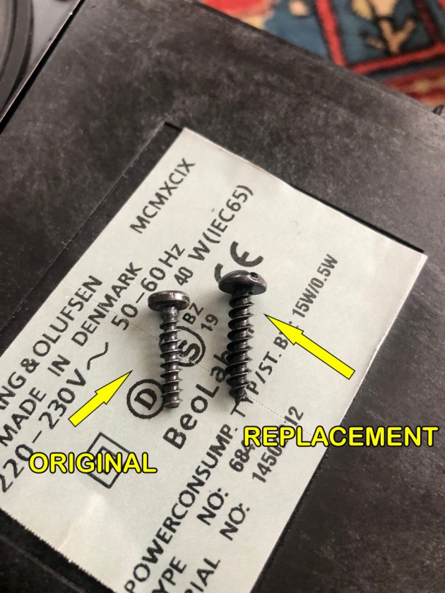

Below shows the improved/thicker screws for the woofers. To accommodate them, I had to drill the cabinet holes slightly bigger…

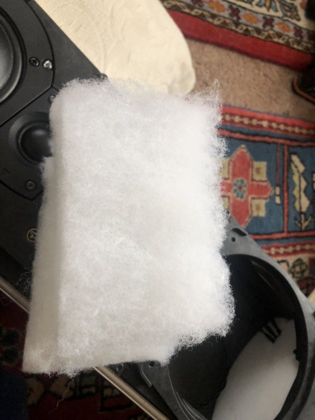

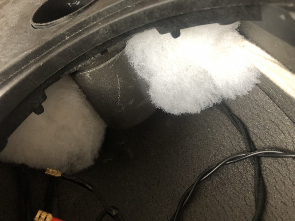

Here is some acoustic wadding that I installed around the bass reflex port. This helps to guide/direct the emanating  waves from the woofer through the reflex tube itself ((ESSENTIAL TO BOOST BASS RESPONSE))…

These are my last speakers…
They look great. It seems like it’s not a heavy speaker. Was wondering if you felt the round  base was appropriate/sufficient.
They are very heavy. I struggle to lift just one of them, and I’m a strong guy. The round base is large enough to keep them relatively stable, however they do not have the provision to accommodate thick power cords or interconnects. So to solve this problem I created a solid steel platform for the speaker base to sit on top of, which has a canal cut out, to fit those cables in. This platform also provides the Beolab 1 with a proper foundation which helps to solidify the bass quality.
