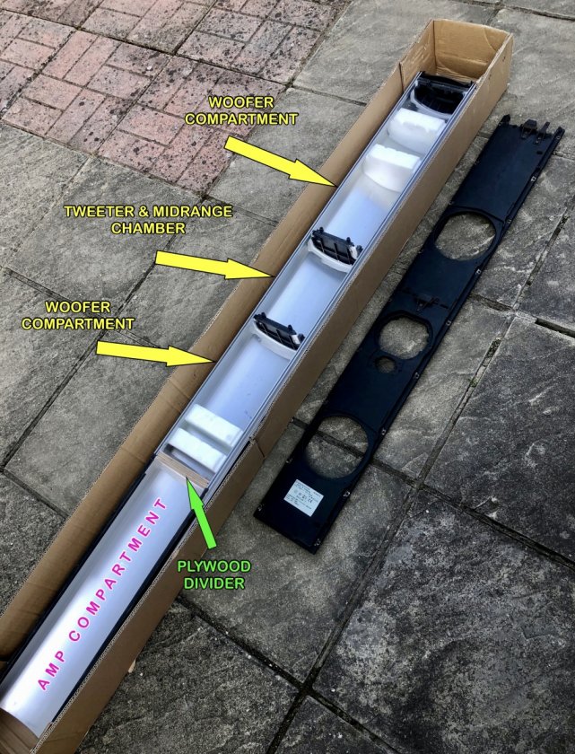

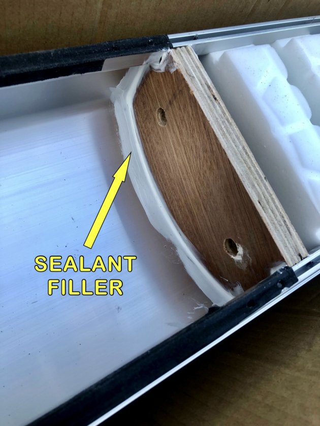

I rearranged both plastic dividers, and also added a plywood divider…
I also put a thick layer of outdoor filler over the top of the sealant.

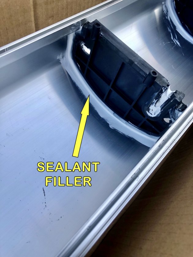

Looking very good. Great job with the sealant. Better compared to original, no more airleaks :wink:
Looks a bit messy but does the job.

Agreed. One of the biggest problems with the unmodified Beolab 1 is that the cabinet is underdamped and also ‘without solid internal bracing’. None of the internal brackets are properly secured in place. The only thing holding them in place is the rubber seals; which is ridiculous, and also contributes to cabinet rattle at high volume levels. It is no wonder that the sound falls apart during loud music passages. By the way I have put a thick layer of Outdoor Filler over the top of the Sealant to add extra stiffness.

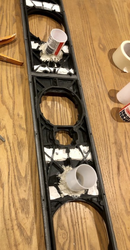

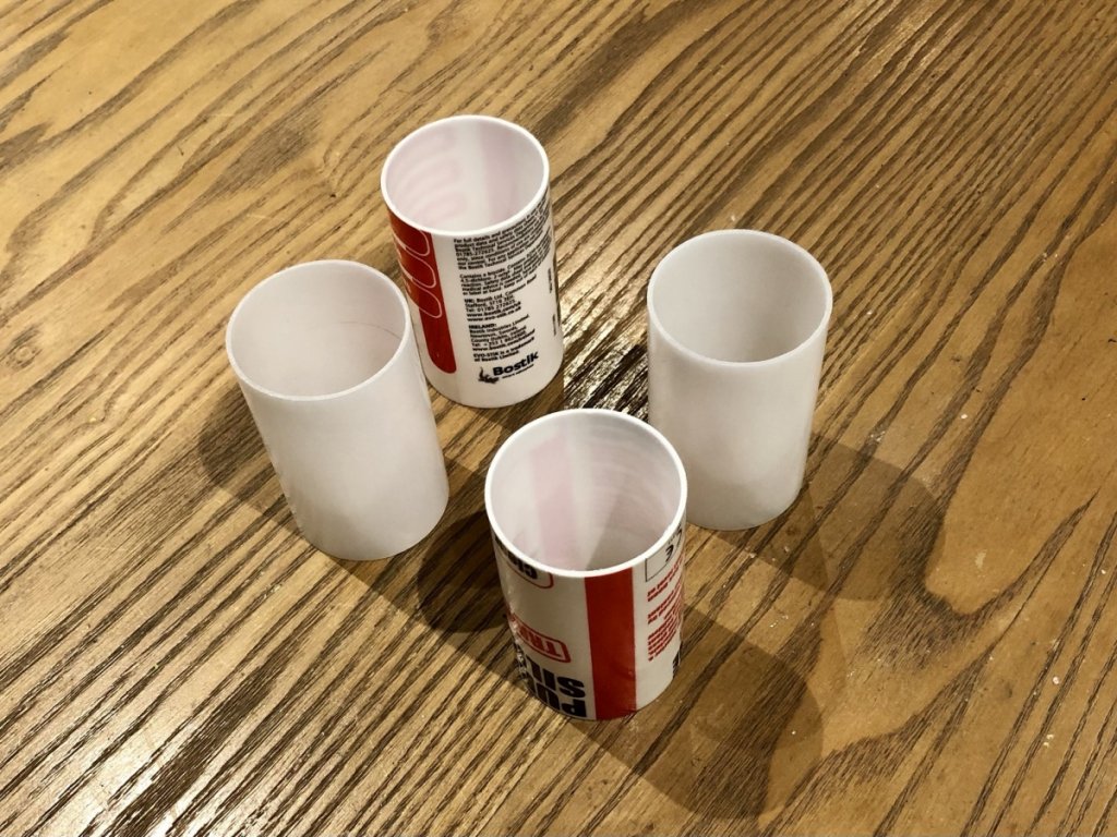

Here are the DIY Bass Reflex Ports that I created from disused glue/filler tubes, which have been cut to the correct sizes. BELOW ARE THE INNER DIMENSIONS OF THE INDIVIDUAL TUBES:-
4.5cm wide
8cm long
« Last Edit: 16 May 2025, 10:42 pm by OSIB16 »
OSIB16
  • Posts: 390
Re: BANG & OLUFSEN SPEAKERS OVERHAUL ((THE MIGHTY BEOLAB 1))
« Reply #26 on: 1 Oct 2021, 07:42 pm »
Here are the Bass Reflex Ports that I made out of old glue/filler tubes, which have been cut into the correct lengths…
OSIB16
  • Posts: 390
« Reply #27 on: 1 Oct 2021, 07:45 pm »

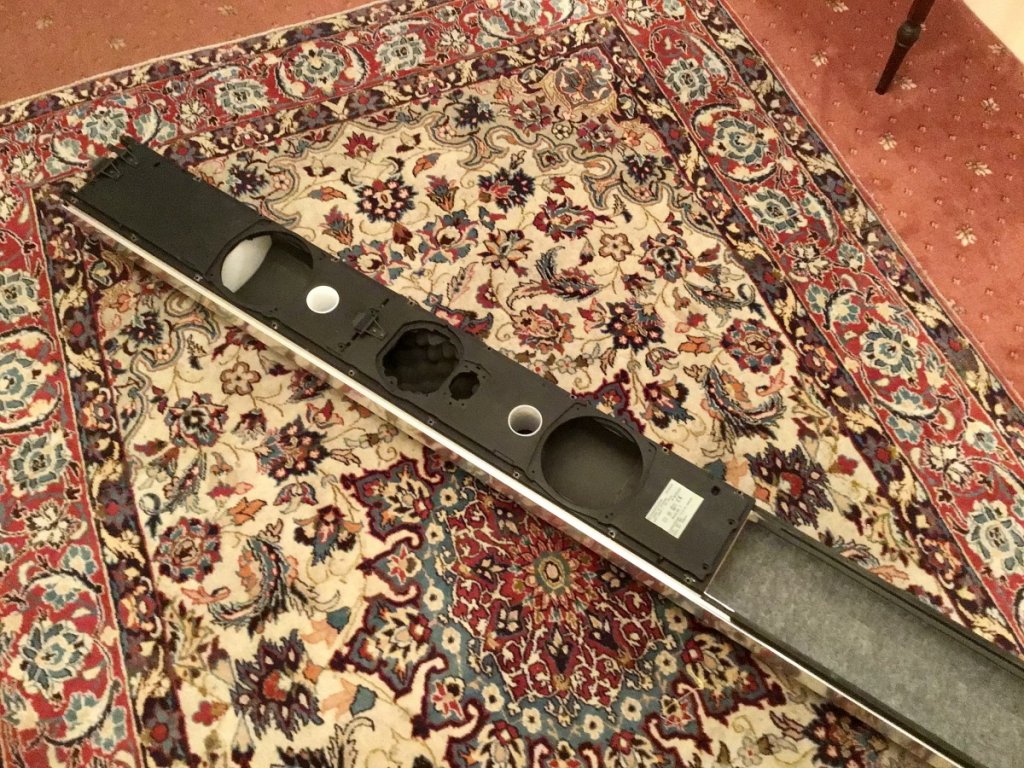

Fitted into holes that I cut into the speaker baffle. I also smothered a thick layer of glue around the base of each tube, to add increased strength and stability…

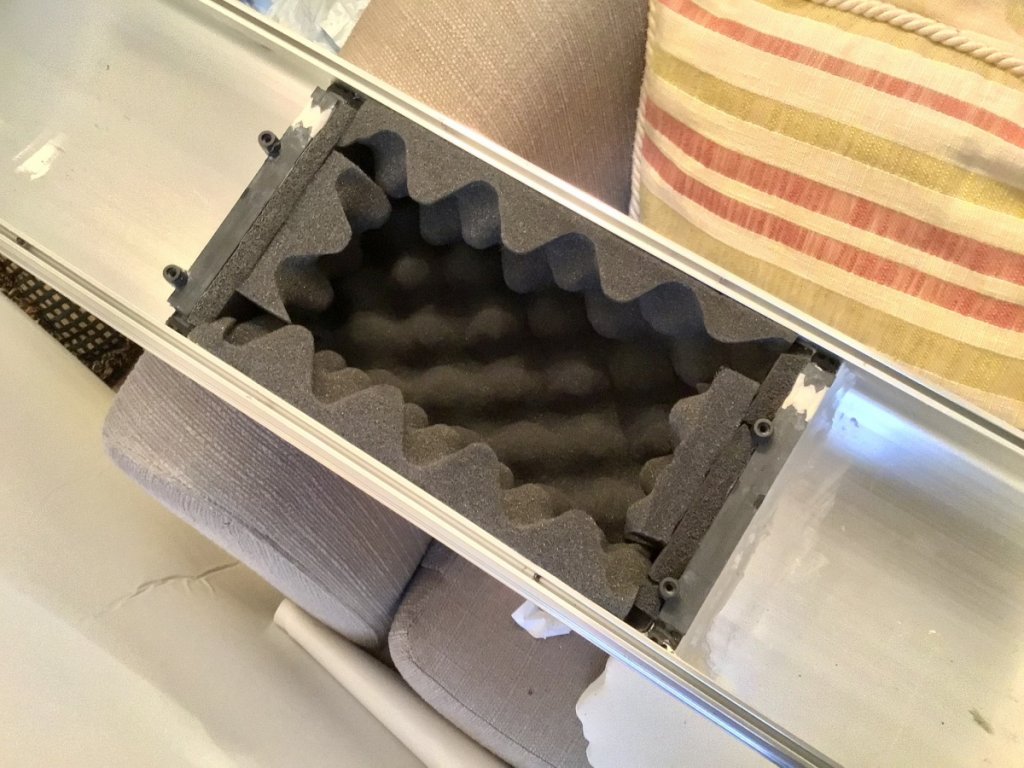

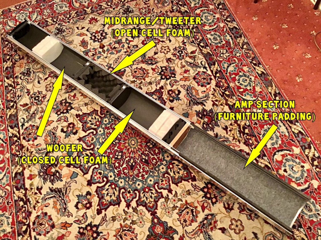

The treble/midrange chamber damping. Two layers of open cell foam…

« Reply #29 on: 2 Oct 2021, 07:02 pm »
OSIB16

With the front baffle fitted…

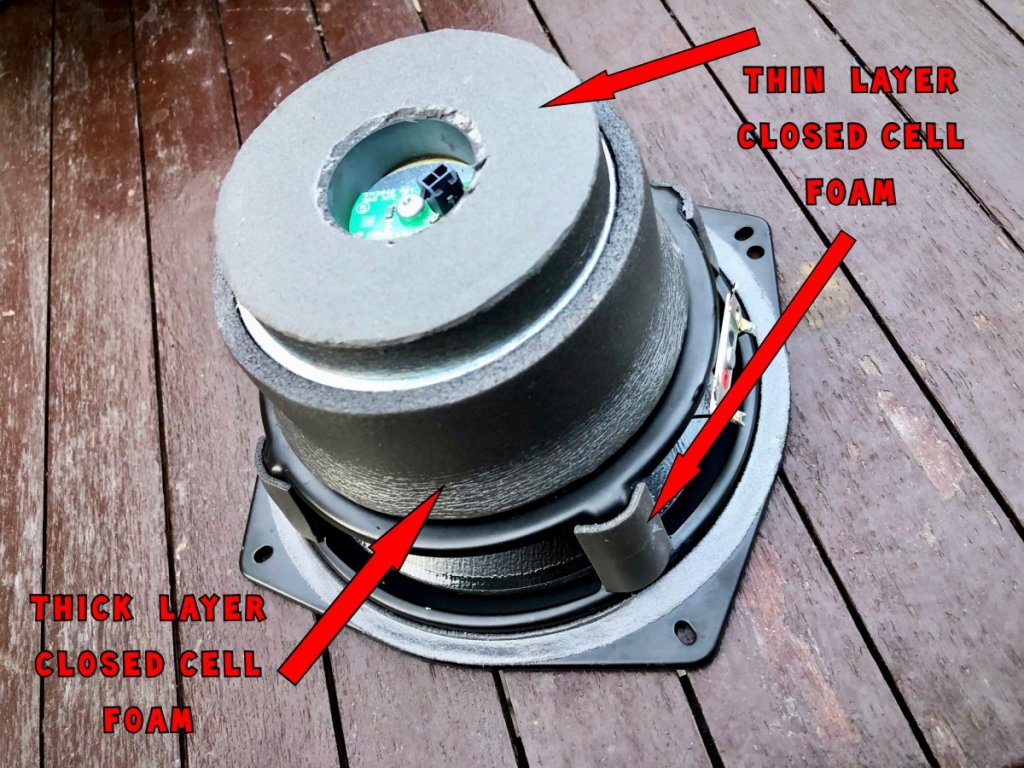

Why would you put closed cell foam in the woofer compartment?

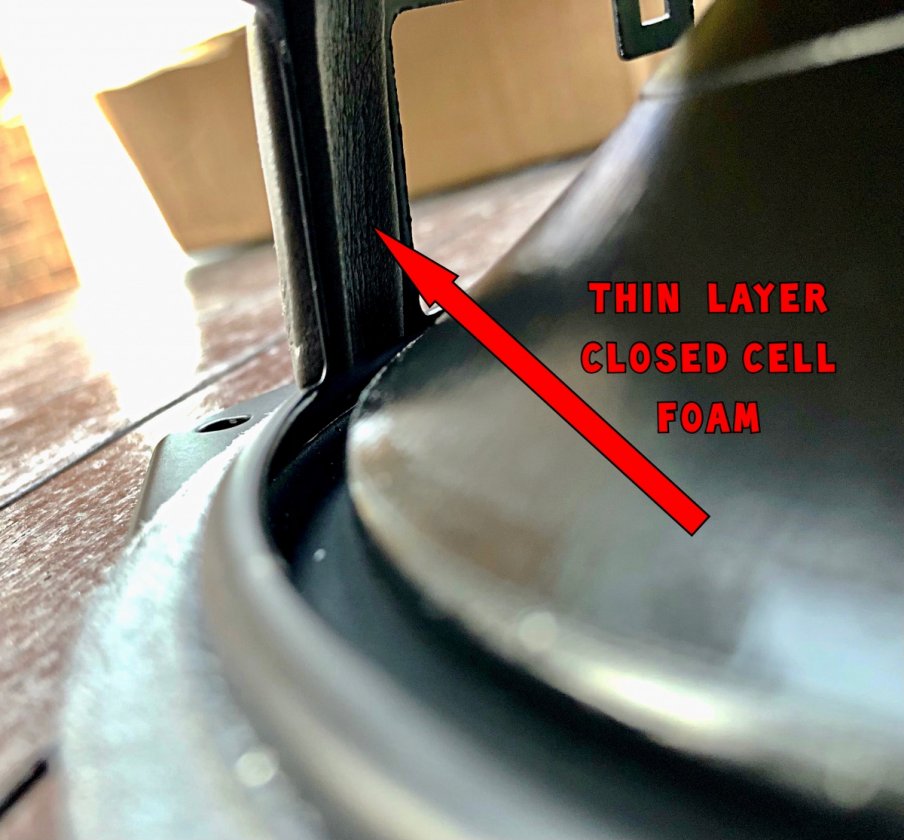

Because I was advised to do so by an engineer at Kef Audio UK. So I have used a thin layer of it (4mm) inside the woofer compartments. Here is what I understood from the conversation that I had with him…
Bass waves are absorbed by ‘Open Cell Foam’ (which is a bad thing!). Instead you should use ‘Closed Cell Foam’ which does not absorb bass waves, but instead redirects them. However, even though a thin layer of Closed Cell Foam does slightly reduce the space/volume inside the cabinet, it does still have some ability to absorb/muffle any stray midrange information coming out of the rear side of the woofer.
SClark please give me your opinion.
« Last Edit: 18 Jul 2023, 07:37 pm by OSIB16 »

5mm and 2mm thick damping added to the rear and sides of the woofer basket…
« Last Edit: 15 Oct 2021, 01:47 am by OSIB16 »

2mm thick damping added to the interior of the woofer basket (reduces any ringing vibrations)…

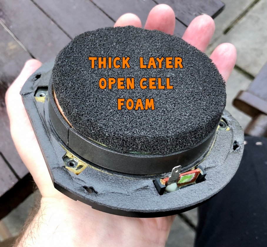

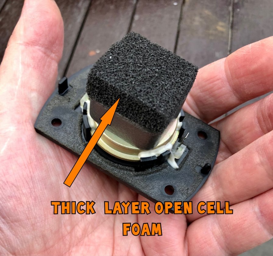

10mm thick damping added to the rear of the midrange unit…
OSIB16
  • Posts: 390
« Reply #36 on: 15 Oct 2021, 12:28 am »
10mm thick damping added to rear of tweeter…

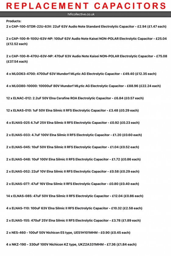

Below is my list of capacitors that I purchased to replace the originals. Basically I’m using Mundorf Mlytic AG for the the large caps, and Audio Note Kaisei/Standard for medium caps and bipolars, with Nichicon KZ. As for the small caps; I’m using mostly Elna Silmic II with Elna Cerafine.
Total is £357
