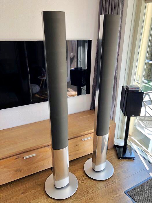

 Ok so as some of you on here know; I am a big fan of modifying Bang & Olufsen hifi equipment ((YEARS 1999-2005)). My latest project is a dream come true for myself. I’m currently working on the largest ‘Active Speakers’ that Bang & Olufsen has ever produced to date; the Beolab 1’s. These things are huge aluminium beasts. Very imposing, standing at 6FT 2 and weighing 36KG each!! These examples from 1999 are in ‘New Condition’. Was lucky to find them.
My plan is to perform the world’s most extensive modifications to this particular model. The information and knowledge gathered here in this thread, is free for all B&O Beolab 1 enthusiasts who wish to prolong and maintain this legendary speaker, for the future generations to experience and enjoy.
These modifications will provide you with the very best upgrade possible, all tried and tested. The sound quality will reach new searing heights, essentially supercharging the performance of these timeless gems.
I will now guide you through the various stages…

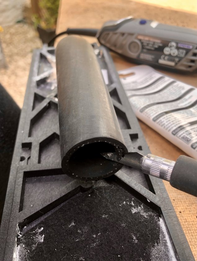

5) CREATE SEPARATE COMPARTMENTS INSIDE THE SPEAKER TO ISOLATE THE MIDRANGE & TWEETER FROM THE WOOFERS.
6) ADD BASS REFLEX PORTS TO THE WOOFER COMPARTMENTS (INCREASES POWER HANDLING).

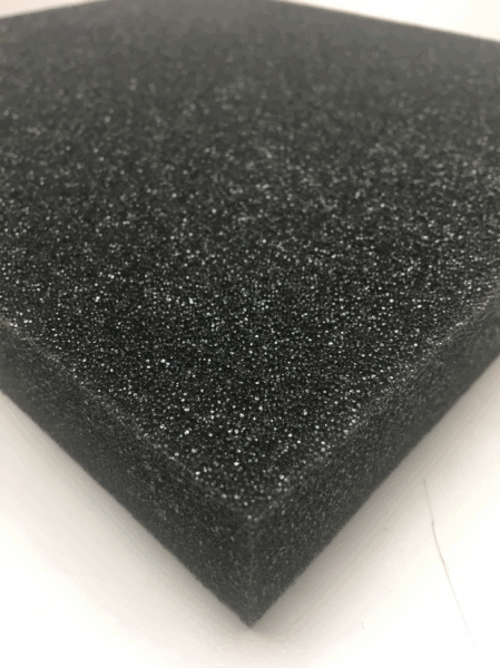

8) ADD PROPER DAMPING MATERIAL TO INTERIOR OF SPEAKER CABINET ((OPEN CELL FOAM FOR TREBLE/MID CHAMBER. CLOSED CELL FOAM FOR WOOFER CHAMBERS)).

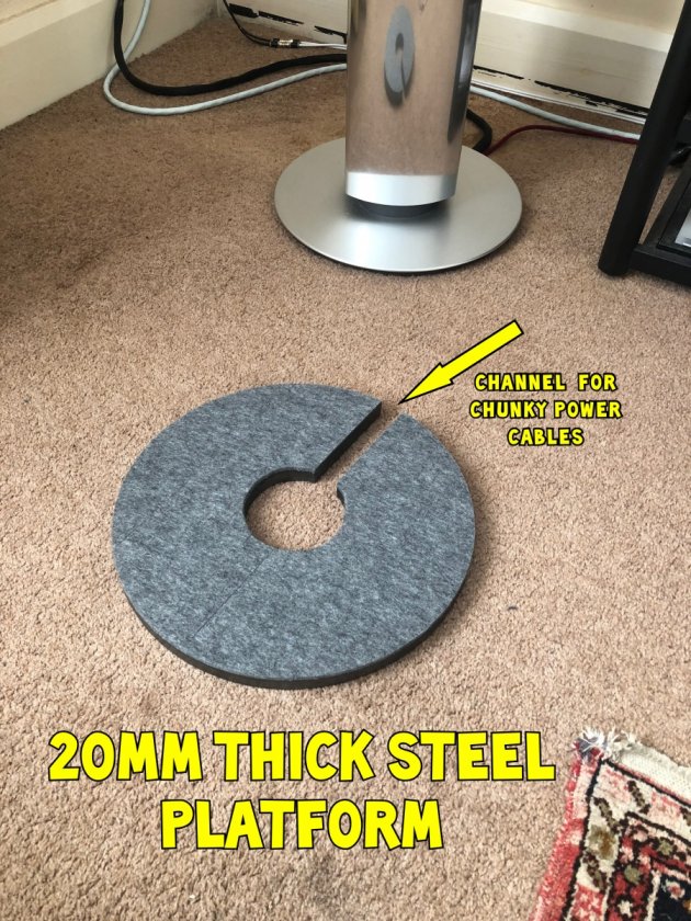

9) CREATE HEAVY DISC SHAPED STEEL PLATFORMS, FOR USE UNDER THE SPEAKER (IMPROVING BASS, AND ALLOWING FOR THE ACCOMMODATION OF CHUNKY POWER CABLES & INTERCONNECTS).

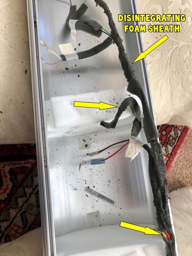

After opening up the cabinets I have found that the existing internal wiring is covered with a protective foam sheath, which is disintegrating/falling to pieces and also melting onto an area of the circuit board which it is resting against. Cleaned off the foam residue with white spirits. Looks like I got there just in the nick of time, before a short circuit or fire takes place!
« Last Edit: 18 Jul 2023, 07:45 pm by OSIB16 »

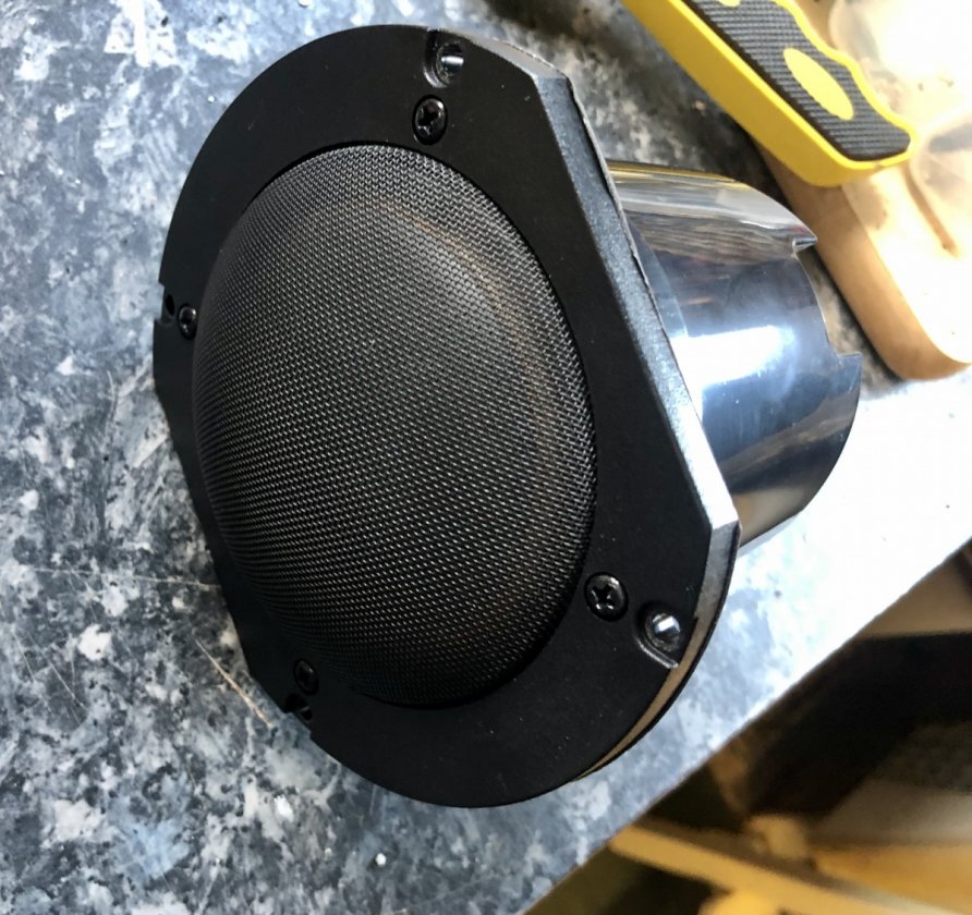

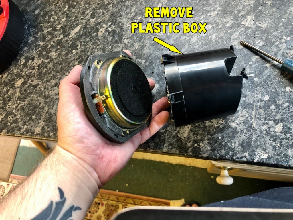

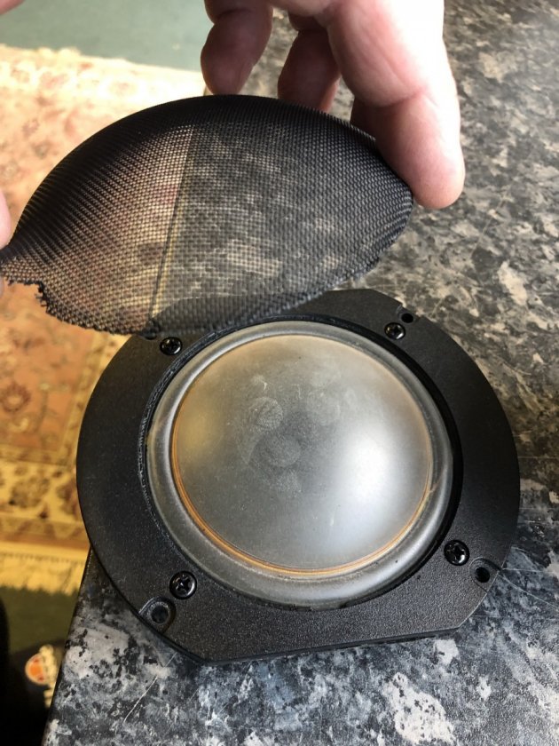

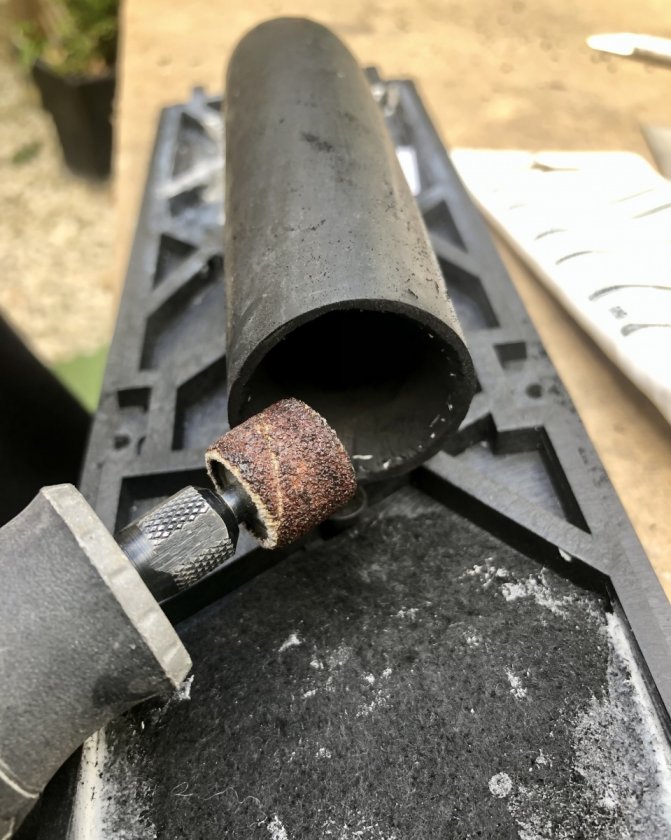

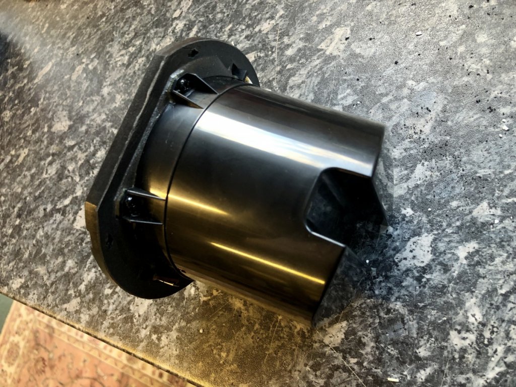

Modifications to the Midrange unit…

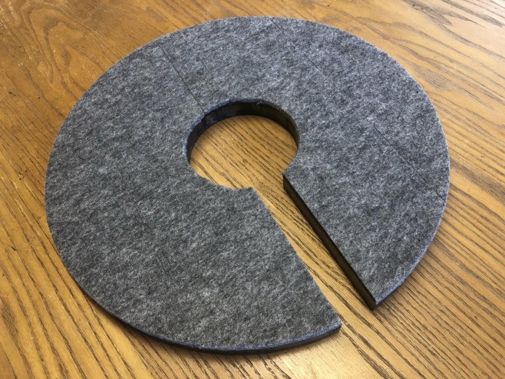

Very heavy Steel isolation platforms, with a layer of furniture padding fabric installed on top (prevents scratches to the underside of the speakers when sitting on them).
« Last Edit: 30 May 2022, 02:44 pm by OSIB16 »

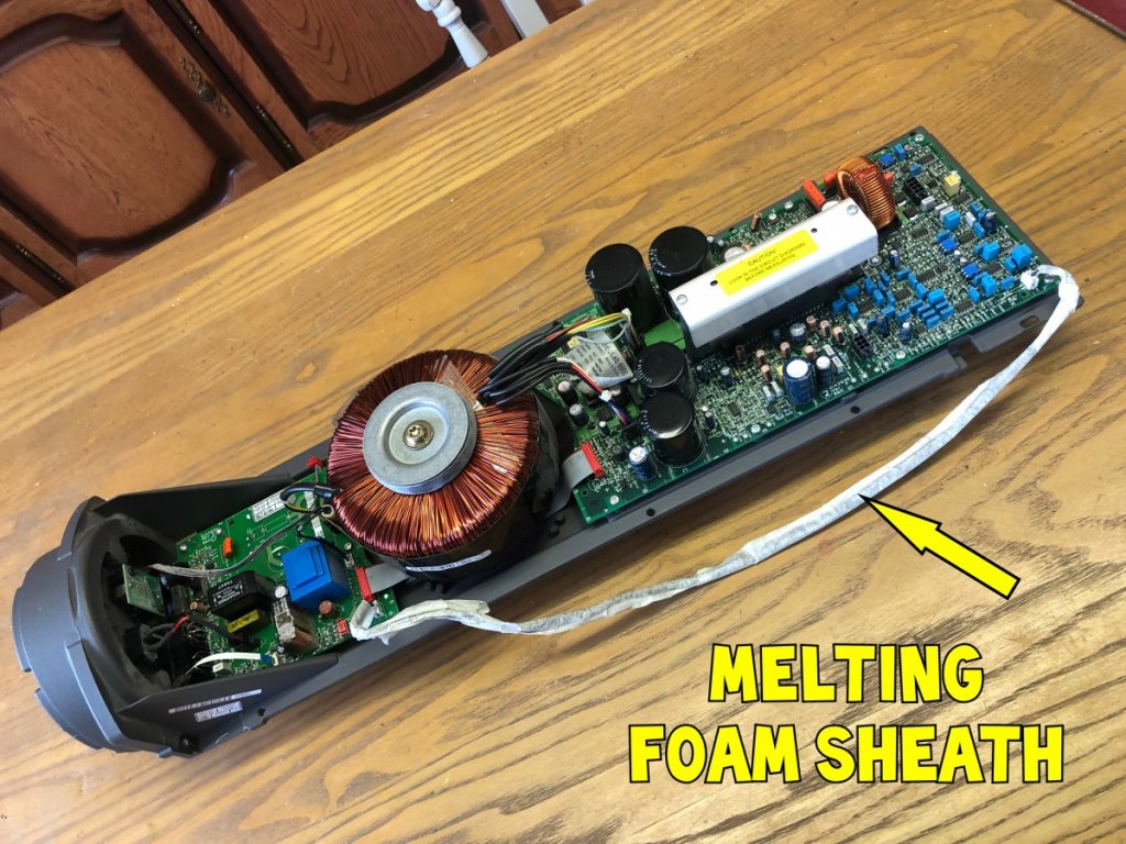

Below is image showing the original jumper cable which I covered with masking tape to stop the melting foam mess from getting onto my hands. I will replace this entirely.
« Last Edit: 18 Jul 2023, 07:48 pm by OSIB16 »

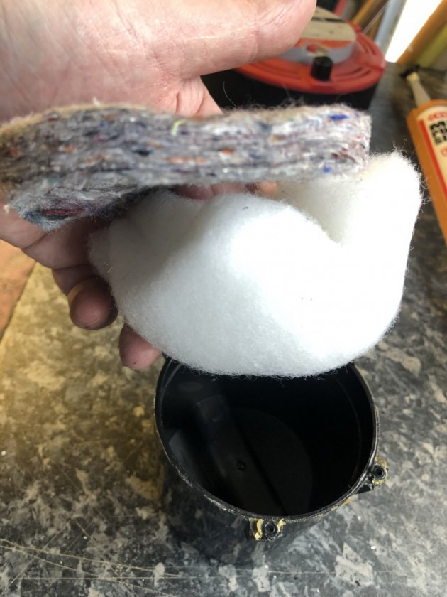

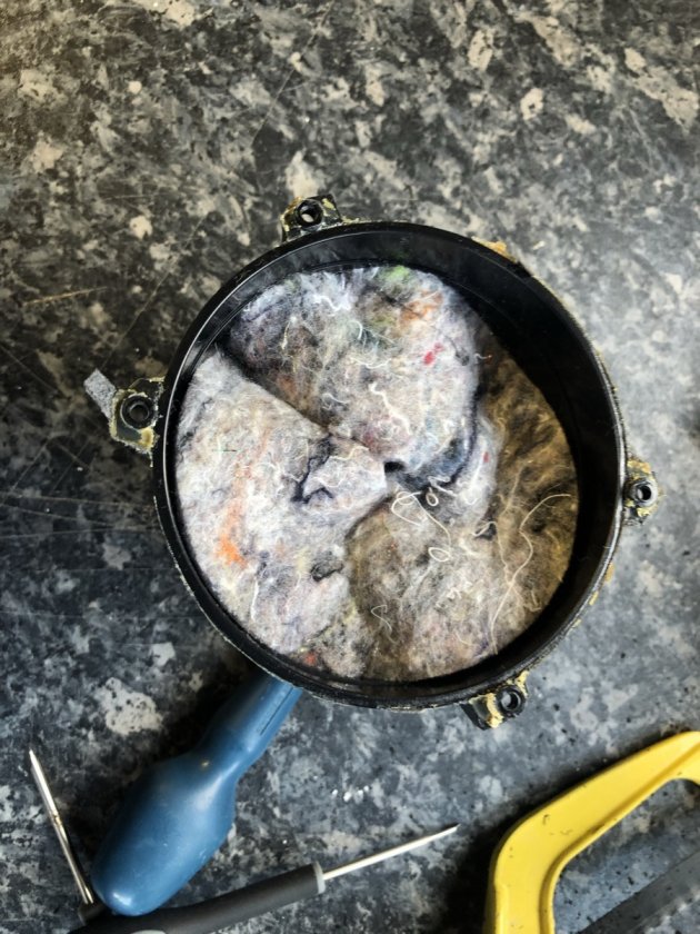

I have spoken to a guy who works for KEF AUDIO here in the UK, and he advised me how to correctly use speaker damping materials for the best effect. He explained that Open Cell Foam is ideal for use behind Midrange and Treble Units to absorb any ‘Standing Waves’. So I’m gonna use this Open Cell foam (pictured below) to line the walls of the Treble/Midrange chamber (one layer of bobbled over the top of flat sheet).
« Last Edit: 30 May 2022, 03:01 pm by OSIB16 »
OSIB16
  • Posts: 390
Re: BANG & OLUFSEN SPEAKERS OVERHAUL ((THE MIGHTY BEOLAB 1))
« Reply #10 on: 25 Aug 2021, 03:35 pm »
He also warned me that I shouldn’t use Open Cell Foam behind woofers; so as not to absorb any low frequency energy emanating from it, which will ruin the bass response. So I’m using this Closed Cell foam (shown below) which will be installed into the bass/woofer chambers of my Beolab 1’s. It should absorb any stray midrange frequencies coming off the back of the woofers.
« Last Edit: 18 Jul 2023, 07:50 pm by OSIB16 »

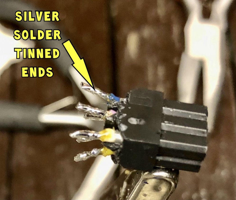

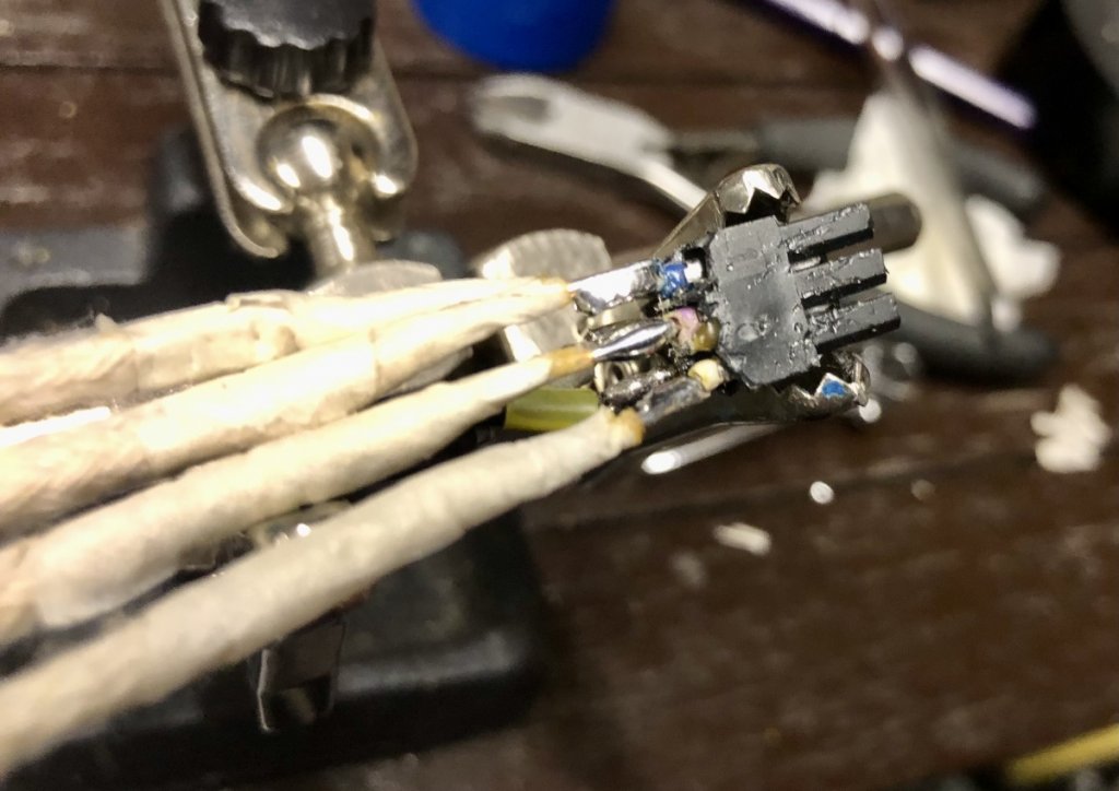

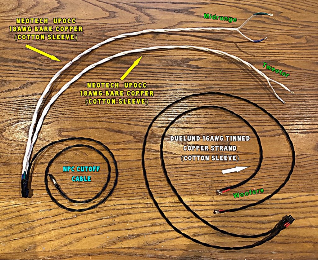

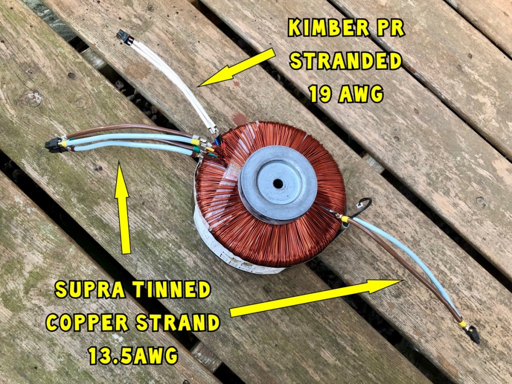

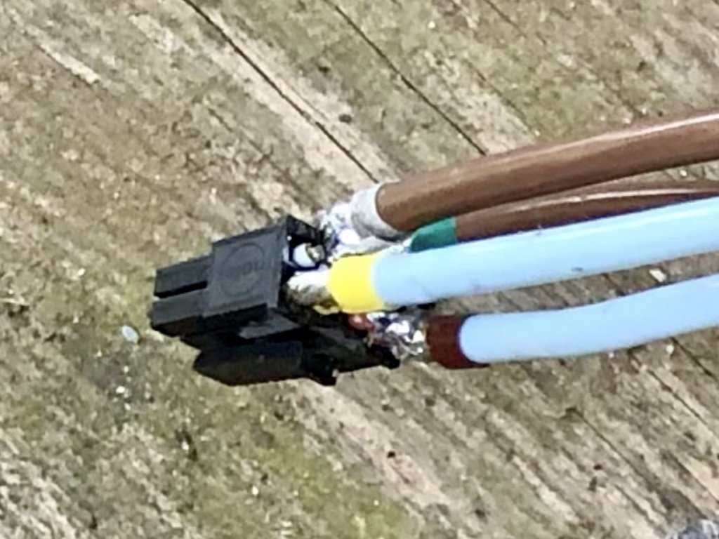

Just finished replacing the transformer jumper wires to 99.999% purity copper. I used Supra tinned strand on the input and some of the output to add some much needed necessary warmth to the overall sound. I also simplified the wiring design layout for the output signal by soldering together some of the connector/plug pins, which allowed me to use 4 wires instead of 8. Much simpler. Less wire clutter; to help reduce distortion.
« Last Edit: 22 Oct 2022, 11:11 pm by OSIB16 »
OSIB16
  • Posts: 390
« Reply #12 on: 31 Aug 2021, 05:48 pm »
New leads hardwired in place of the original weedy junk wire. I snipped off the wire as close as possible to the connectors plugs, then soldered the replacement Kimber and Supra wire in place…
« Last Edit: 25 Oct 2021, 09:13 pm by OSIB16 »

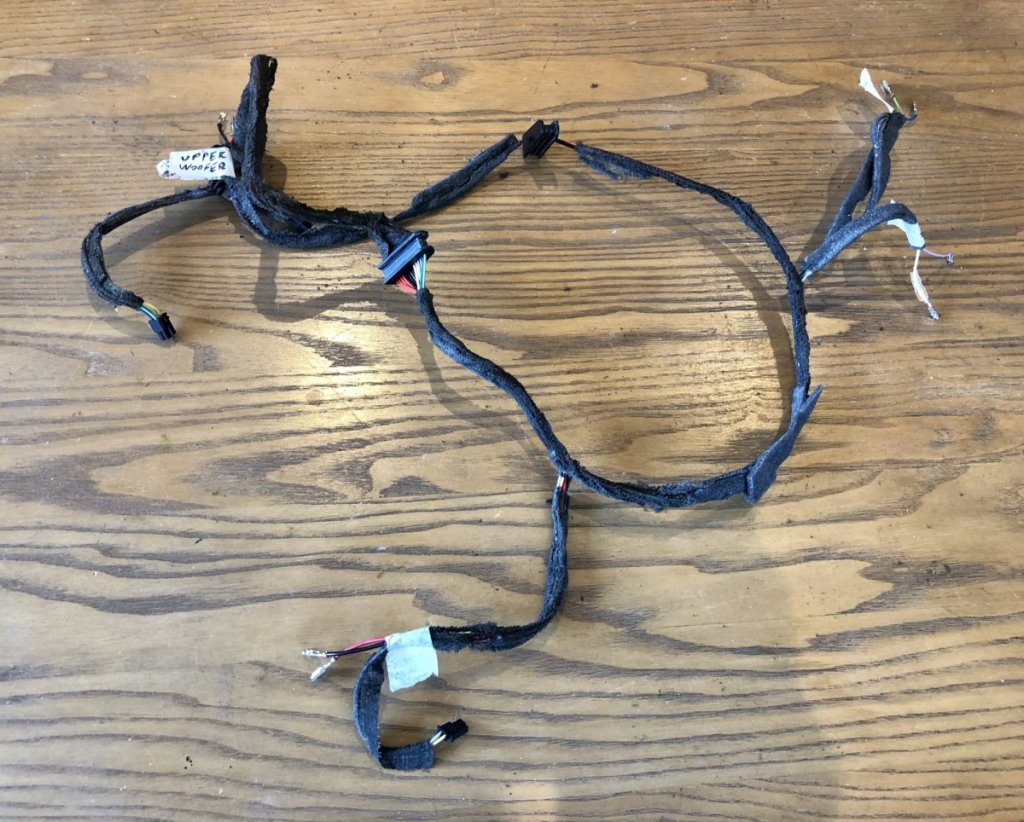

Here is the original jumper wire for the tweeter, midrange and woofers. What a spaghetti mess!! Looks like it was put together by a team of chimpanzees. :lol:
« Last Edit: 18 Jul 2023, 07:54 pm by OSIB16 »
OSIB16
  • Posts: 390
« Reply #14 on: 12 Sep 2021, 09:50 pm »
Here is the new simplified/upgraded wiring that I put together. I purposely use 18 Gauge solid core for tweeter, to help round off the edgy treble of Beolab 1…
« Last Edit: 20 Jul 2025, 02:36 pm by OSIB16 »
