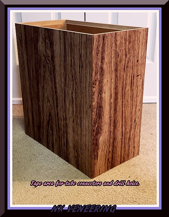

Partially veneered, still have the top to complete.
« Last Edit: 11 Apr 2023, 11:26 pm by NXSTUDIO-DRUMMER »

Hondurous Rosewood veneer applied to cabinet.
