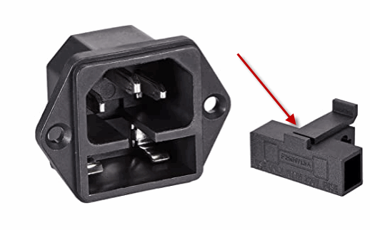

Thanks Klaus. Now I can see the fuse holder.
I am not sure how to remove the fuse holder and afraid that I damage it with the screw driver. I search the internet and found only video of inserting the holder back in. No video of pulling the holder out.
Please correct my understanding if I am wrong:
Insert flat screw driver to the gap shown in the picture. Apply sideway force to 'slide' out the fuse holder like opening a cabinet drawer.
klaus@odyssey
Re: Stratos Mono not working
« Reply #3 on: 31 Jul 2021, 07:50 pm »
Yes...it's a standard fused IEC  connector...the pics are correct

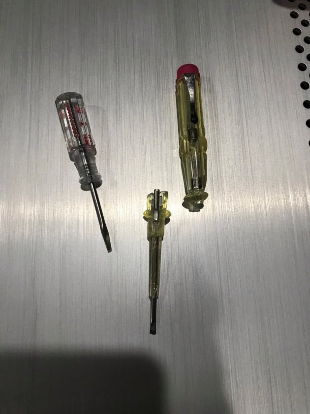

I finally removed the fuse. The 'active' white fuse shows no continuity when tested with multimeter.
Now I use the glass type spare fuse as the main fuse and one of the extra white fuse you gave me as spare fuse.
I now realized that the extra fuse I got from you are external fuse.
I need to apply force to remove the fuse holder while at the same time do not want to damage the plastic.
One of my screwdriver actually broke into two.

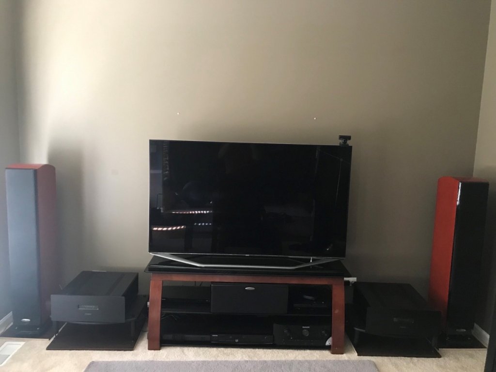

Right now I just wanted to test to ensure that the old Infinity towers are working. Some of the wires I use are cheap Monoprice wires that I temporary borrow from my home theater system that is still work-in-progress.
Even with cheap interconnects the sound of the Odyssey monos running the Infinity Mid/High towers are smooth and sweet.
The OPPO 205 player is connected directly to the Infinity passive crossover with no Preamp. I tested up to volume 70 (out of 100) and the Odyssey monos show no sound distortion.
I also have a secondary system with Odyssey Extreme for Polk Lsi 705 speakers.
