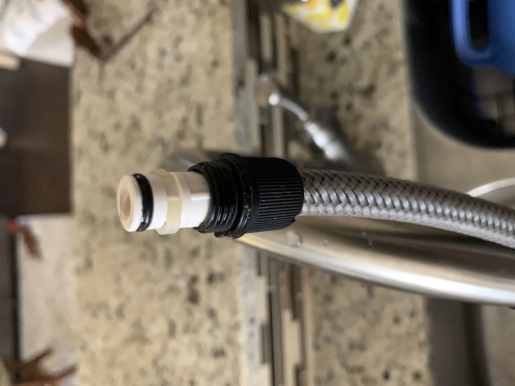

I have to go from this to garden hose.
The threads are 3/8 FIP.
A few places have been able to produce a combo that would almost work except there’s no way to see if the end would actually cram in, and if it goes poorly I need a replacement. I have to imagine there is an easier way to so this than attaching a lightsaber to it. And maybe one that doesn’t leak or ruin it.
I have shit for options. The tub/shower switch is at the end, and there’s no way on earth I’m kneeling to work in the tube. The bathroom faucet has 0 threads. There is no utility sink.
Either I find a way to adapt or I have to replace the fixture with something extremely similar aesthetically.

Is the white piece integral to the other and not detachable?
Is it a 3/8 hose inside the stainless sleeve? You could connect a ferrule fitting onto the hose directly and then have all kinds of options.
Really, a garden hose? What size?

The white piece goes into the normal faucet.

Maybe if I find the name of the white part?
Screwing into threads is ok but the hose can go lower and spray out the top of the threads.

I grabbed a universal head. It can connect but the airator thing doesn’t come out for putting other things in…  fuckin trash. Maybe the 1/2 mystery threads can connect to something, we’ll see.

So the weird shitty aftermarket faucet connector allowed me to put a 3/4 inside diameter hose on it, then a barbed end to garden hose (two pieces). I think this will work for now incase the things I ordered are not what they say at all.

The 3/8" won't adapt properly to the o-ring part as far as I can tell.
