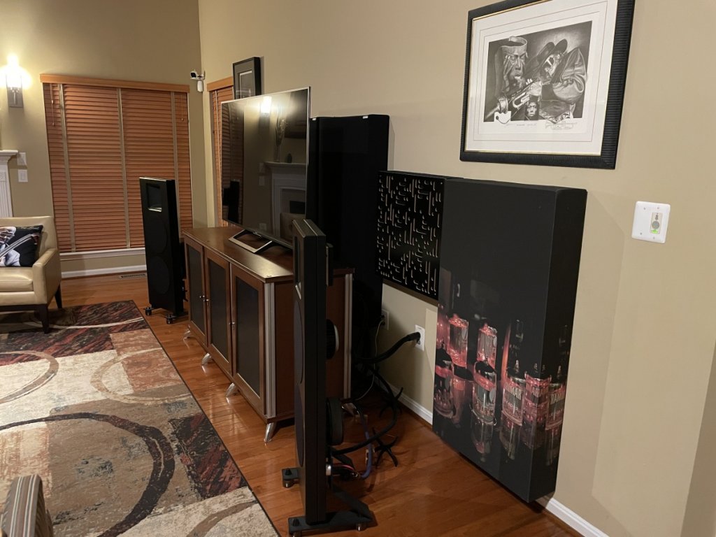

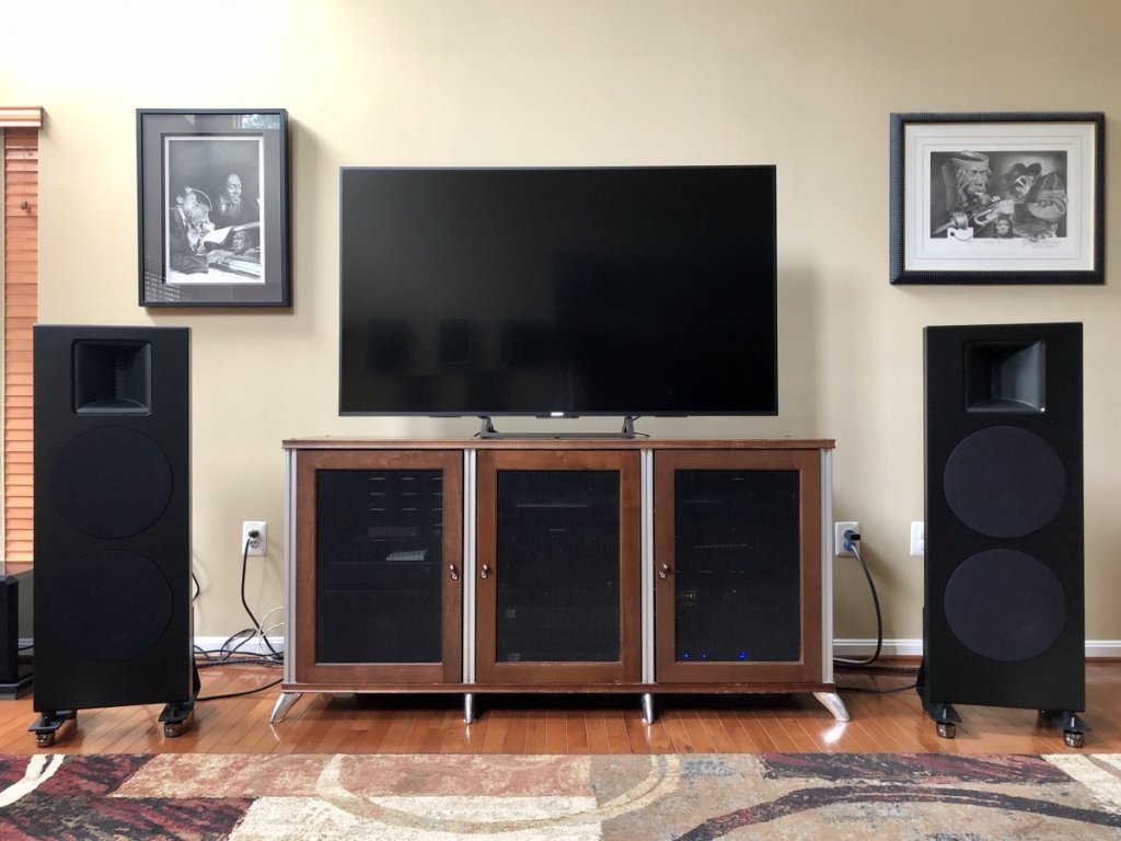

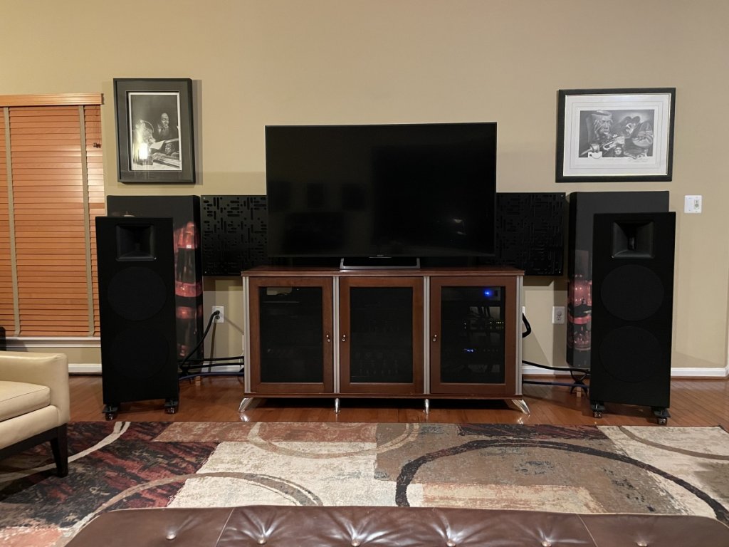

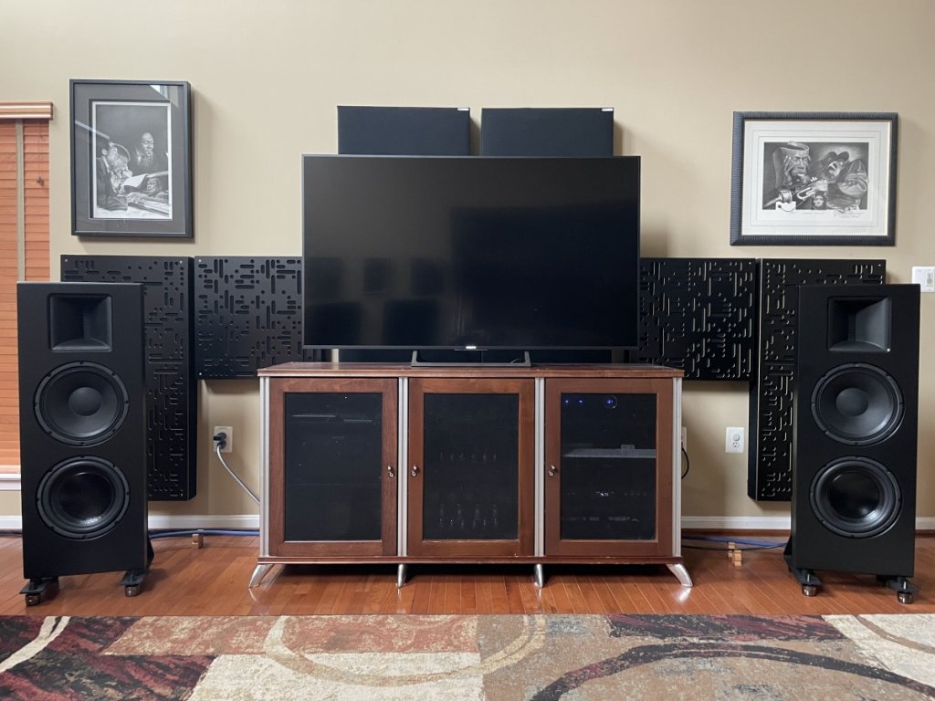

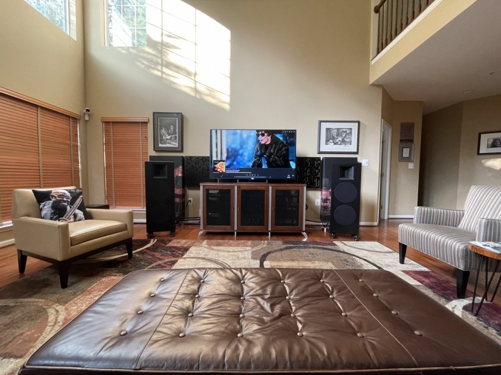

Greetings!
This is my first post on Audio Circle, so bare with me.  You guys have been a wealth of knowledge to me concerning just about every topic on the Spatial Audio M and X Series.  I owned a pair of Paradigm Signature 6 speakers for several years and I wanted to upgrade to something different that had excellent sound and they had to look good!  I have two family members that used to own B&W Matrix Series and they currently own a pair of Wilson Watt/Puppy 8S and Sabrina’s.  So, I know the B&W and Wilson sound pretty good.  I loved them all, but I just wanted to try something different.
In early 2020, I came across a few speaker forums on AudiogoN and open baffle design (OBD) speakers were mentioned.  I had never heard or seen a pair of OBD speakers like Spatial Audio.  I had only seen Martin Logan and Magnepan OBD.  The forums mentioned Spatial Audio and Pure Audio Project (PAP).  I found the Spatial Audio and PAP websites and starting researching and  finally spoke with Clayton and also Ze’ev from PAP.  Both of them were super nice and informative, but in the end, I ordered the Spatial Audio X5S in June 2020 and took delivery of them in September 2020.
Clayton advised me not to pursue instant gratification as the human instinct is hard to control.  Of course, I didn’t listen to him and was disappointed with the sound at first.  Clayton advised me to keep playing music and allow them to break in without concern for perfect placement.  I let them play and play and they finally started to sing!  I made a big mistake that I said i would never do, which is to buy all new components and cables within a few months, which left me unable to determine which upgrade was creating the weak link or strong link in the chain.  That being said, the system is smoking, but I still don’t always get the bass slam on certain tunes that I know well and have heard the bass as it should sound.  I listen to 90% traditional jazz and they do well when these tunes are in the signal path.  But, there are a few R&B, contemporary jazz and classical tunes that cause the plate amp to start clipping with the red light flashing when the bass digs deep.  My room is definitely a problem as it is a 17’x18’ square, 2-story family room that’s open to the kitchen and hallway area, with big windows covered by wooden blinds.  The room is terrible and very live.  I had no room treatments and Clayton advised me to add room treatments, which I did and that helped a lot.  Also, I was struggling with some vocals and brass that would get shouty and in your face, so when I turned it down to an acceptable level, the rest of the instruments were too low and it caused me to avoid playing a lot of tunes that I really like. So, I recently purchased an Audioquest Niagara 3000 with several Audioquest power cables and it lowered the noise floor which created a huge improvement by removing the harshness I was hearing.  Unbelievable!  Spatial Audio is the truth and Clayton has excellent customer service!  I will be finishing my basement sometime in 2022 and I will have a dedicated listening room, 14’x22’ with 8’ ceilings and no windows.
See photos below of how my current room setup evolved.

DBT, nice post. You really have a lot of issues with the room and s story with an open floor plan so you have a lot of music bouncing around all that open space. I am glad you upgraded your power cords, I use AQ Tornados on all my gear with the William tell speaker cables and fire interconnects. I went from Quads to the Sapphires M3's. Which was a huge change, speaker wires that worked so well with Quad speakers was a no go with the M3's, Quad our electrostatics so they have a different need in speakers cables they dynamic speakers, so I purchased some Analysis Plus Black Mesh Oval 9 and they transformed the speaker, now the speaker had weight and body without the forward highs, bass clean fast and detailed and now dynamic and deep, such so that I pulled the 2 subs I had at 1st. @nd thing was what Clayton told me, relax and let them break-in, that is hard when you're been listening to a speaker like he Quad for 10 years, and then putting a new speaker in its place and you expect it to sound great, well that was dumb of me.  For the past few months the speakers have settled in, and now daily consistent sound quality, I also learned about the speakers during those 8 months, moved them in out and wider, closer, apart, and then toe-in. Each room is different, my music room is a loft in my 2nd level which overlooks the family room below. So where I sit there is no wall behind me, just a rail. So the speaker faces no wall till 40' where the family room sidewall is.
Ideally you do not want anything between your speaker it kills imaging causes bounce off, and of course the perception of real people playing music in front of you, I only have my amp on its stand between my speakers. I put my stand there once it was a waster of an hour or so, 1st tune and got up shut the system down and removed the stand back to its old spot on the other side of the room away from the speakers, I use 5 meters XLR interconnects to run from my preamp to the amp.
Toe-in by little as 1/4" can make a big difference, so I started with the speaker tweeter crossing in front of me and then over time toed them out 1/2" at a time and when I thought I nailed it with bass, detail, and dynamics, I then moved them in 1/4" listened to see if it improved or went backward if so I returned them to where then listened again and then toed them out 1/4" and see if the sound improved, once I learned the speaker I then had a reference from experience to know when I nailed the positioning. Even my window behind the speakers with blinds the sound is different with them titled down or much better titled up a bit, then they are acting as a diffuser. I have ASR 8 x 48 panel running behind the blind dead center between the speaker and that even improves the sound imaging and depth. This tells you how much your room impacts the quality of the sound we all hear.
I can tell you the speaker speaks the truth I have recordings where the bass shakes the room, then others where you think the woofers died, unlike box speakers where you have bass all the time, due to the room and speaker interaction issues, OB speakers do not, your hearing a much more accurate bottom end. I think when you finish your audio room and you get that setup and so acoustic panels on the walls, bass traps in the corners, 1st refection points, and then the wall behind where you sit some defusion. Carpet the floor, I think you will be so happy with your purchase. Your room is a major part of the sound of your system, so it needs love and attention also. Clap your hands in a room, and listen for echo and slap back, that how your music is from your system is sounding also.
GIK Acoustics makes great products and affordable to boot, plus they offer good support in helping you choose what will work for your style of the speaker and the room.
https://www.gikacoustics.com/product-category/acoustic-panels/#scroll-to-products
You got great speakers so hang in, you have not heard them at their best yet.

My speakers are 5.5 feet away from the left corner and the right speaker is open to the hallway areas, (See zoomed out pic).I placed a fleece blanket over my tv during one listening session and it did seem to help.  My teenage son likes to have jazz listening sessions with me and he loves the visuals of Roon on the tv screen, so I don’t cover the tv.

I was wondering why you made the change.  I have the 6A diffusor/absorbers behind my speakers like your original photo.

Marcus, I had the 4A diffuser/absorber panels that you saw in my picture and the room was still too live.  I wanted to dampen the big open room as best I could without ruining the decor by hanging panels all over the place, so I went with the 6” acoustic art absorbers.  I definitely heard the difference, but I’m curious how the 6Alpha diffuser/absorbers would have changed the sound?  I think your 6” diffuser/absorbers may have sufficed for my setup because the thicker absorber would help with more dampening and the diffuser creates a nice balance in the mid to high frequency range.
