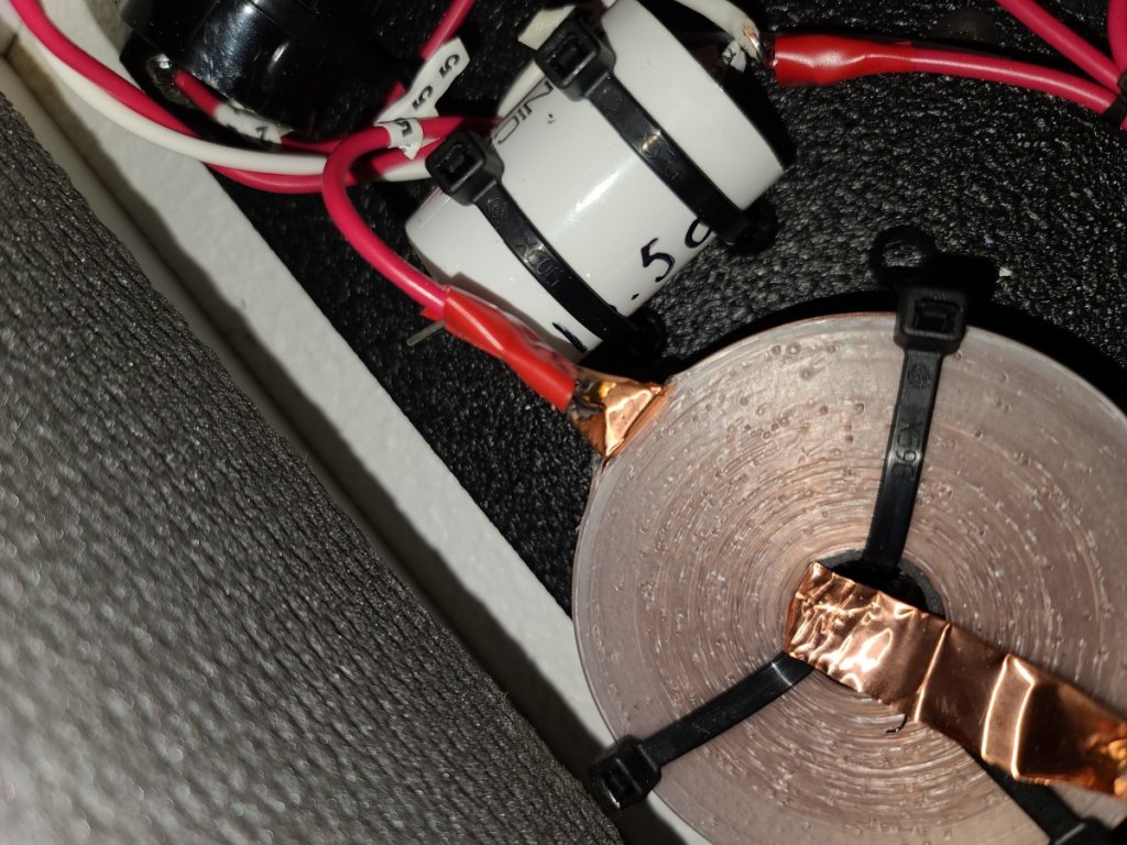

Argoncat described it perfectly, but here's a pic if it helps.

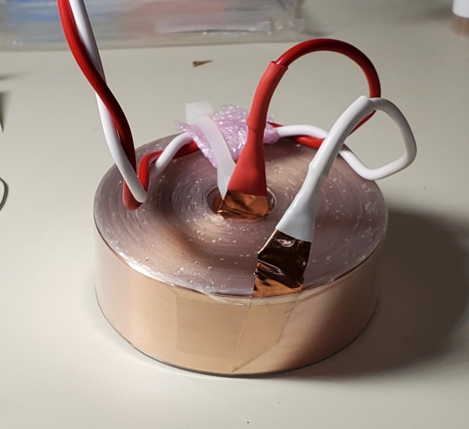

« Reply #4 on: 8 Jul 2021, 03:30 pm »
I was worried about damage to the foil so I added some strain relief.  The wire was solid core so it wasn't flexible.  I placed flux in the fold of the copper and placed the wire in the fold.  Next, I folded the copper foil to form a triangle, and crimped the copper around the wire with pliers.  It soldered really well.  I used two layers of heat shrink to cover the connection.
EDIT:  The zip tie was temporary while I soldered the wires to the inductor.  I replaced it when I mounted the inductor onto my crossover board.

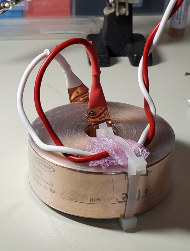

« Reply #5 on: 8 Jul 2021, 04:48 pm »
Here are more detailed photos of how I connected the crossover wire to my copper foil inductor.
I added a slight bit of flux on the wire and foil.
I pressed the foil around the wire.
I folded the foil over.
I crimped foil against wire.
I soldered the end, making sure that enough solder flowed into the connection.
I hope this helps.
