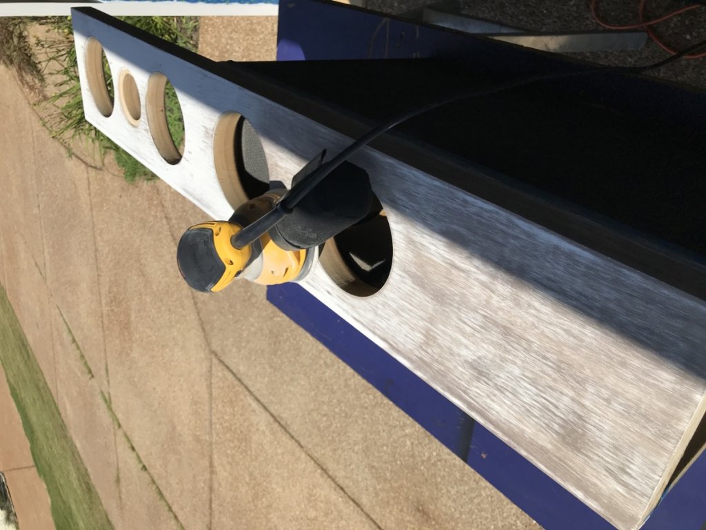

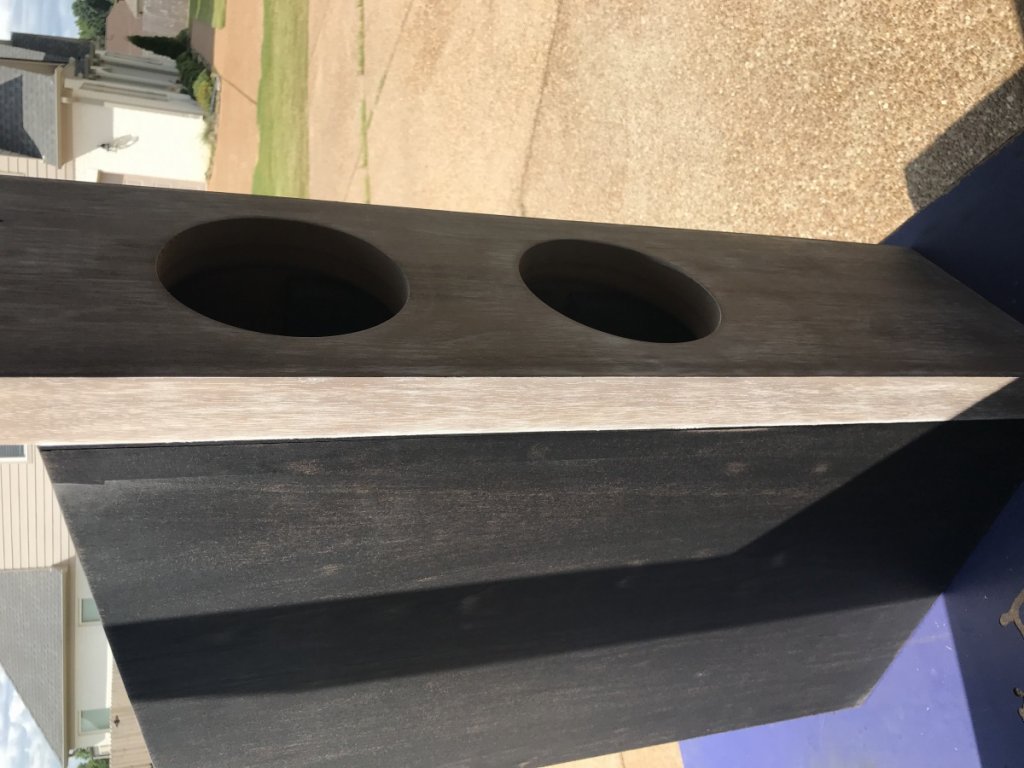

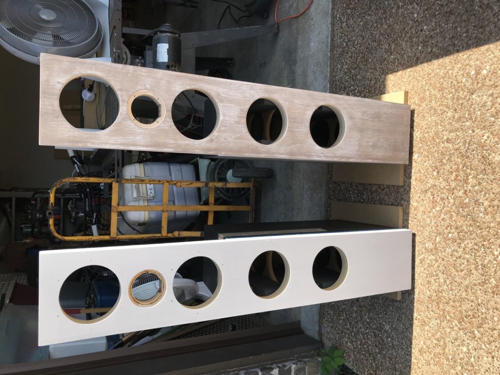

The whitewash stain has now dried and it's VERY white. It looks like white paint. So I guess I'll be sanding the baffles the same way I had to sand the enclosure.  :roll:

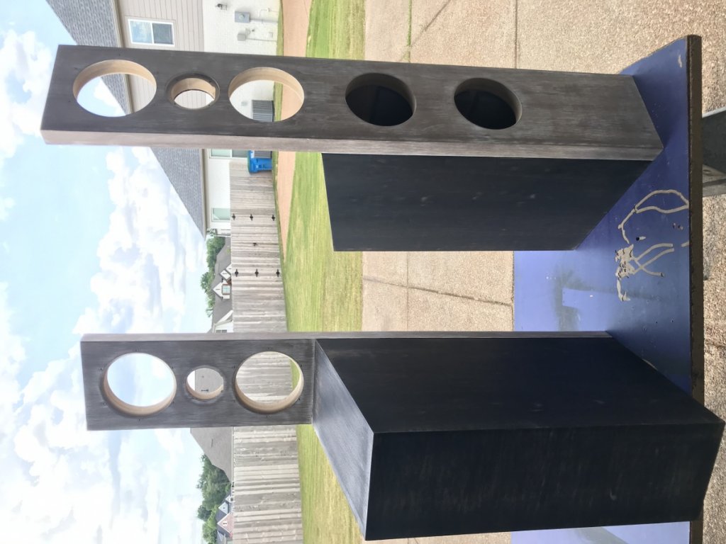

Great eye subsonic! You're right, it's double sheet of 3/4" MDF for the entire baffle. The internal volume of the enclosure remains the same because I used the same dimensions for top, bottom, and sides. Imagine that the entire enclosure just moves back 3/4". All the dimensions/angles are the same. The only difference, like hawkeye mentioned, is the 6.5" drivers have another .75" of baffle. The interior baffle has a .75" radius. Also the alignment between woofers and tweeter remains the same.
I thought about this a lot before getting started. I just could see no reason to not make the entire baffle 1.5". It's stronger, more rigid, and easier to construct this way. And I also have seen several other X-Statik builds with 1 1/2" baffles.

I got the whitewash stain sanded back today, and I pulled off the blue tape. I think they turned out pretty good, especially considering I was just winging it lol

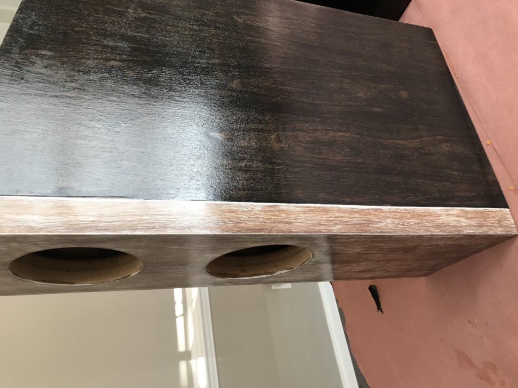

« Reply #31 on: 5 Jul 2021, 02:19 pm »

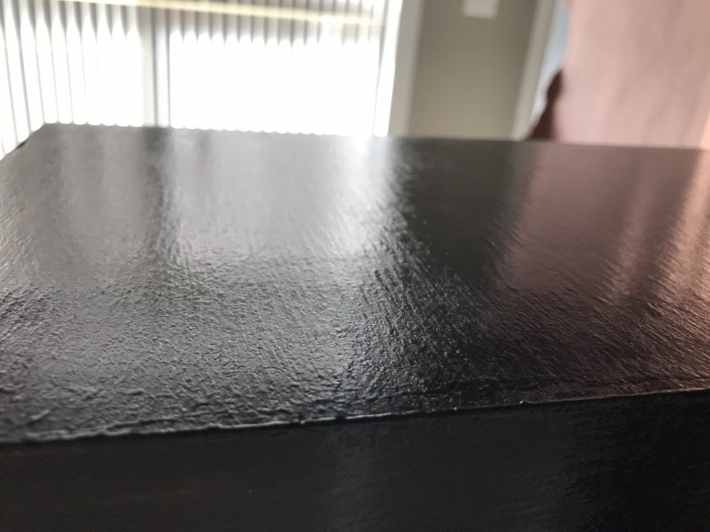

The lacquer is pretty smooth, but if you get in the light just right they have that orange peel/brushed kinda look to them.
Hollis Prince
Re: X-Statik Build
« Reply #32 on: 5 Jul 2021, 02:21 pm »
Wow that picture makes them look pretty rough lol :lol:
Once you step back it looks perfectly smooth.

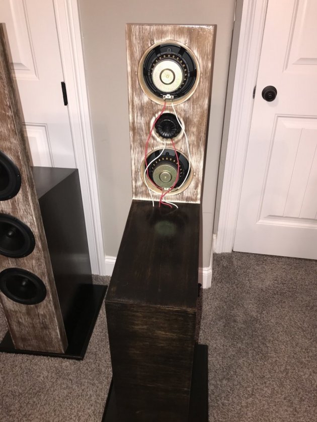

« Reply #34 on: 22 Jul 2021, 10:10 pm »
Here's a couple of images of the finished product. Although the finish turned out different than I expected, I do really like the way they look.

« Reply #38 on: 25 Jul 2021, 01:29 pm »
Thanks so much guys! I've got countless hours in this build so that really means a lot! As soon as I can get the cash together I'm going to build an X-Voce. It should go much faster if I've learned from my mistakes lol. And I made a lot of mistakes!
I just got them all hooked up and running in my living room. I haven't yet listened to a lot of different stuff, but what I have listened to sounds phenomenal! I included a picture of how they're set up at the moment. I have a Marantz SR5011 receiver running everything. I have an old Tube Works - MosValve amp running the subs. The X-Statiks are 39" from the back wall. I hear absolutely no smearing. Of course really the only thing that is actually open baffle is the two midrange drivers. The tweeters have a sealed back.
You can see in the picture a couple of bookshelf speaker builds using my old Boston Acoustic car audio speakers. They actually sound amazing too. But the X-Statiks and the two 10" subs sound so great! The sound stage is magnificent and they truly disappear into the room.
