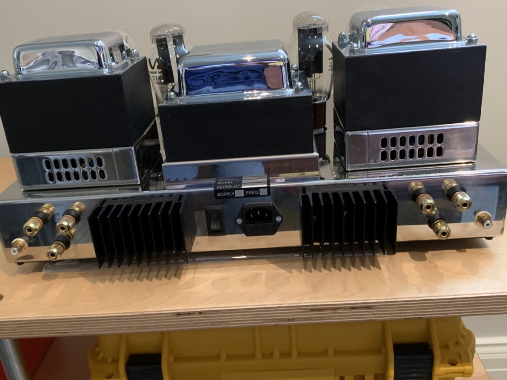

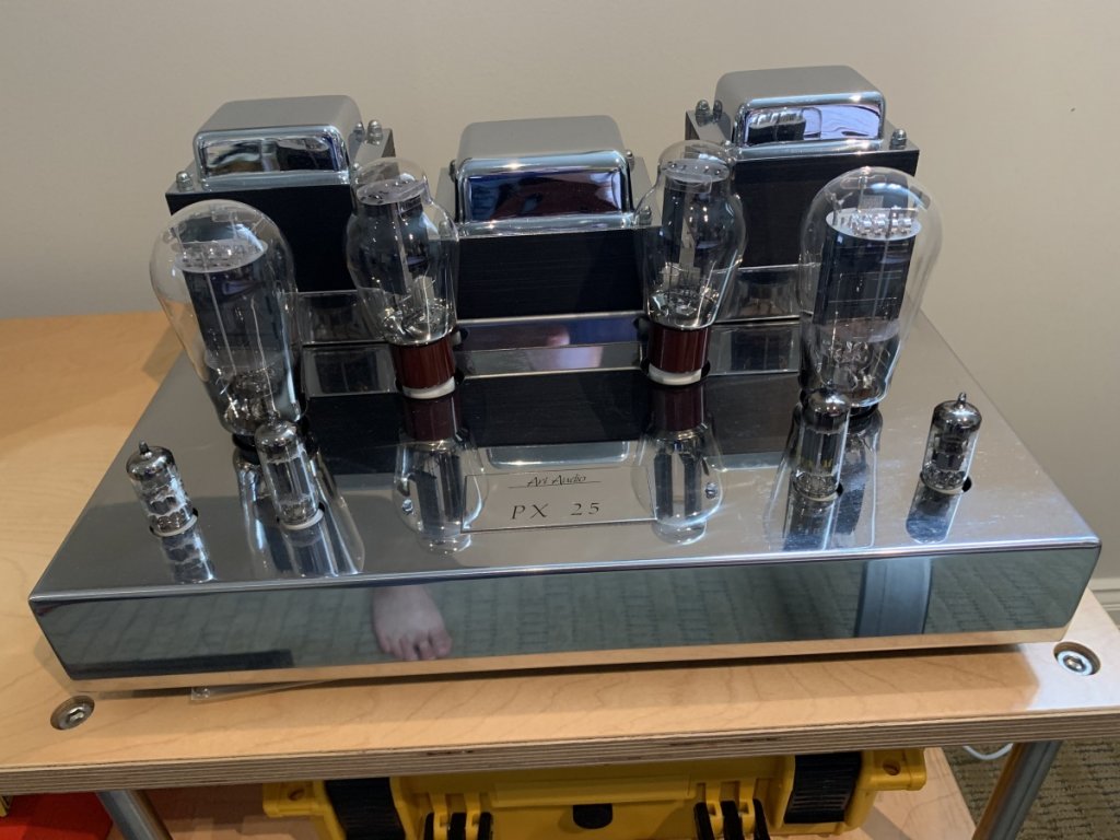

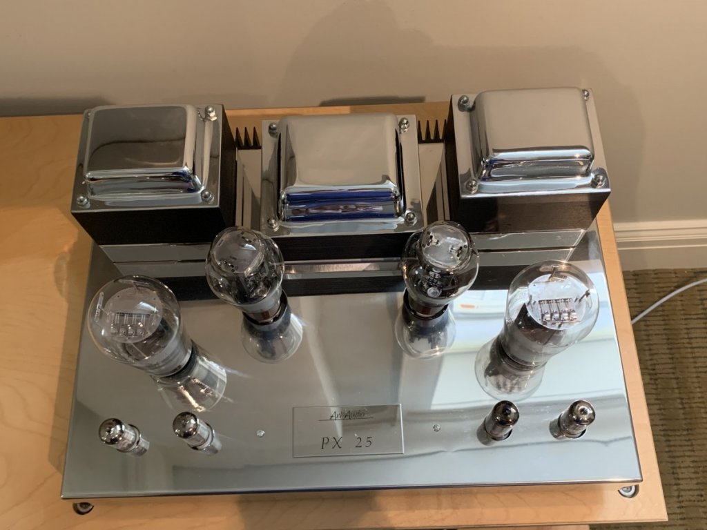

I recently purchased this exceptionally nice condition Art Audio PX25, but discovered that it has too much gain for my 108db bi-amped horn system, so I am selling it on. This amp would be an excellent sonic match for speakers with a sensitivity of 90db and above (e.g., Daedalus, Tekton, Zu, Omega). It's also very quiet.
Specs:
Power Output: 6 wpc
THD: less than 1%
S/N Ratio: >85 dB
Input Sensitivity : 400mV
Input Impedance: 180 kOhm
Frequency Response: 10 Hz to 20 kHz +/- 0.5 dB
Weight : 60 lbs.
There are plenty of very favorable reviews of this amp online. The new version of this amp currently sells for $17,995.
Includes original manual, double box and packing materials, AC power cord; KR PX-25 tubes, Valve Art 274B tubes, Amperex Bugle Boy 6922 and Sylvania 12BH7 tubes.
Asking $3,800 to cover my costs. Prefer local pickup due to weight, but will ship at buyer's expense. Paypal fees responsibility of buyer.
