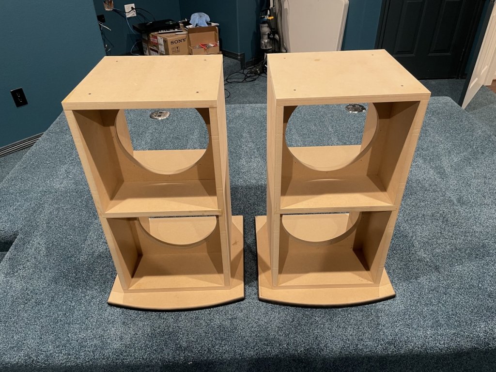

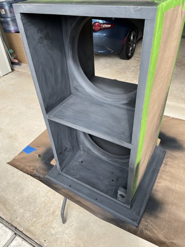

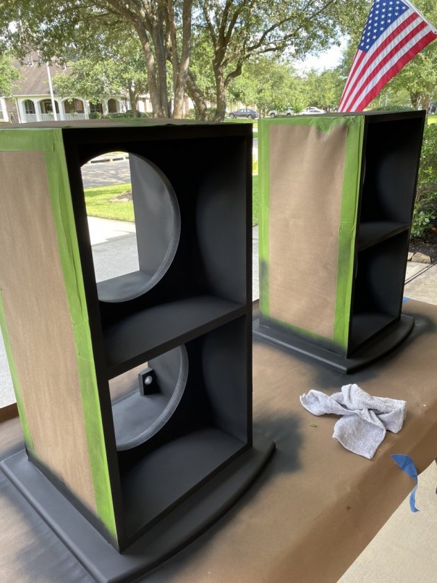

I supposed I should break out from the Home Theater thread to document my experience building these Servo Sub 4 kits.   First, these are A LOT heavier than you might think.   The cabinets alone without the sides and top are probably close to 30-40 pounds.   I can hardly imagine building triples without having a helper.
Things I've learned so far (or painfully recalled after years of being dormant):
  • Don't try to sand before the primer is fully cured
  • Don't expect the paint to cure the same way when it's over 100 degrees outside with the heat index (something I used to know, but I haven't painted anything in probably a decade, so this was a painful reminder)

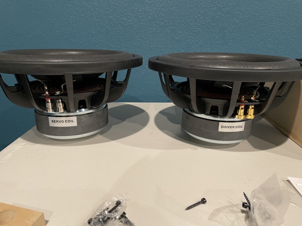

  • The drivers have two sides, one with gold connectors marked "Driver Coil" and one marked "Servo Coil" - I never spun them around to notice two different connections and thought I had two Servo-only Drivers in one kit   :duh:

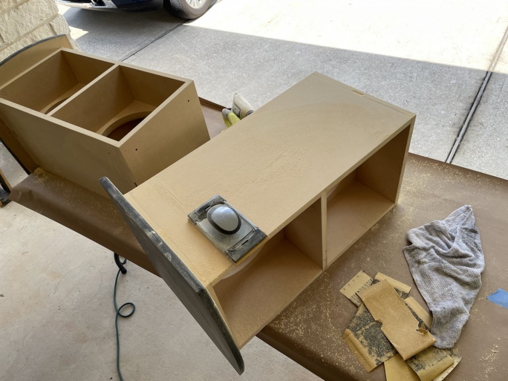

Next step now that the bases are attached is to sand flush the outer surfaces of the inner cabinet with a portable belt sander.   Then I'll mask off the mating surfaces for the side and top panels and finish priming the base and inner cabinet.   I'm planning to pick up some walnut veneer for the outer panels, which will get done through a buddy of mine before they are attached.   Meantime, here's the progress as of this morning:

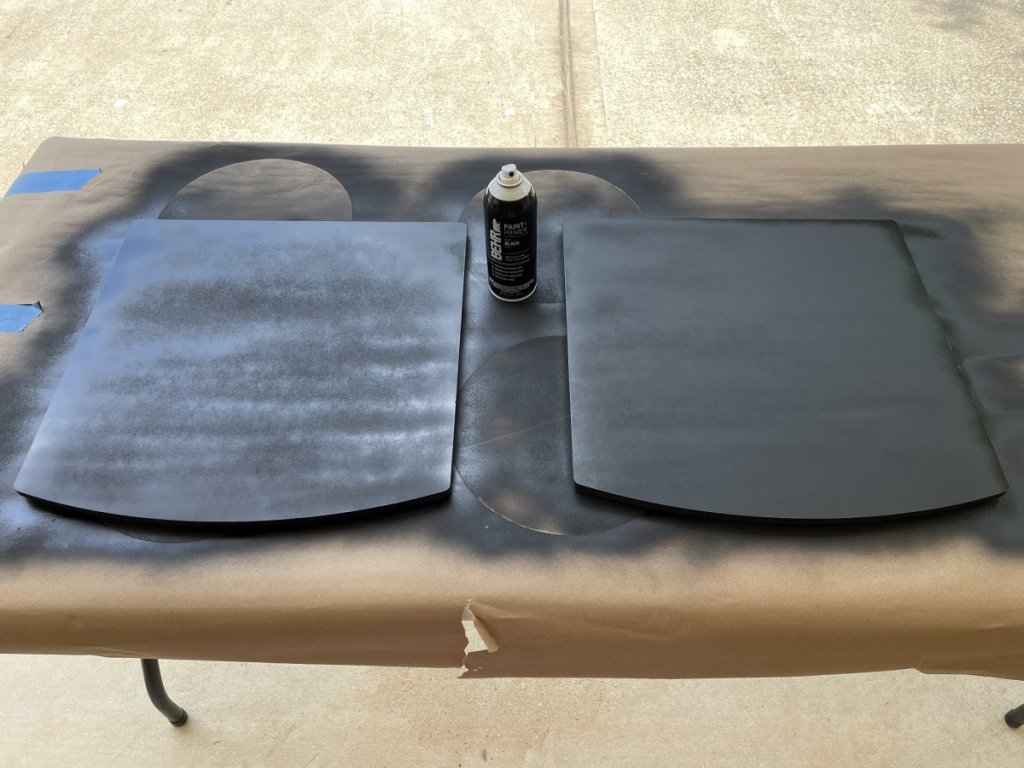

I'd take some cold and wet right about now.  And, thanks!   Yes, these are Killian's flat packs through Danny's site.   I tried to add a second coat of primer today, and it was so hot that the paint literally dried before it hit the cabinet and turned into black dust.   So I'll probably just hit what's on it with some 2000 grit and be done with the painting for now.   I'll start the electronics rough-in tomorrow.   Meantime, I'm trying to debug a wiring issue.  All 11 speakers worked great, but the sealed subs were misbehaving during Audyssey calibration.   I ran RG6 for the LFE channels, and the RG6 to RCA compression plugs I got apparently aren't worth a crap and would only intermittently connect.    I'm using a different connection method (F-connector on the RG6, then F connector to RCA adapter) with parts hopefully arriving tomorrow.

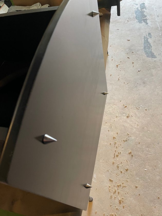

Not much happening lately since I'm still waiting on no-res to show up, but at least they have their feet now.   I also picked up the veneer last week, so that will get started on soon as well.

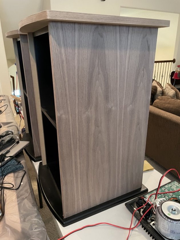

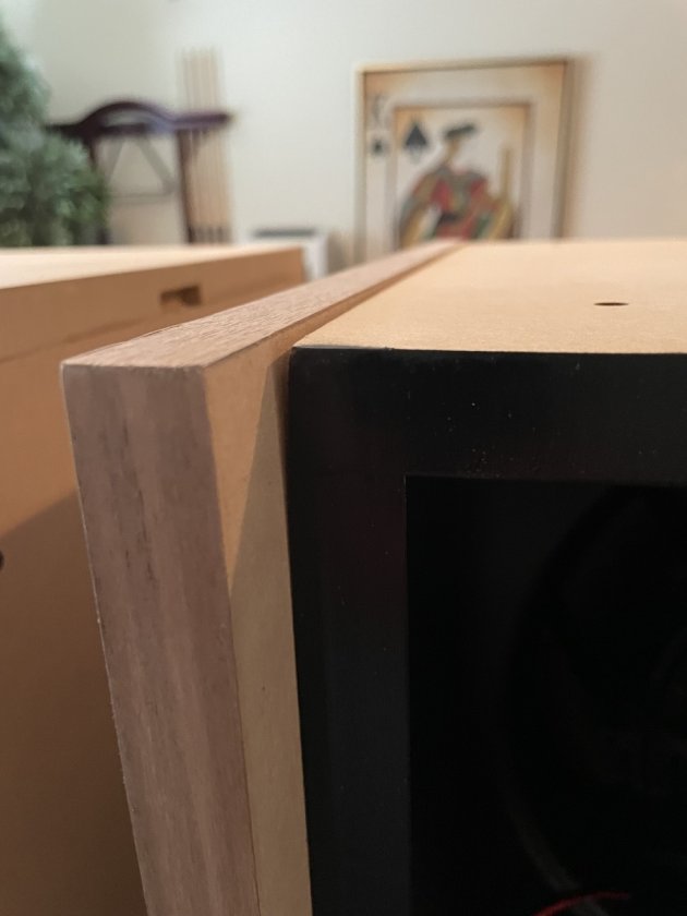

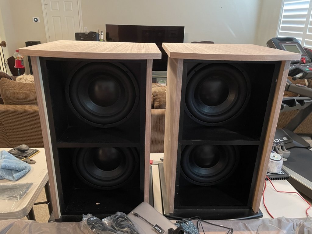

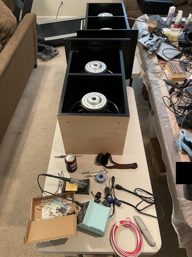

Everything seems to be moving in slow motion these days, including the shop I had do the veneer.   But stuff is finally starting to show up again.   Unfortunately, they missed the memo about not putting veneer on the short edges of the side pieces.   But, no worries.   It was nothing a flush bit on a router couldn't handle.    :thumb:

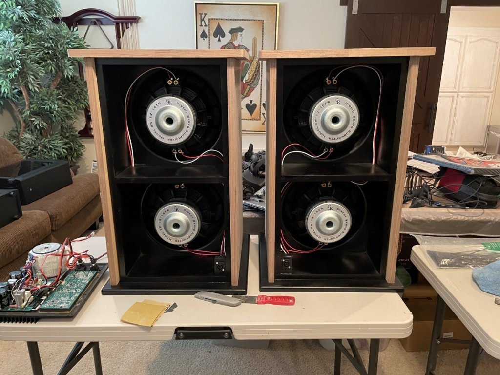

Theronbo
Re: Amateur Servo Sub 4 Build
« Reply #17 on: 6 Aug 2021, 11:03 pm »
Wow!
Gorgeous work…
But….
Aren’t the drivers supposed to be facing opposite directions?  Not, both same direction.
The picture on the product page has them that way… & I thought that was part of the open baffle design…

subsonic1050
  • Posts: 307
« Reply #19 on: 7 Aug 2021, 12:41 am »
Wow!
Gorgeous work…
But….
But, never built one… never seen one & certainly never heard one.
They can be set up either way - either all facing forward or alternating. Cabinets are slightly different depending on which option you choose.
