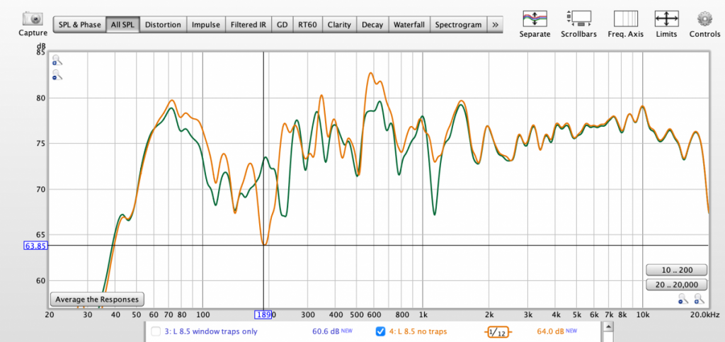

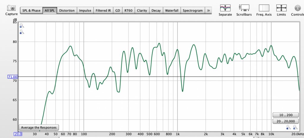

When do you think that you might do some room measurements? It might be worthy of a new thread for "Room Sizes, Room Treatments and Measurements". I'm still tinkering with my room treatments as I'm doing the DIY route. My room is 14.5' wide x 22' although it 's not a closed rectangle as it opens to other living areas on the sides. In an case, my setup:
1. LTA Z10
2. X3; subs on 2nd to last dot (aka 10 of 11)
3. SMSL M400, Chord Cutest and MHDT Orchid Havana
4. MicroRendu
5. Owens Corning 703 DIY 6" absorption corner traps on the front wall
6. X3s 3.5' off front wall (I've tried 3' to 6') and 3' to side walls (I've tried 2' to 4')
Here is my current measurement of my left speaker

Radarnyc, I understand  that dipoles are very tricky to measure. Based on your measurements it appears there is a suck-out in the power range between 100-260 Hz. Do you hear any of that?  For example it would be noticed as weakness in the left hand of the piano, trombones and cellos. But likely it doesn't sound exactly like it looks.

You're correct, I should run REW measurements.  Maybe later today.  Looks like you have a 10dB swing peak to trough.  I think that less than 5dB is preferred.  Al said REW is tricky with dipoles.  I'll check on the REW forum for answers.

Marcus - that's correct and I had exactly a 20db spread before treatment. I'd love to learn how to measure better because my ears tell me a different story than what I see in my measurements.
The orange line is without room treatment:
