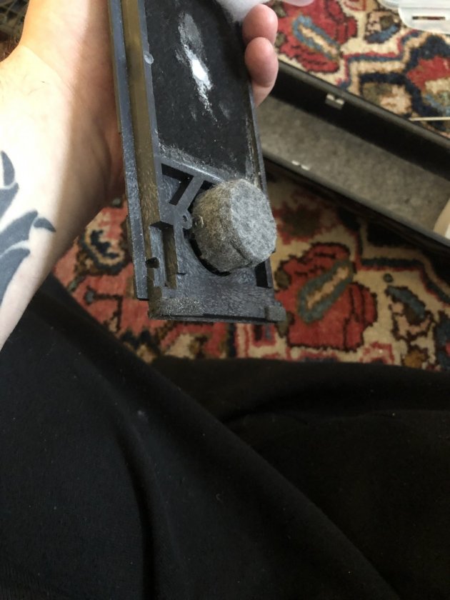

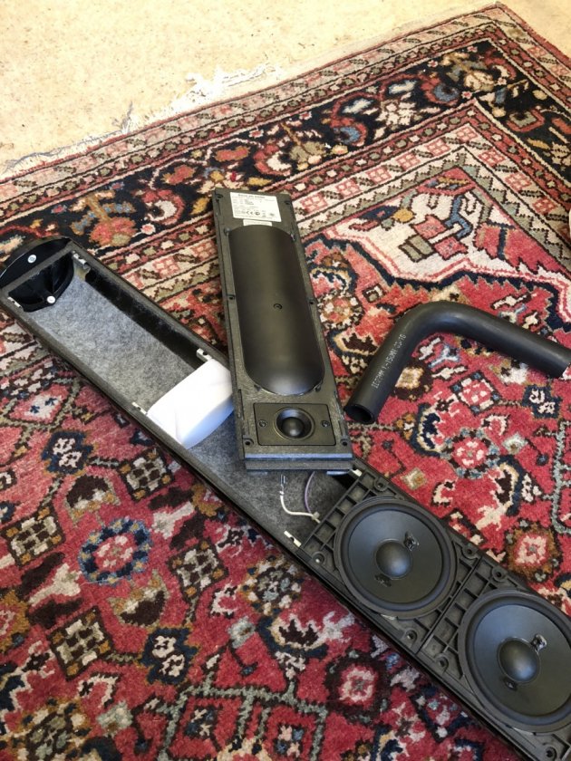

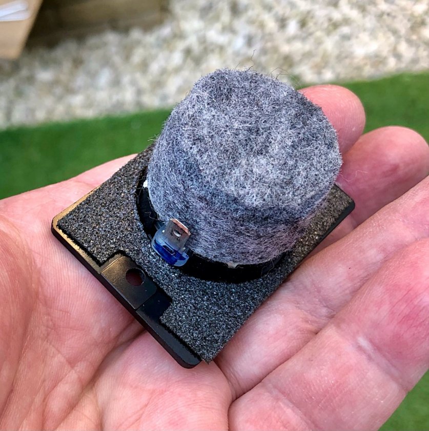

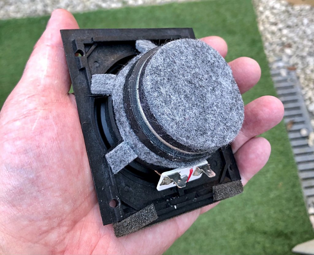

A few years after discussing with Jeff possible modifications to my B&O Beolab 6000 MK2 active speakers, I have finally got round to working on them. The reason that I chose this particular model, is because I think that it has got some tremendous potential to be a world class speaker (right up there with the best). I’m nearly finished, just a few more things to do to them.
I wanted to document my progress here for future reference. Here is a list of the mods…

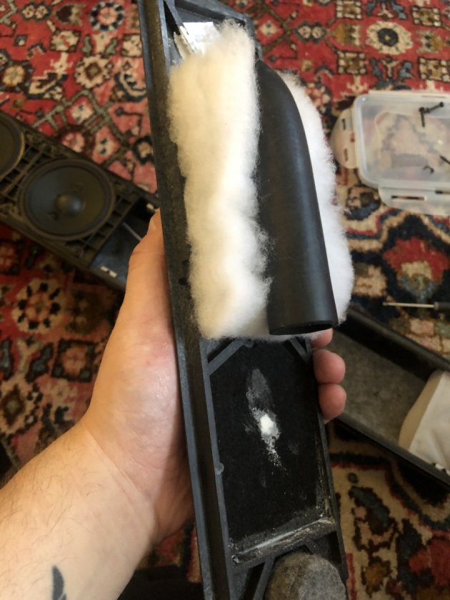

1) DAMP THE INSIDE OF CABINET WITH 4.5MM THICK FELT.

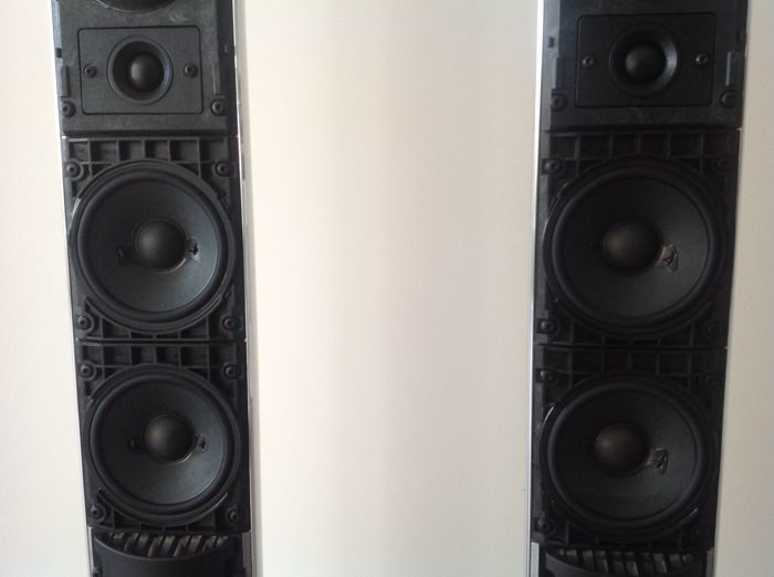

2) DAMP THE BACK OF THE MID/WOOFERS AND TWEETER.
3) REPLACE ALL INTERNAL WIRING.
4) NEOTECH 12AWG UPOCC TEFLON STRANDED FOR PCB POWER WIRING.
5) BARE NEOTECH COPPER 22AWG SOLID CORE FOR TWEETERS (TREATED WITH DEOXIT GOLD & COVERED WITH COTTON SLEEVE).
6) BARE NEOTECH COPPER 18AWG SOLID CORE FOR MID/BASS UNITS (TREATED WITH DEOXIT GOLD & COVERED WITH COTTON SLEEVE).
7) BARE UPOCC 20AWG SILVER PLATED COPPER WITH COTTON SLEEVE (FOR SIGNAL WIRES).
8) BRAIDED COPPER SHIELD OVER THE TOP OF SIGNAL WIRES.

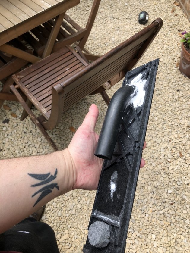

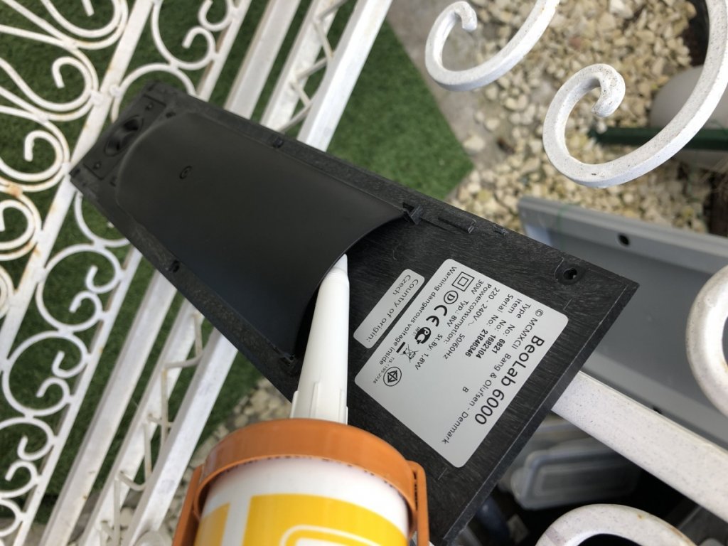

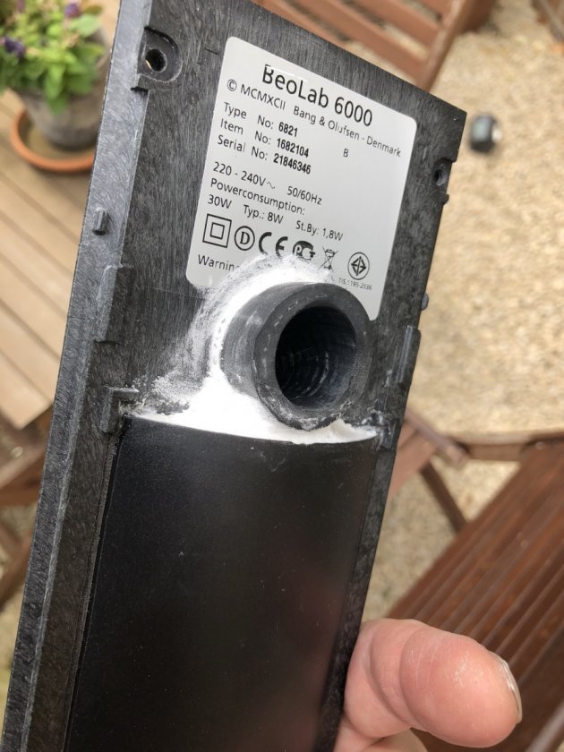

9) BLOCK OFF THE FLIMSY PLASTIC BASS REFLEX PORT & REPLACE WITH ANGLED RUBBER PIPE.
((NOTE: I LATER CHANGED MY MIND, AND WENT BACK TO THE ORIGINAL PORTS))

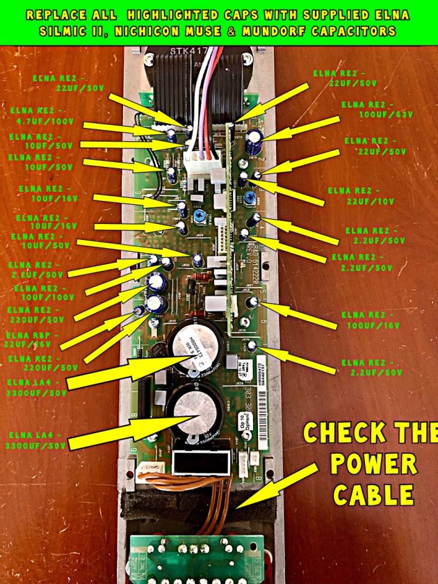

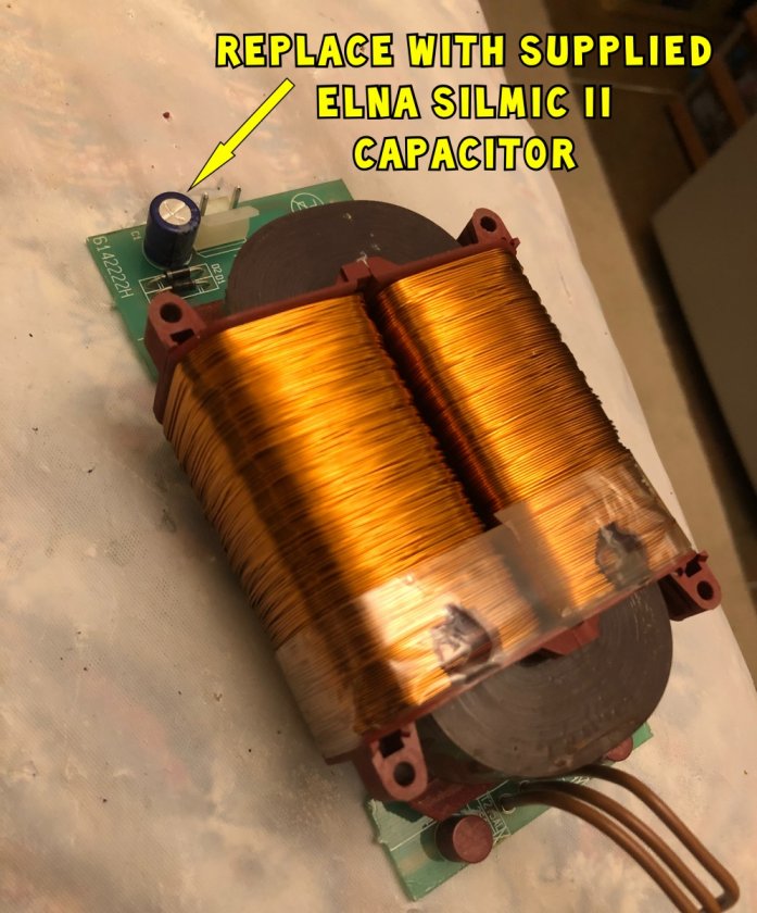

10) REPLACE ALL ELECTROLYTIC CAPACITORS WITH ELNA SILMIC II, NICHICON MUSE, MUNDORF AG.
« Last Edit: 27 Aug 2024, 12:52 pm by OSIB16 »

((NOTE: I LATER CHANGED MY MIND, AND WENT BACK TO THE ORIGINAL BASS PORTS, ALREADY BUILT INTO THE BEOLAB 6000 CABINET))

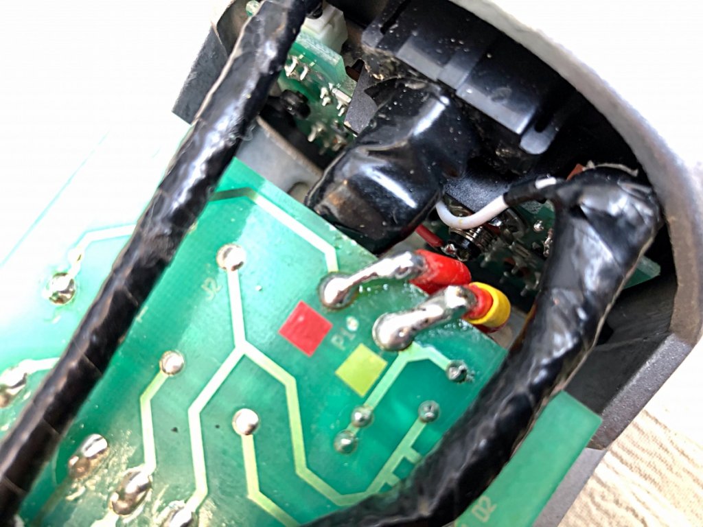

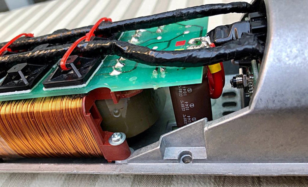

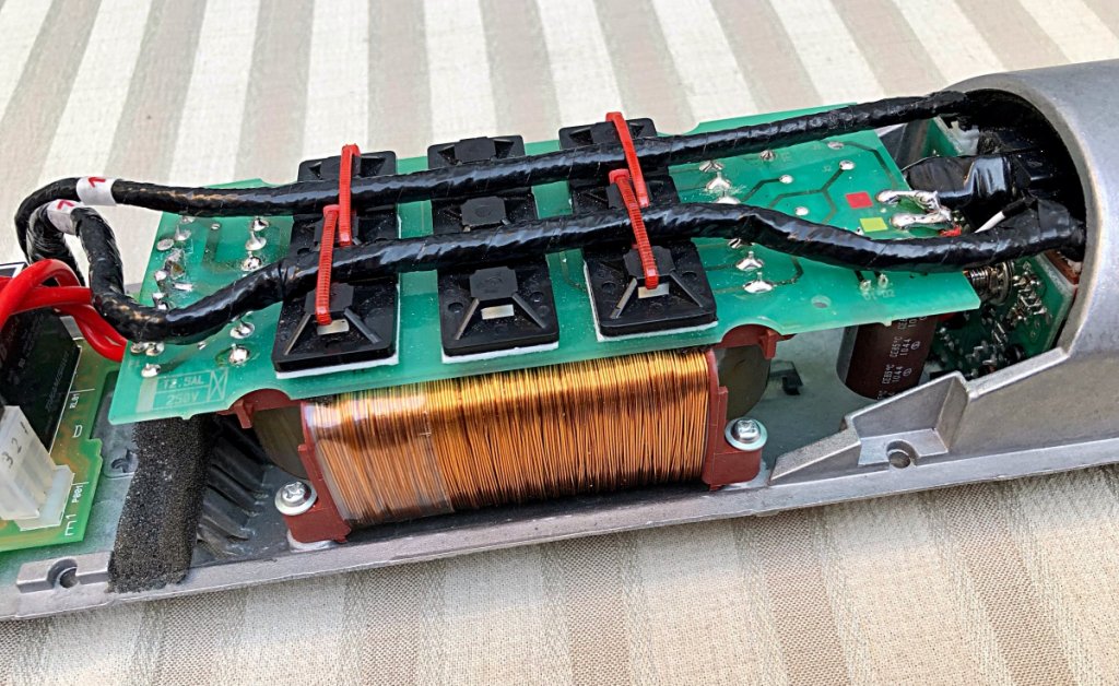

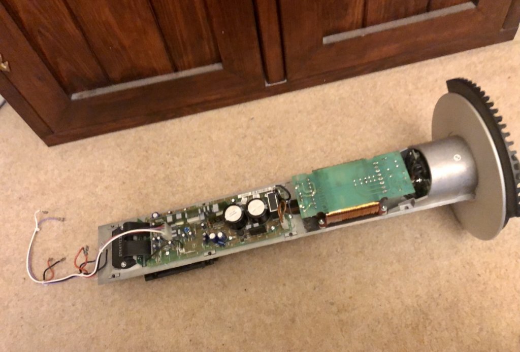

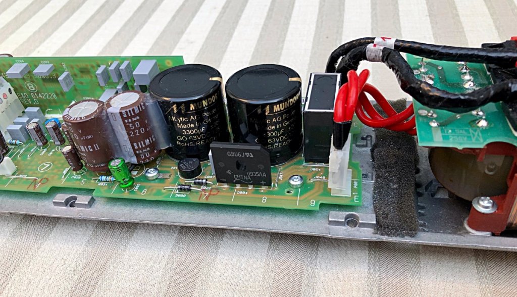

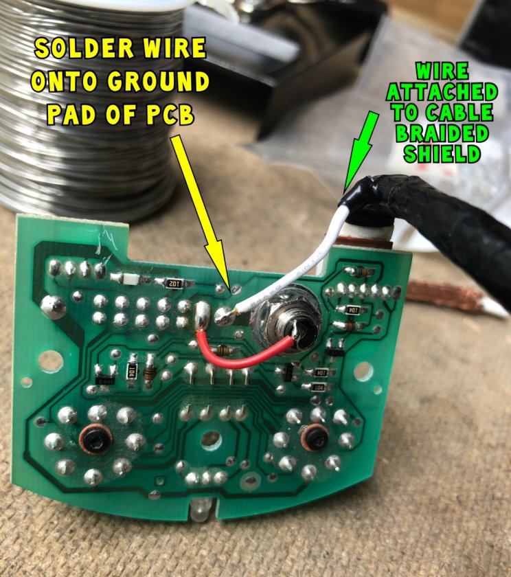

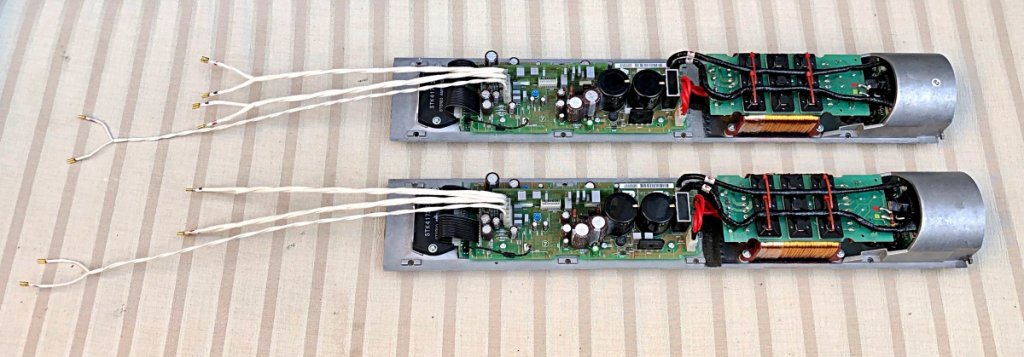

ELECTRICAL MODS HAVE BEEN COMPLETED. SHOWN BELOW…

« Reply #13 on: 2 Jun 2021, 12:09 am »

« Reply #14 on: 2 Jun 2021, 12:13 am »

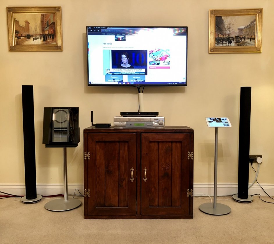

Here is my Hifi system…

Nick B
  • Posts: 972
Re: BANG & OLUFSEN BEOLAB 6000 MK2 MODIFICATIONS
« Reply #17 on: 2 Jun 2021, 05:02 pm »
Quite an interesting project to follow  :thumb:

« Reply #18 on: 2 Jun 2021, 06:04 pm »
Ok I’ve been running in these modded Beolab 6000’s for approx 8 hours so far. It’s still early days, but so far I notice a definite improvement in 3d soundstage with the speakers disappearing/melting into the background. I also hear a significant reduction of perceived cabinet colorations. But most noticeable is the new ability I now have; to be able to play them louder without the sound falling apart due to distortion. Finally the bass is much cleaner than before. I’ll let people know how I’m getting on when I reach 100 hours of play time.
