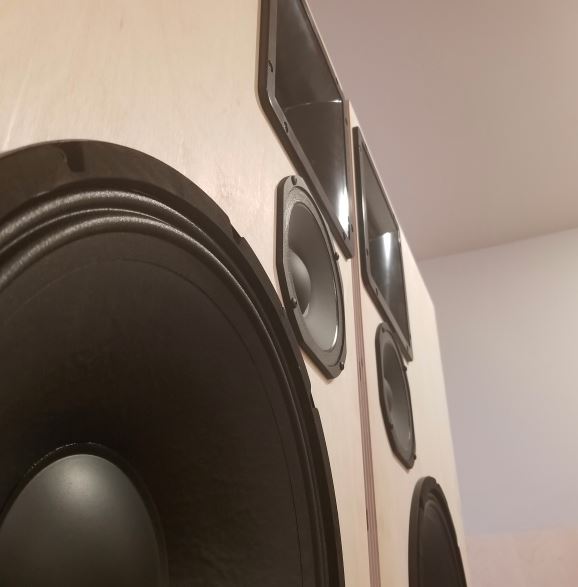

Scott Hinson was asked to design a passive 3-way open baffle speaker using the new SB-Audience pro sound drivers for the DIY community. The documentation and listening notes make for an interesting read and is available here: https://www.madisoundspeakerstore.com/pdf/SB%20Audience%20OB3%20Open%20Baffle%20Kit.pdf
The kit is available through Madisound with or without completed crossovers: https://www.madisoundspeakerstore.com/open-baffle-speaker-kits/sb-audience-ob3-open-baffle-3-way-with-15-woofer/
The 15" woofer is purpose built for OB applications.
Thought this might be of interest...

Looks interesting, but one aspect is disappointing.  The compression driver is 107db sensitive, midrange 98dB sensitive, bass driver 99dB sensitive, yet the end speaker is 85 dB sensitive.   :o
A smarter person than me could buy the kit without the passive crossover and use full dsp for crossover/room/phase correction  :green:
Agreed.  If you're going thru the exercise to do an all passive OB, running dual woofers help offset some of the baffle and dipole loses.  I'd have tried dual 12" to see if the end result saved more of that mid/top efficiency.
This is the penalty you pay for using drivers that need massive correction and complex crossovers to get them to sing evenly across the full frequency band. Those passive electronics make my head spin.
