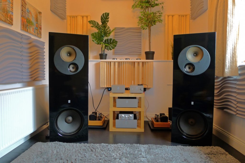

I am very pleased with the sound of my system and room treatments. I have left the walls directly behind the OBs untreated to preserve the rear of the dipole. The OBs are 4ft from the facing wall, but, out of necessity, close to the side walls for a broad soundstage.
Recently I have been running-in a pair of new midrange drivers at volumes where I cannot stay in the room for long. From outside the room the sound is clear and undistorted but in the room, particularly up near the OBs, and with female vocals, there is a very nasty glare (echo?). This very occasionally invades the normal listening experience.
So do I need to treat the walls behind the OBs and if so, what with.

Looking again at my picture, and with the OBs angled in a bit, the rear dipole actually fires into a corner. In retrospect this may not be a good thing as it creates a 'horn' type echo area.

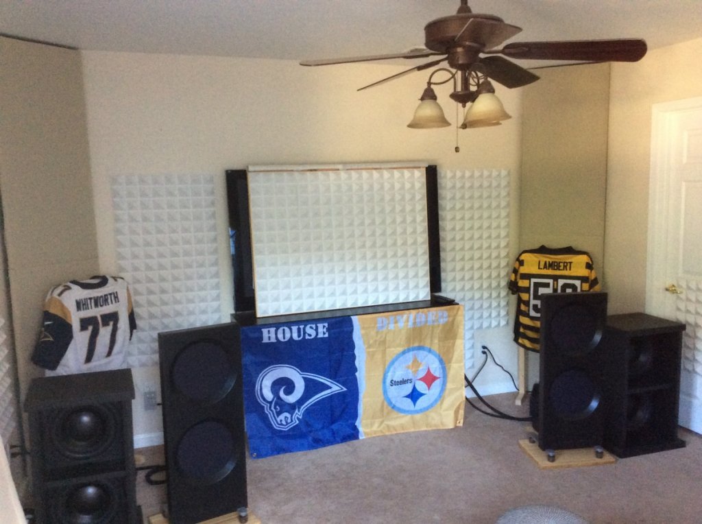

Nsm1979
Re: Wall treatments behind OBs
« Reply #8 on: 12 May 2021, 03:32 pm »
This has been my best setup so far.  Dispersion on the front wall and at first reflection side wall points.  DIY base traps in front corners.  Rear wall is covered with absorbing room darkening drapes.

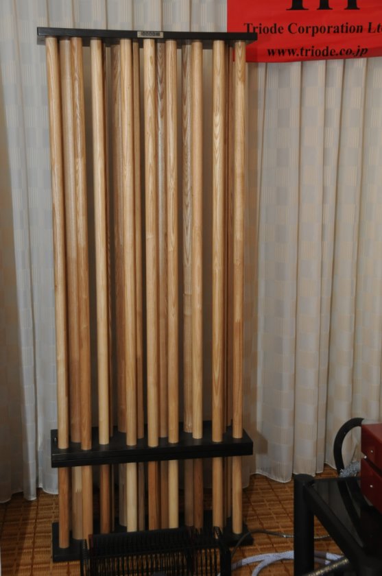

What I've heard, and found to be true, is ... for cone/box speakers you absorb on the front wall (behind them) and diffuse in the listening space. For dipoles you diffuse on the front wall (behind them) and absorb in the listening space. The side walls also need tabsorption at first reflection points if your speakers have a wide dispersion.
Here's what I did. Look at the wood dowel construction I made behind my speakers. I also found that absorbing the center space was better than diffusion there.
That construction was based on one I'd seen at an audio show. The best part was they cost me about $100 using Home Depot dowels and a little stain and paint and elbow grease, as opposed to the $4000 the originals cost from some buddist-named company that you've all probably heard of before. Here's the look of the originals.
Could you please share the details how to construct these diffusers? Links or plans will help...Thanks in advance
BobM
« Reply #12 on: 17 Sep 2021, 12:45 pm »
Pretty simple. Plans aren't necessary. Get a bunch of different sized dowels from Home Dopey, stain and poly them, then construct a top and bottom piece and arrange them randomly with a single screw through the header and footer into the center of the dowel.

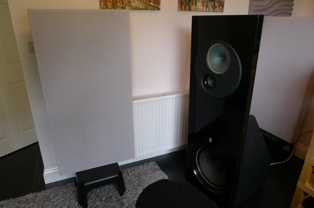

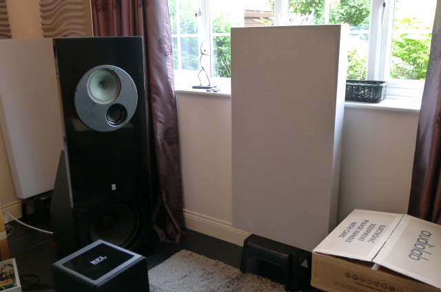

I took some advice from GIK Acoustics and their recommendation was to concentrate on the first reflection points. My acoustics are unbalanced with a steel heating radiator on one side and window on the other.
I bought a pair of 4ft panels and placed them at those reflection points raising them temporarily on a couple of stools to cover the mid and tweeter drivers.
Now this has made a profound improvement and as important as the adsorption panel in the corners behind the speakers.
