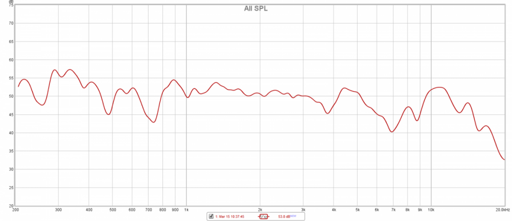

My dad's speaker is a 3-way design somewhat similar to those from the 70s. They aren't great, esp with how far apart the tweeter and mids are, they have serious cancellation issues once your head gets below the midwoofer. And the box comes completely unbraced and its really noticable esp at higher volumes.. (even after bracing the cabinet, its still really chesty when turned up)
But swap out the drivers, for Danny's tweeter, the 4" midwoofer for a M165 in a sealed compartment. Then in the bottom, use a 8"-10" woofer for everything below 200Hz.
I need to redo my measurements, but here's how it measures stock, before I braced it. (And include vertical off-axis measurements, as well)

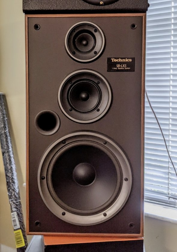

@ Hobbsmeerkat
It's funny you mention Technic speakers, my dad also has an old pair of those. From a quick google search it's the SB-7000. When I was explaining the NX-Oticas to him and that the tweeter is aligned with the voice coil of the woofers, he brought up the Technic's and how that they did that (or attempted something of the sort) for those speakers as well. He still loves those things! Man, they have to be tired by now though... I thought it was cool that they actually showed the frequency response literally on top of the speaker itself. Probably not something too many manufacturers do :lol: Can't remember if it looked like a good response or not though.

« Reply #34 on: 12 May 2021, 08:32 pm »
Oh yeah, I've seen a few of those time-aligned designs in catalogues when trying to find info for my dad's model. (which there's very little cuz it seems to be a budget model only produced for Circuit City in the early-mid 90s).
Its definitely an interesting concept tho I'm sure the reflections off the top baffle are a problem, esp for the mids
The crossover for this speaker is basically woofer playing full range, a varister that feeds into a cap for the mid, then a cap & resistor for the tweeter..

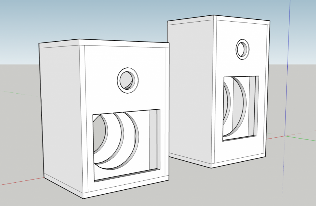

Hobbsmeerkat
  • Posts: 2741
Re: A fun speaker.
« Reply #38 on: 14 May 2021, 02:38 am »
Saw this thread this morning and thought I'd dig up a little ancient history.  I had these built...wow...a decade ago!
https://www.audiocircle.com/index.php?topic=93720.0
For reference, I've also spent an evening with arguably the best LS9s ever built with about a hundred grand worth of tubes feeding them.  There are things that each design does (did?) better than the other, but I wouldn't hesitate to say these traded punches with the LS9s.
If you're into that sort of thing, these literally cracked the plaster of my walls.
 :thumb:

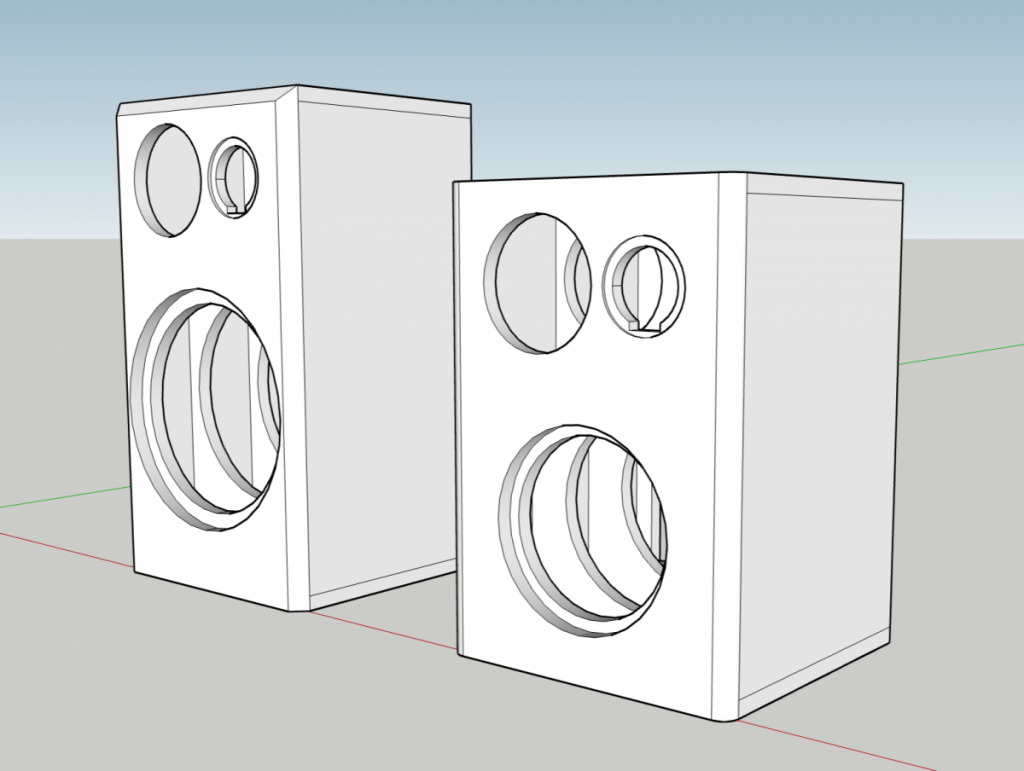

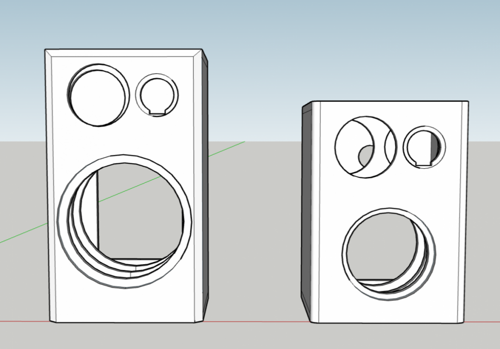

That's a rad design right there! i'm sure it sounds every bit as incredible as it looks!
here's a quick couple designs i put together over the last couple days:
Uses the basic XLS drivers in a sealed upper box with either a 12" or 8" sealed servo sub below it.
12" version is ~25" tall 8" is about 21". The airspace is a little tight, tbh.. the 12" is ~1.2 cubic ft. the 8" is ~1.0Cu-Ft.
Space for the amp is pretty tight in the 8" version, so its rotated to fit cleanly.
