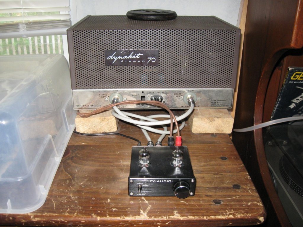

Hi, I probably sound like an idiot but I have a few questions I think you guys I bet know.
     I have an Emotiva DC Blocker CMX 2. There are 2 outlets on this devise. It's in my bedroom system which consists of a Onkyo C-7030 cd player, a preamp, and a Dynaco ST-70 that has worked flawlessly but like the preamp,and I'm talking a few different ones,has an older 2 prong plug. I needed an extra outlet so I plugged a 6 plugged power strip into 1 outlet on the Enotiva which is then plugged into the wall. My fuse box has a breaker for just that one room. I have a dimmer switch also but tried it in and out of the circuit before and did not notice any difference.
    I can hear the transformer buzzing when I get close to my system. Here is another thing; I thought my Onkyo cd player was making a small hum noise too. I spread my fingers like attempting to palm a basketball and pressed down on the Onkyo's chassis and that slight downward pressure makes a big improvement in reducing the hum. Is my body acting like a ground? I have used passive preamps with  no power cords and still get a slight hum, the same as with a 2 prong plugged preamp,Dyna PAS. The hum never comes from any of the preamps but the cd and power amp. Any ideas?...thanks so much, sincerely Mark Korda

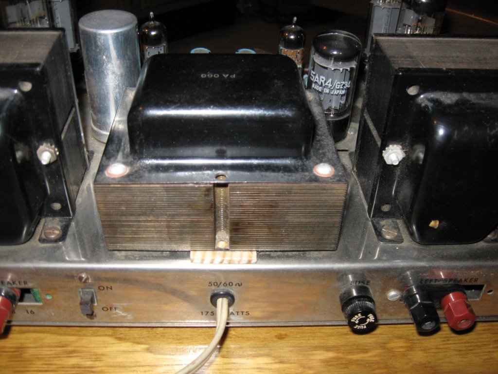

Hi No Disco, I noticed the same thing you said as I could hear the humming close range on my amp, cd player,and speakers. One thing I noticed on 99 percent of Dynaco tube amps was the lack of screws securing the transformer bells to the transformer it's self. I wondered if age on the plates in the tranny might introduce vibration as they rusted so minutely. I put a wooden carpenters shim under my power transformer.I think you can see the screw holes where there should of been some bolts securing the bells (outer casings). The wood shim did reduce some some hum. It's kind of like what a wooden axe handle does by absorbing vibration. One more thing; I took my cd player back to where I bought it so the Hi-fi guy could hear it and it was dead silent,I was there with him. Take care No Disco....Mark Korda

The metal chassis top on the ST-70 acts as a big sounding board, amplifying mechanical hum from the attached ST-70 power transformer.  The hum itself can come from low level DC on the power line or just loose internal plates in the transformer. Generally this hum is not transferred to the speakers.
Hum from the speakers comes from grounding issues, or because the system does not know the words.
No cure for loose plates other replacing the transformer.  Low level DC is blocked by our HumDinger and that might help you.  People tell us it works better then the old Emotiva unit.
