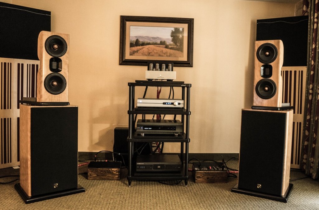

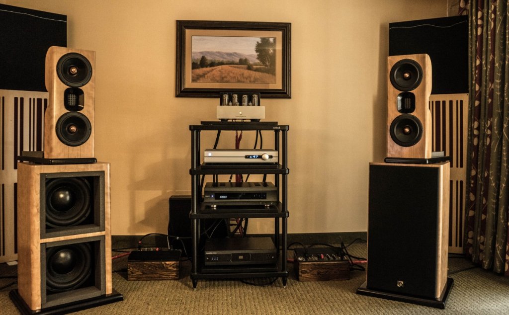

Another option is to surface mount the grill frames. That's what I did with mine. In any event, I build the frames to match the opening rather than the other way around.

The grills are attached with magnets that were installed before the veneer was applied. I lined up the grill frame where I wanted it on the cabinet and used painters tape to secure it in place. I then drilled pilot holes through the grill frame into the cabinet where I wanted the magnets to go. After removing the grill frames, I drilled holes for the magnets into the cabinet so the magnets would be slightly recessed. I secured the magnets to the bottom of the holes with CA glue then filled the holes with epoxy so they were slightly domed. Once the epoxy cured, I sanded it flush then applied the veneer.
