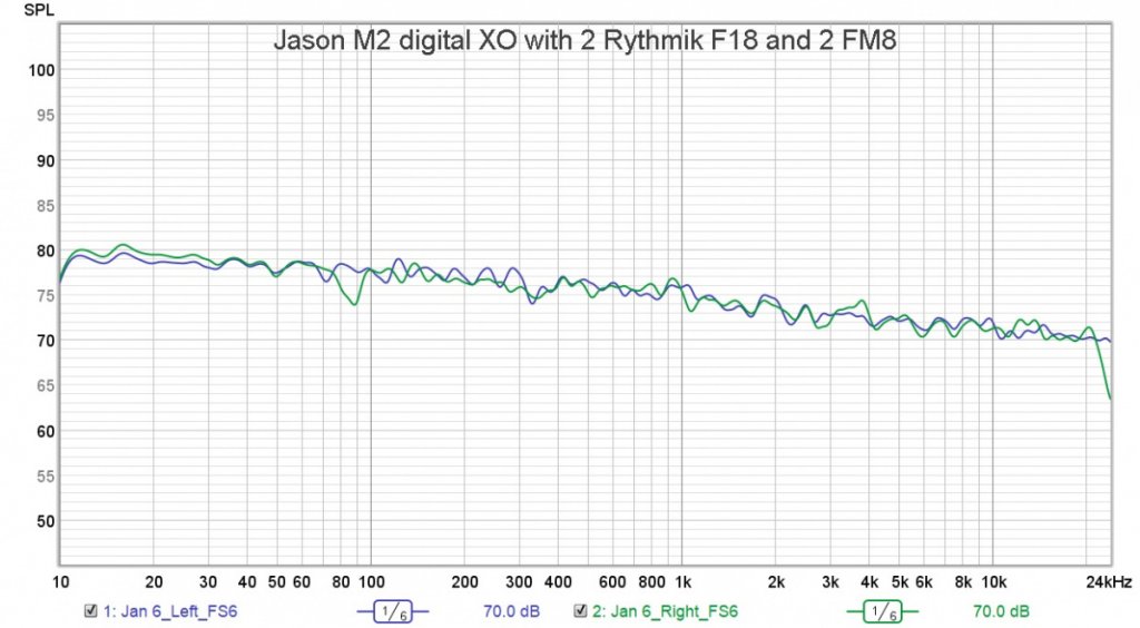

No idea what punchy means but they do go flat to 10Hz.
