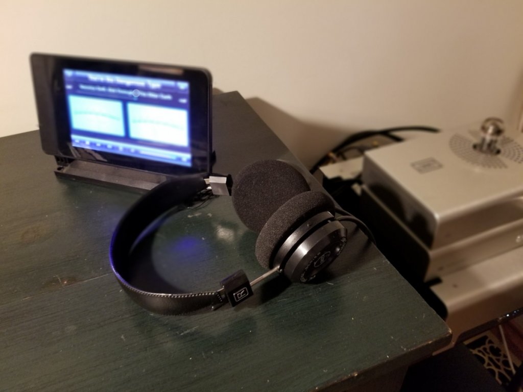

You can also add a 7" touch screen to a Raspberry Pi and get a Squeezebox Touch on steroids -- capable of 24/192K play and a much larger screen with a number of display options. The screen below shows their blue VU meters, but they have several other options. In this case, the RPi 4 is powered by Picoreplayer OS 7 and runs a USB output to an external DAC. I have another RPi 3 player with a HiFiBerry DAC HAT with no screen on a second system.
The nice thing about the RPi option is that you can continue using LMS to manage and play your collection and streaming sites (I use Qobuz) so you skip having to transfer things or learn a new music management system. And the sound quality of the RPi is superb, dependent on how good of a DAC you use with it.
Here's a photo of the player:
