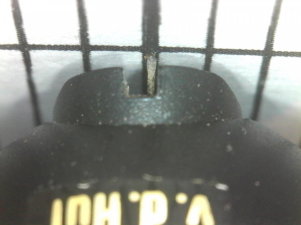

I have a Well Tempered turntable, square motor, and even with the antiskate adjustment to minimum (the arms close together), the cantilever of 2 cartridges have become askewed as if there is too much antiskate force. One Dynavector XX2 and on Transfiguration which I already sent in for repair and is again having the same problem....   :cry:

   Looking straight at the cart, does the cantilever bent toward the center of the record? I only noticed this once with an old turntable with auto return, the cantilever bent to the left toward the center of the record. I thought it was due to the way of the auto return lift up the cart and pull it out to return it to the side after many times.
    A picture of the cart from the front would be more helpful.

  So, it looks like it pull toward the center. I think your arm's movement is too restricted. I would check the viscosity of the silicone and how much you submerge the disc.
   With the cantilever like that the channel balance would be off for sure. Anyway, hope someone with more experience with that particular arm would jump in to help here.

One would think the stylus would not track in the record grooves and pop out before ever bending the cantilever, and this happened on several carts.
There could also be some excessive downward force on the cantilever as well.
