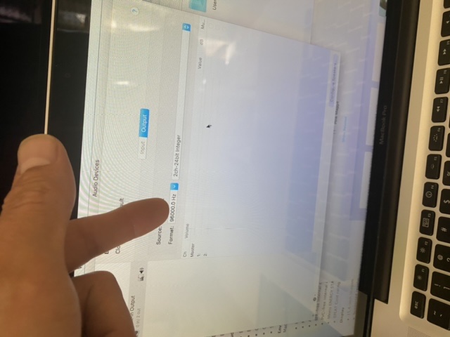

Most people won’t know, in order to change the sample rate of the TOSlink optical out, you need to go into your applications folder, then select the Audio MIDI setup option (should be close to the top) remember the optical out is really for 2 ch listening.. you’ll see a drop down you can select the higher sample rate. To me, switching back and fourth while playing Deftones Passenger I notice that when playing on the high sample rate the Cymbals are brighter, things open up a little bit. It’s subtitle but you can notice it.

Way off topic! Redirect... Most Apple products will have this program built into the utilities folder.. your hardware may not be able to output higher, but to check click on the drop down with the sample resolution... see if you have any other options. I can go to 96kHZ

Some reason that photo twisted itself.
Let’s try again
Ha! That’s twice! Oh well, you get my point.

What do you set your master stream to?
