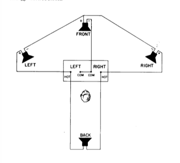

    The Hafler/Dynaco system worked very well, if...
    • you were playing a live recording, and/or...
    • You had a largish space, as I was fortunate to at the time I was playing with it (I was still living 'at home'), and/or most importantly:
    • You ignored the norm of putting a speaker in each corner and used a single rear speaker well behind and above the listening position.
    I was fortunate to meet all these criteria. A good live recording could sound great through this setup. The original Dynaquad setup was conceived as follows:
    The customary speakers-in-the-corners alternative (a horrible idea then and now) was introduced later for 'marketing' reasons (that's how everybody else was doing it). The front center fill was optional and really only worked properly with Dyna electronics because they had a Blend position on the mono stereo switch which corrected for the center speaker dominating when connected as shown.It also required identical speakers, at least across the front.
    One rear speaker worked better than two here because there really was only one 'rear' channel anyway. 'Matrix' quad, of which Dynaquad was but one example, had definite shortcomings, but the Dyaquad system could sound surprisingly good on the right recording.

    The Hafler system with front center in my view collapses the soundstage. It almost eliminates depth. The rear is full-range and problematic. Next is the rear level. Putting a cheap volume control on the rear hurts the sound. Using small bookshelf's may help, but doesn't solve the problem of interference with the front speakers.  The impedance is the number one reason the Hafler set up is problematic. Adding 2, 3 or 4 speakers to one amp is difficult for the average audio person and not possible with most systems without sound quality compromise. Lastly, you cannot do Hafler w mono-blocks.
