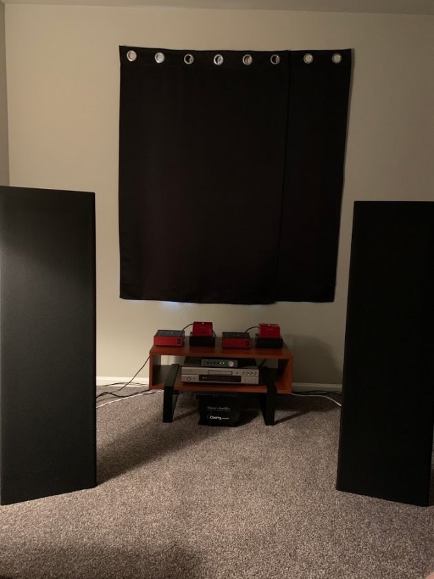

Hello all.
I am close to pulling the trigger on a pair of Spatial M3's and want some more advice and opinions. Especially from other Spatial owners with small rooms.
I have had some people tell me that my room is too small for Spatials, they need room to breathe, so on and so on. I am going to bet they have never heard the Spatial M3 Sapphire in a small room.
My room is 12x10 with 8' ceilings. the speakers are on the 10' wall, They will be a maximum of 8" off the side walls and a maximum of 36" off the rear wall. And that would be the front baffle. Probably will be more like 30" off the back wall. I don't want speakers out in the middle of my room. That's one reason I sold off my Maggie's. Loved them but they really had to be out in the middle of the room to sound good. And I don't want the suggestion of, "Just pull them out further when you want to listen then put them back." That's not what I want to do. I want to sit them in their place and play them and not worry. Am I asking too much? Or will the M3's be just fine in my small and intimate space?
Thanks.

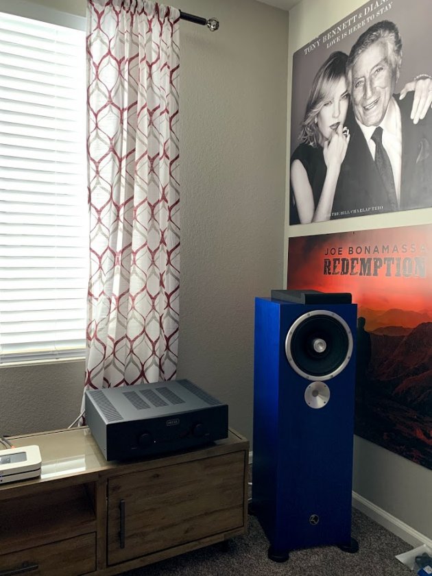

I would strongly recommend you reconsider giving the little Ohm speakers a try.  They work a charm in my friend's small room.  The reason?  Their omni design has the tweeter firing upward - where the distance between direct and reflected sound (from the bounce off the ceiling) is long enough to satisfy the timing requirements above and makes the room boundaries disappear just like an OB setup would in a larger space.  Same concept goes for the James Romeyn Late Ceiling Splash speaker designs, which you could also try pairing with a more conventional speaker in that space to create a more expansive sound field.

I just moved states for my wifes job and went from a 25 x 17 x 8' room to am 12 x 14 x 8' room. They will work in smaller room as long as you give them some room behind them and from my experience doing some first reflection point room treatments and diffusers behind them help a ton. I built my own treatment panels so it was not really expensive to do and helped tame them greatly. While they do sound awesome in a large room with room treatments like mentioned above I have had really good results.
