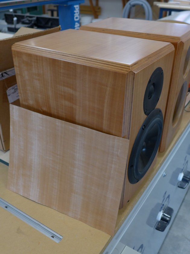

I might be inclined to paint the back same as front and then clear the whole shebang. If you have spray capability, you could tint the clear for a tone coat. The color will die back into the black, but remain prominent on the lighter parts.

Tone coats are essentially lightly tinted clear finish, usually thinned down a quite a bit. Depending on chosen clear, tint can be dye or pigment. Dye is essentially see-thru, pigment will be more opaque. The effect is that of looking through a colored lens.
 Here's one I've been messing around with. Done with pigment to kinda homogenize the exposed plys. That's a piece of raw veneer in front for comparison. In time I'll complete a video showing the how to, but I bit off a big chunk video-wise and have some life events taking precedence at this point.
