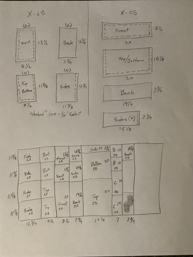

Starting with the cut plans:

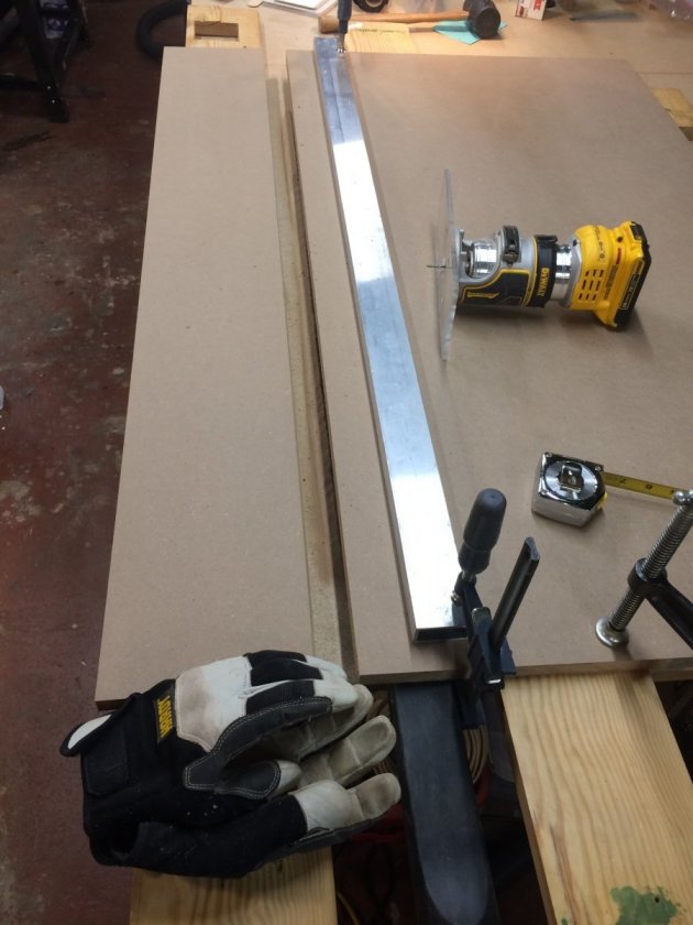

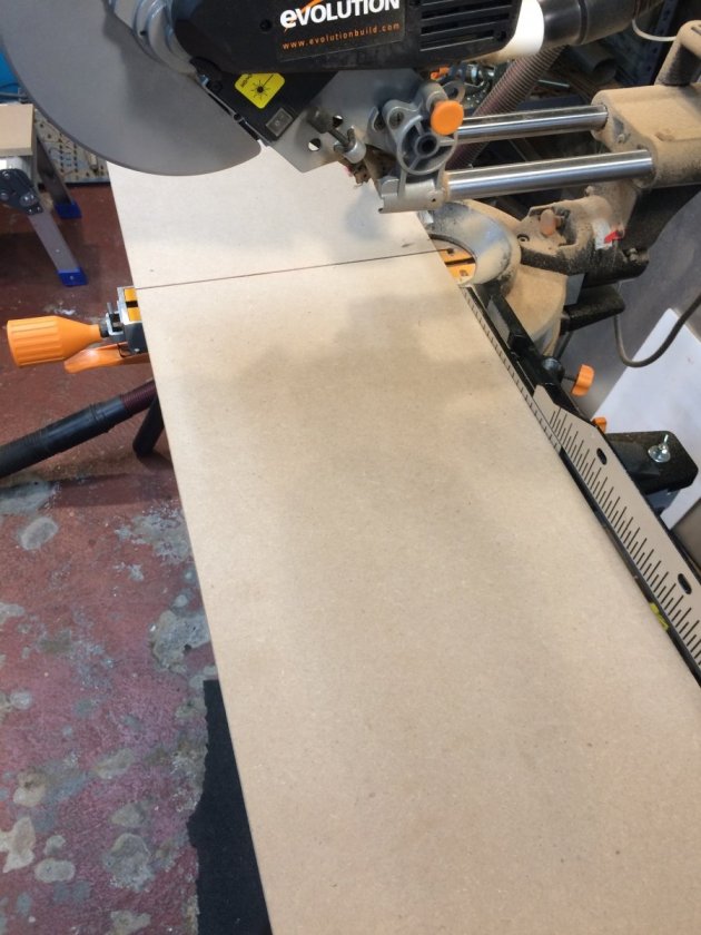

On the build front, I have finished making the long cuts of the MDF.  I have proceeded with the same method I used for the X-MTMs (https://www.audiocircle.com/index.php?topic=170542.msg1806558#msg1806558).  I really like the cordless router.  This paired with the 1/8” down spiral bit works great for making these cuts.  These cuts could be done on a table saw or with a track saw, but for my shop capabilities, the router works the best.   And, Yes, I remembered my dust mask...
I will note that I always measure down from the far end of the MDF to size the next cut location.  This way I always have a constant edge to measure from.  If I measure up from the previous cut edge, any error (even a 1/32” from one side to the other) in the angle of the last cut will translate to the next cut.  This can be compounded over several cuts.  This way I ensure things don’t get skewed too much.  Also, these cuts are a bit “rough” and there is room to make small corrections on the table saw, if needed.
Router with the 1/8” router bit and showing the extended router base on the router.  I made this base from some 1/4” thick plexiglass for doing these kinds of cuts.
A piece cut showing the cutting setup.  The MDF has been raised so a vacuum hose can be placed under it to suck up dust.  Works well for this.

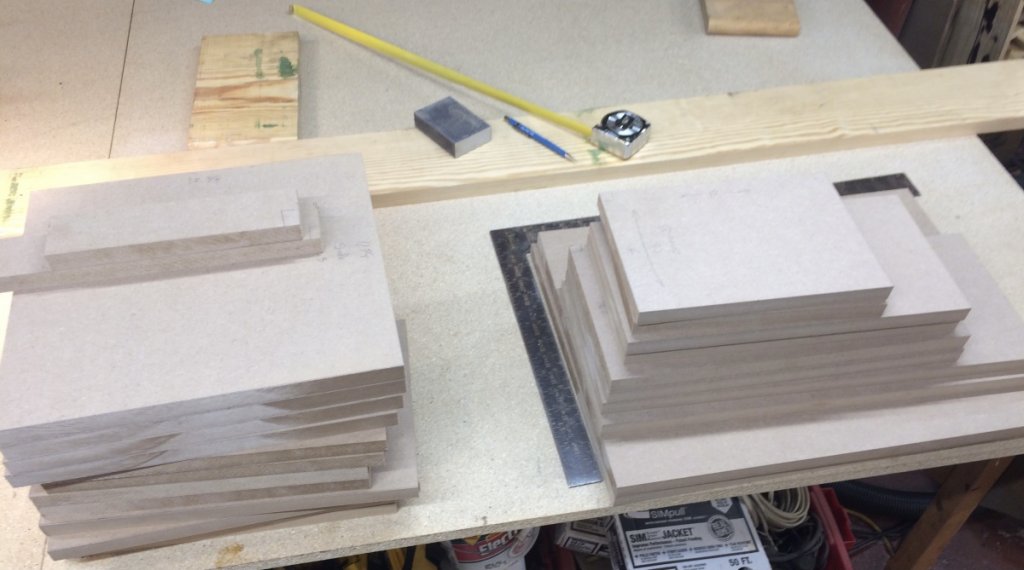

Progress is coming much more quickly than it did with the X-MTM.  Surely using them for “practice” helped...  :roll:

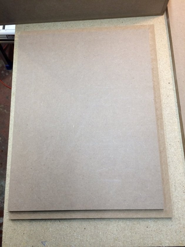

I have all of the MDF cut into panels for both the X-LS and X-CS speakers, and the braces for the X-CS.  The pieces have been sized to be assembled with rabbits on all of the outside pieces, except the back, which will fit into the rabbits in the top, bottom and side panels.  My arrangement of the rabbits is in a different order than what Peter shows in his video of the assembly of his flat pack (https://youtu.be/5n3ZYGnEjgE), but the idea is the same.
For my assembly, the front will have a rabbit on all 4 edges, the top and bottom will have rabbits on 3 edges, the side panels will have a rabbit on the back edge and none on the back panel.  Each rabbit will be 3/8” deep and ~3/4” wide.  All of the outside panels except the back are cut slightly oversized, so that will mean that the width of rabbit will need to be slightly greater than 3/4” to adjust for that.
Using rabbits also means that the length and/or width of each panel (except the front) will need to include the depth of the rabbit that it will be fitting into. The dimensions shown in sketch in the first post include the rabbit depth.
Once I made the long cuts in the sheet of MDF, the remaining cuts to lengths were, for the most part, done on my miter saw.  Fortunately it has a pretty large throat and can accommodate the 12-3/4” board...
But that is as large as the saw will take.
The remaining 15-1/8” board was cut on the table saw.  I am not a fan of making a 15+ inch long cut on a table saw as I find it is way too easy to have a result that has edges that are at something other than 90deg to each other.  Maybe that is just me, my saw or both, but is has happened to me in the past.
This time was a success!  :dance:  Moving on, and not looking back at that one...  :D
I did remember to double and triple check measurements and layout on each piece to be cut.  More than once I found I had measured an inch less than what I wanted or that my square wasn’t square on the piece when I drew the cut line.  Putting a full cut line on the piece was especially helpful when cutting on the miter saw as I could check the saw’s travel along the line and see if it was making a right angle cut.  Doing this showed that I needed to re-align the saw (who bumped that out of wack?  I don’t know...  :duh:).
The resulting cut pieces for a pair of X-LS speakers and a X-CS center channel:

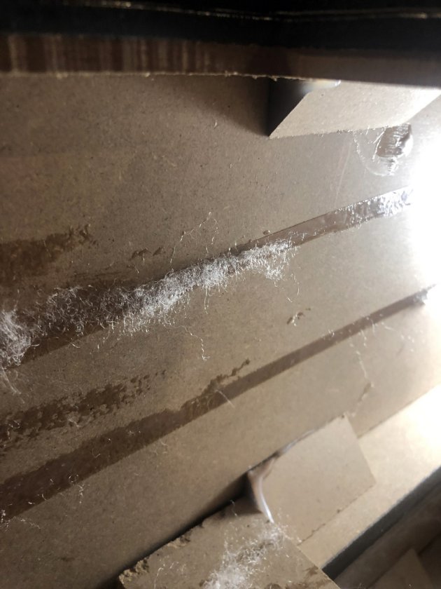

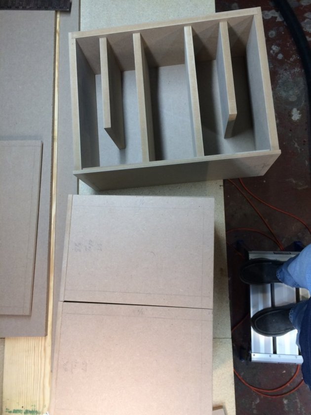

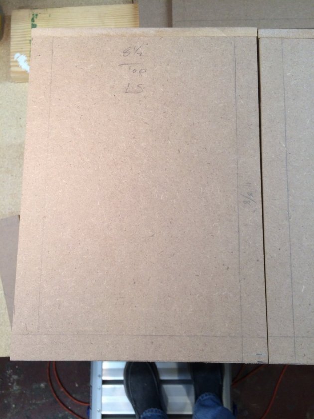

I have finish the rabbits on all of the panels for both speaker designs.  This was really quick compared to the X-MTMs, which are a much larger speaker.  I did these the same way as I did for the X-MTMs (https://www.audiocircle.com/index.php?topic=170542.msg1814590#msg1814590).  That is, I roughed in the rabbit on the router table in 2 passes.  The first being a little less than 3/8” deep from the edge and the second being a little less than 3/4” deep from the edge.  The final sizing of the rabbits was done on the table saw with the fence set to 3/4”.  While this sequence of cutting takes a little more time, I fell it gives me a bit “cleaner” rabbited edge on the pieces.  This being a sample showing the top panel for the X-CS:
One of the things I did was to layout on each panel where each rabbit was to be made.
This way, I can make and correct mistakes in pencil first...  Yes, I did make a few, like, too many rabbits on the side panels which only required one...   :duh:  And it was a good thing that it was in pencil because if I had done that with the router, it would be off to cut a new panel... :cry:  Even at that, I did route one on an un-marked end.  Fortunately, the end that was cut could have been used anyway, but just a bit frustrating that I didn’t pay attention to the markings I made and it could have been more serious mistake.  :nono:
Dry Fitup Time!   :bounce:
Pretty much of a success.
The panels for the X-CS all fit perfectly.  The width of braces (top to bottom wise) is a bit smaller (~1/6”) than the height of the interior but that will be filled by the Titebond “thick and chewy” glue  :lol:  Ok, that is Titebond Quick and Thick.  I plan these to be just butt joints as others have done, so that glue should work well for that.
Now the question is, how did I get the panels for the X-CS all sized about perfect and I missed on the X-LS?  I don’t know, but a few of the X-LS panels are a touch oversized which is affecting the overall fitup and there are some gaps as a result.  This will take some minor trimming to correct, which is OK.  I guess, just expect this to be the case and plan on a few corrections.  This happened on the X-MTMs, too.  The X-LS panels will be easier to rework than those just because of their smaller size.

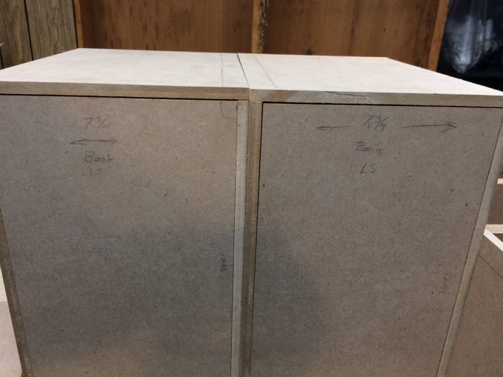

As I noted, the panels for the X-LS cabinets were a little more oversized than those for the X-CS, so there was some trimming that needed to be done.  The table saw came in handy for that.
The gap in the back panel to the top was more that I anticipated.  This was also reflected in the gap between the front panel rabbit and the top panel.  Both side panels needed to be trimmed to adjust their height by less than 1/16”
Similarly the fitup to the rabbit on the top and bottom panels was off slightly.
The width of the back panel and the rabbit on the front panel needed to be adjusted slightly to correct this.  With this done, the dry fitup was deemed a success.

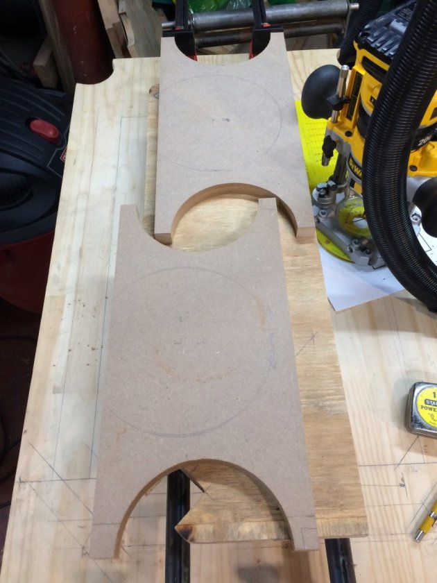

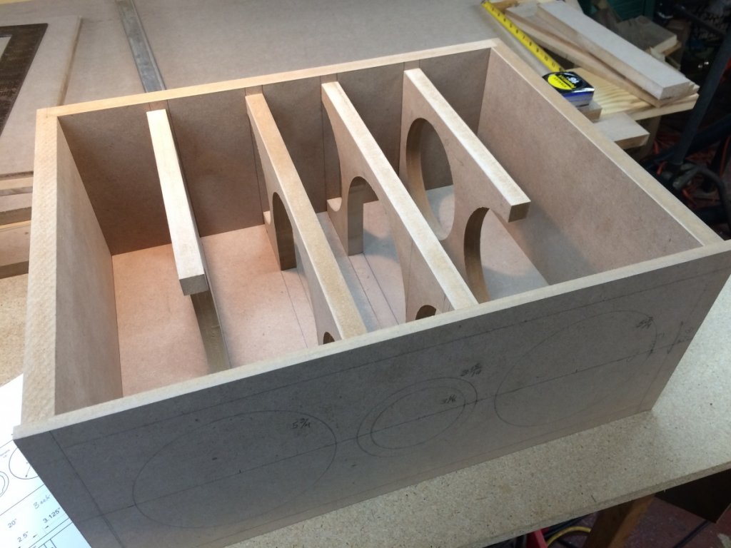

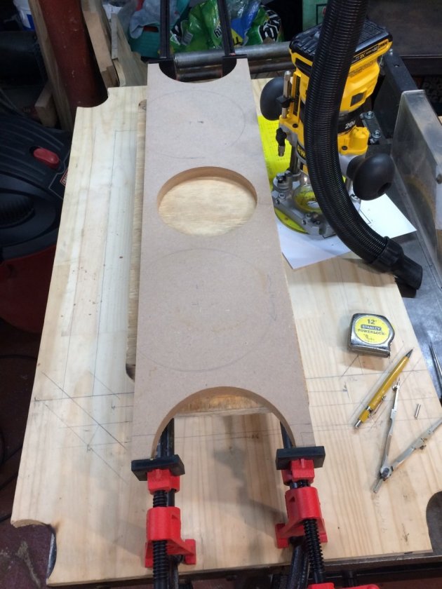

Moving on to cutting holes in the X-CS braces
The longer of the 2 set of braces have “C”  shaped cutouts at each end.  These are best cut by placing the blanks end to end and cutting the “C’s” as a single hole.  I held the panels together with pipe clamps and had a thin board between the braces and the clamps to keep from nicking the metal clamp with the router bit.
Swapping ends, I did the same cut in the other ends.

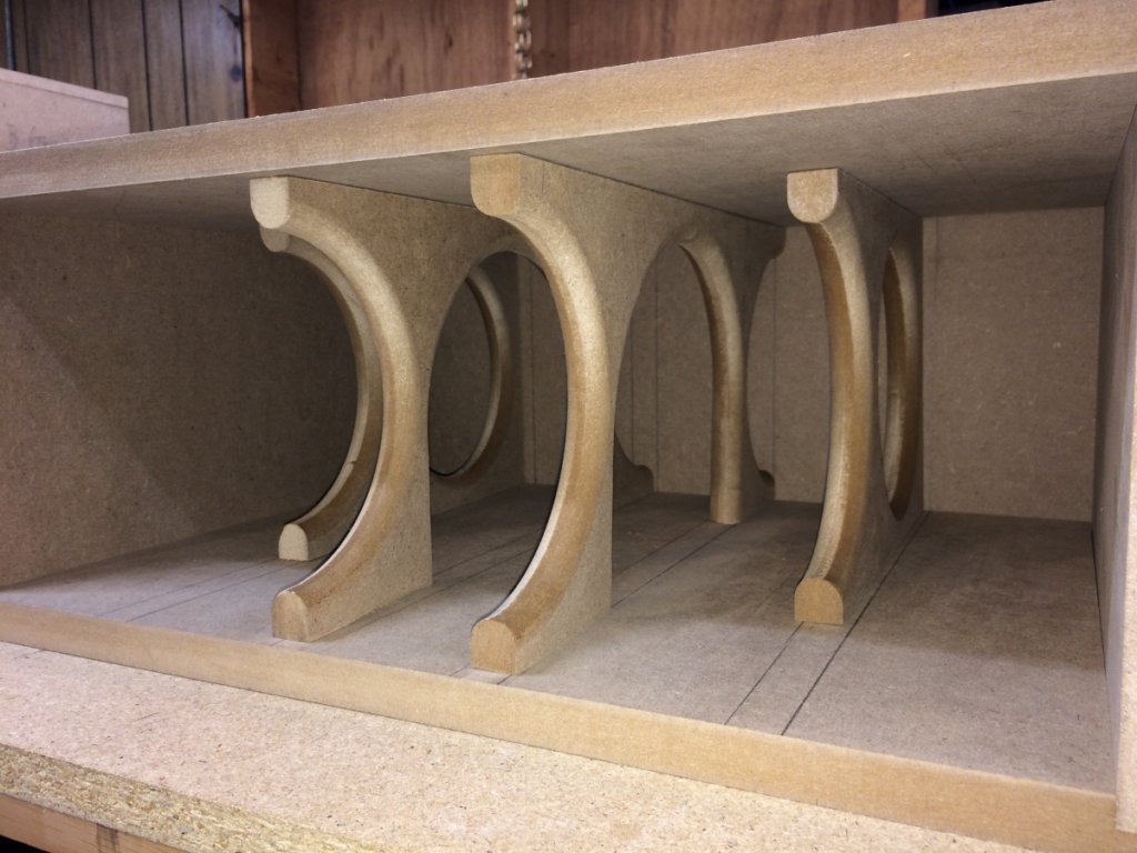

I went off script here with the smaller set of braces for the X-CS.  These are the same size as the respective braces in the X-MTMs I just finished, but in the X-CS design these are cut out more than in the MTM design.
It seems that the cutouts are for the crossover, but in other posts the crossover seems to fit within the spacing of these braces.  So, I went with the more rigid brace design the X-MTM uses.  I know this takes up a little more volume inside the cabinet, which will slightly affect the low end response.  However, given this is to be a center channel, where low end is less important, I expect this will be acceptable.  I will wait to glue these in to make sure the crossover fits.  These can be easily modified back to the X-CS design if needed.
Braces fitted into the X-CS cabinet.
The modified (or X-MTM style) brace can be seen in the right side of the picture.  The front panel also has the layout for the drivers on it...

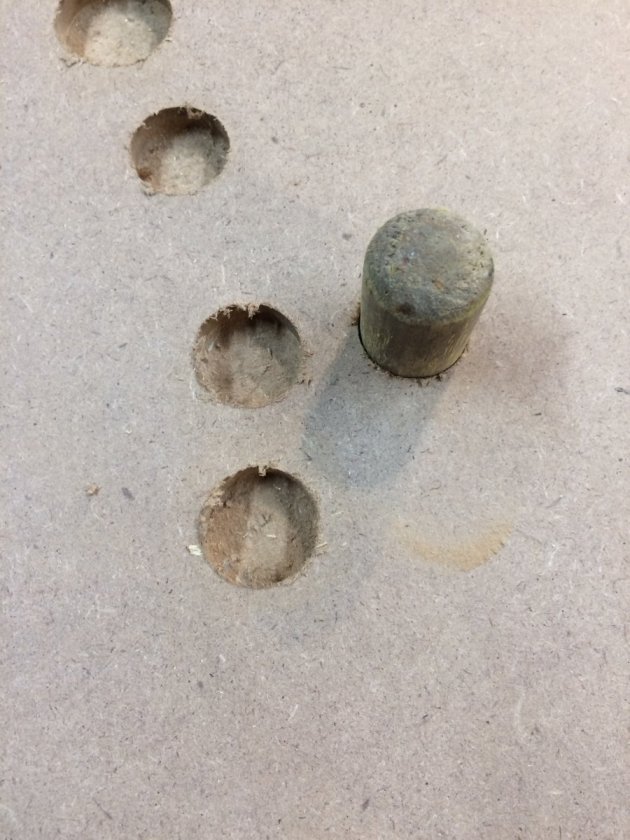

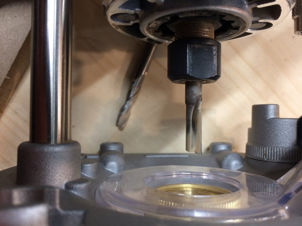

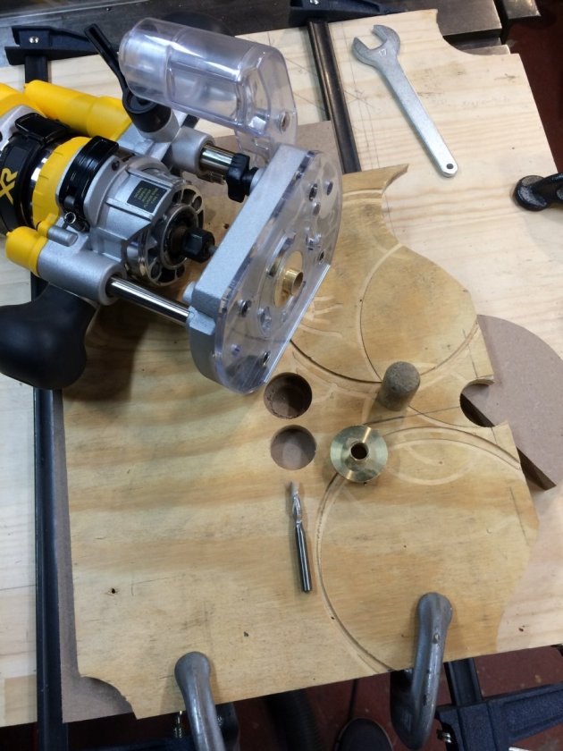

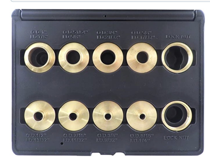

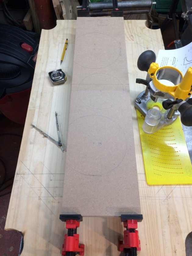

How hard can it be to use a template guide and router to make a small circular recess in a piece of MDF? :shake:
For some of us less talented people - 2 days... :dunno:
It is a good thing I am in the habit of practicing new things, even if they seem simple.  I have a nice set of template guides that I got while working on the X-MTMs and never used.  Here’s my chance to do something new...
I even figured out the math for selecting the right guide...
(template hole dia) - (guide OD) + (bit dia) =  recess ID....
So ...  1.25” - 0.625” = 0.625” + 0.25” = 0.875”
Perfect for the 13/16” dowel rod (otherwise known as an old broom handle) I had laying around.  Just enough clearance for the PL adhesive, as Peter recommend.

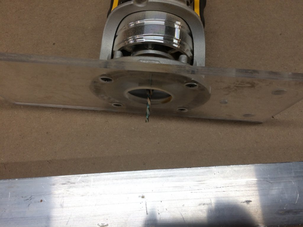

Day 1 and an hour+ of practices.  You think I could get a recess that the dowel could fit into?  No.   :icon_twisted:  Do you know many times I checked my math?  How many times I measured the dia of the recess and the dowel rod?  I even tried a different combination of template hole and guide diameters, with no success.... :banghead:
My wife is a very smart person...  Much smarter than me.  Sleep on it.  It will look different in the morning. - She says....
Day 2 - Get the template out.  Install the guide in the router base.  New piece of scrap MDF.  Take another shot at getting this right.  Make my first pass and lift the router out of the way.  The recess is filled with MDF dust.  Not surprised as I saw this yesterday.  Vacuum the dust out and take one more pass with the router.  Take the router away and clean out the recess again.  Try the dowel... It fits perfectly...   :bounce:
What’s different?  Different day?  No, I never thought to take that second pass with the router when I was practicing the day before.  :duh:  It seems that the router dust was enough to interfere with the guide and template and it was enough to prevent me from getting the right diameter recess.  I had a vacuum attached to the router and was using an up spiral cutter, which I thought would be enough to keep that from happening.  But apparently not.
I actually went with a straight flute cutter as it made a smoother surface at the base of the recess.
I took several shots at getting a smoother edge to the recess, but I think it is just the “cheap” MDF I am using.
Not too worried about the edge as a little sanding will take care of that.  Dry fitup and a perfect fit.

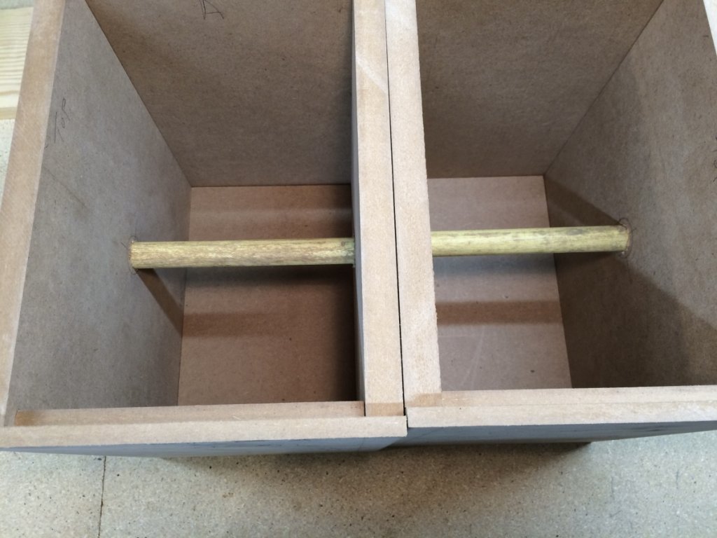

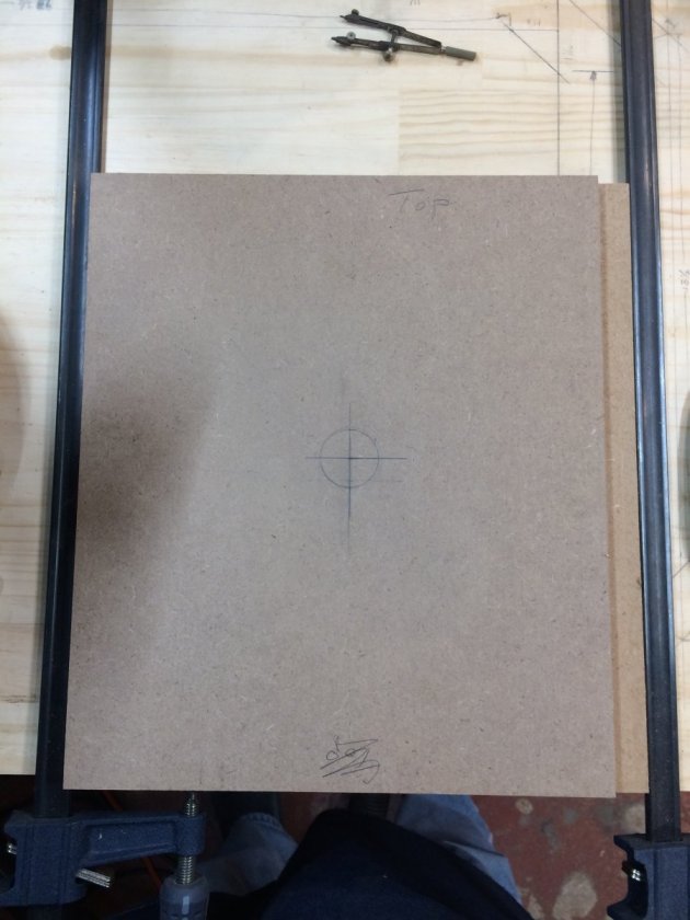

One of the things I did was to layout the location of the template hole on the side where the recess will go.
This provided me with a way to make sure the template is located correctly and that serves as a back check for doing the layout correctly.  The template is a match to the sides that the recess will be in.
I should also note that per Danny’s sketches this cross brace is a little higher than center in the bottom to top direction.  This makes the sides “handed” and they need to be installed correctly.
