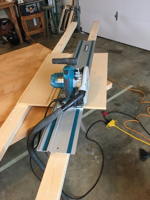

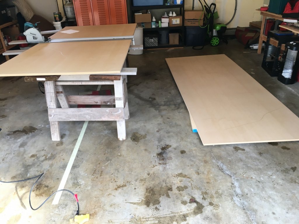

- Cut down the panels to usable size

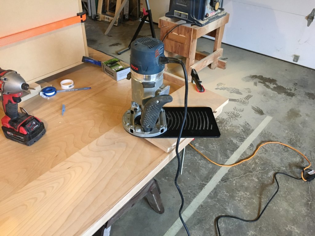

- Rout out the dados and rabbets before trimming out the parts.
Pic above shows one sheet that has the front, back, and sides of one MTM.  The sheet on the table is about to get the same treatment for the other speaker.  Top and bottoms will be rabbeted and cut out of the panel leaning in front of the first piece.  The braces and X-CS will be cut out of the sheets behind the dadoed sheet.

- When doing my initial breakdown of the sheets I wrote down one number wrong, it was a 1 instead of 11.  So...yeah, it was 10" off.  Not the end of the world but it forced me to revamp most of my cut list.
- Know and understand the difference between a standard cut and climb cut with a router.  Due to inexperience my first dado ran away from the fence.  Luckily it's in an innocuous spot and can be fixed.  After that I spent most of the morning making a more robust dado jig that ended up saving a lot of time and heartache in the long run.

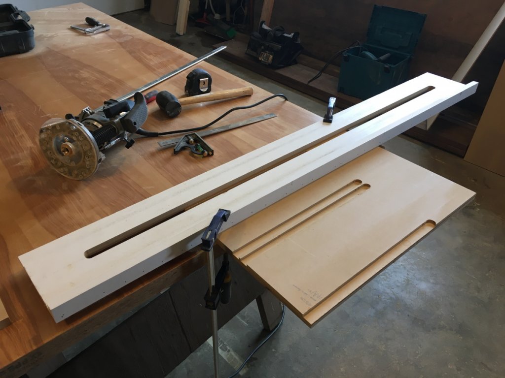

After using the dry assembly to determine the exact dimensions of the braces, I started cutting circles.  I went the quick route and actually bought a circle jig.  Worked great and turned out to be much simpler than I thought.
Once I got one of the big braces done, I just used it with a flush trim bit on my router table to make the other ones after using a jig saw to cut out most of the circles.  This worked very well and I was able to make quick work of the big MTM braces.  I still have the small braces for the MTM's and all the braces for the X-CS to do next weekend.

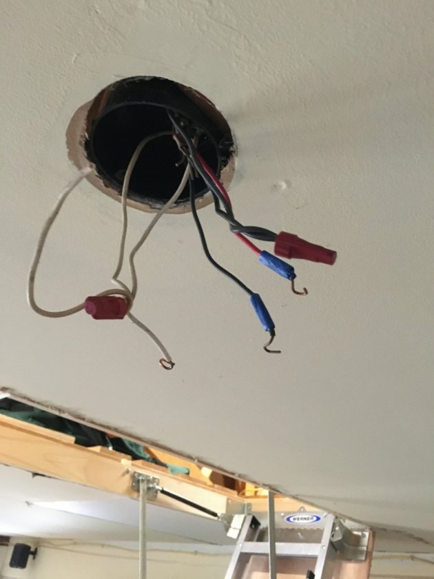

First step was upgrading my garage lighting which meant converting the old light boxes to hold an outlet.  It also meant completely replacing the light boxes since the old ones were too small.  I didn't plant for a trip into the attic this weekend, but there I was trying to pry a couple old lightboxes off the trusses.
The result, however, was well worth it as I could really see how dirty every surface in our garage is.

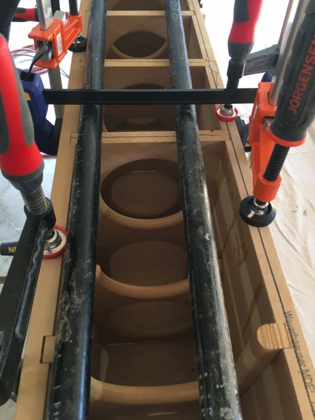

I started with the glue up of the top, sides, back and braces on the X-CS before calling it a night.  I didn't want to put in the bottom on the CS since I'm not entirely sure how big the crossover will end up and I didn't know how tough it would be to squeeze into there just through the front.
Next came one MTM this morning.  I picked up some Titebond 3 to use on the towers mostly because of the longer working time, but according to them it's stronger too.  Is it just me or is Titebond 3 runnier than Titebond 2?  I had a bear of a time with it on the vertical surfaces.  I've never glued up anything that big so I spent quite a while juggling clamps all while trying to keep surfaces in contact.  Glue everywhere.  I had 16 clamps on that bad boy and I probably could have used a few more.
All in all, a successful weekend even if I'm going to be spending some quality time with a chisel getting bits of glue off some surfaces next weekend.
Next steps are to get the 2nd MTM glued up, trimming, filling and sanding next weekend.  I've got some critical decisions to make regarding final look of the speakers before I get much farther.  I know for sure they will be mostly walnut with a danish oil/shellac finish.  I should be getting the walnut this week some time, so at that point it's just waiting on getting the guts from Danny.
Things I learned/opportunities for improvement/screwups:
- You know, you can never have too many clamps.  I feel more people should say this. :lol:
- I did make every effort to cut the fronts, backs, tops and bottoms oversized so they would sit proud of the sides for trimming.  I was mostly successful but after glue up there are a couple spots where I'm going to need to fill in order to have a smooth surface for the veneer to bond to.  Perhaps next time I go to 1/8 over rather than 1/16.

Sorry to read that the fitup after gluing wasn’t as good as you wanted.  This was something I worried about during my build and I did some practice pieces to try to figure it out.
While I wasn’t quite as worried about having everything oversized, I did want the fitup to “sit proud” as you say.  I cut everything between 1/32” and 1/16” over and it came out that way after glueing.  I am going to offer a guess that the glue was starting to setup while you were in the middle of clamping and you didn’t have enough clamps (seriously) to draw the pieces together.
I think that's definitely part of it.  The other part was my clamp juggling as I noticed that the pieces weren't coming together like they had previously.  I felt I had enough on my dry fit as everything was sitting proper, but I think adding the glue made it tougher to draw the pieces together and during some of that struggle a couple of the joints had already started to set.
As I said yesterday, this is by far the biggest glue up I've ever done, and I feel the number of complications are the square of the number of joints ( C=J^2), but that's probably just inexperience, and needing more clamps.  If we throw clamps into the formula, then we get this:
