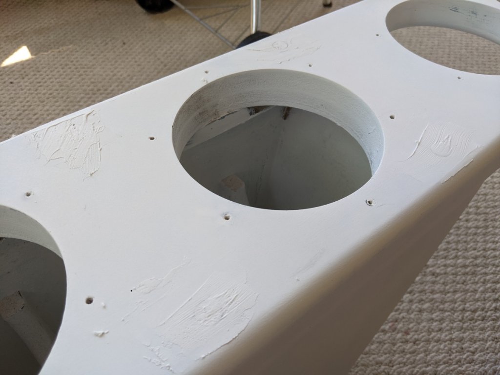

Been slowly plugging away at these, mostly filling, sanding & priming ad nauseum. And now that im back home, time to get some more work done.
Hoping to have these done before the end of the month.
I finally came up with a plan to hide the 6 mounting screws on the AV123 cabinet without removing them outright.
The heads of the bolts are 1/2", so I used a 1/2" drill bit to countersink the bolts a little further into the cabinet.
Worked like a charm! 8)
So far, I just puttied over the screws. just gotta let it dry, sand it flush, and finish with a skim coat and a lil sanding before a quick layer of primer.

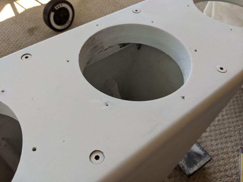

Okay! Between work, weather & such, I'm finally making some progress on these again. Mostly just sanding, refilling & sanding again, but i got a quick coat of primer on the AV123 tower.
Can't even tell the bolts are hidden in there~ :thumb:
Gunna wait for this to dry, and start working on cutting the norez for this cabinet and getting the crossovers mounted & wired up.

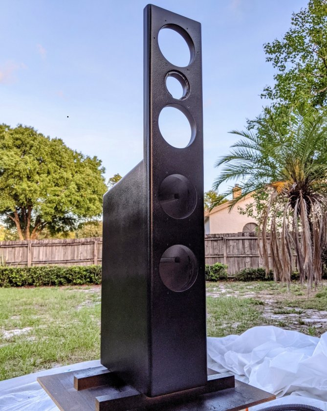

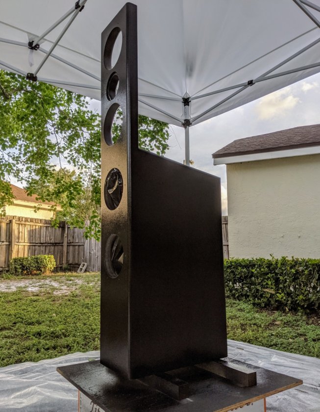

Got my first couple coats of black lacquer on!  :thumb:
Gunna let it sit out here for a bit to make sure it's properly hardened before I try to handle it and bring it onto the back porch.
Gunna give it a light sanding tomorrow and a couple more coats before I start on the 2nd cabinet.

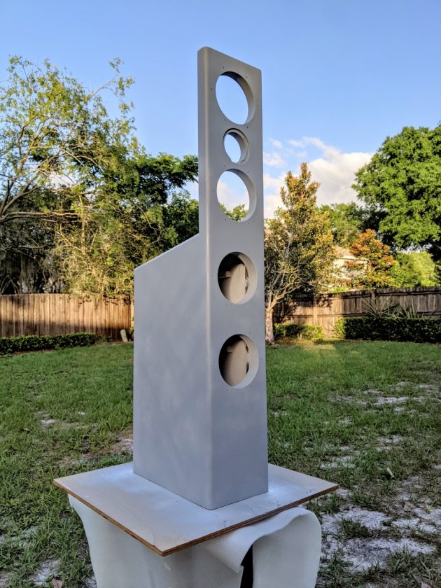

2nd cabinet has is first couple coats on!  8)
Ill do another quick coat in about 20-30 minutes, then it'll be left to cure overnight. Ill lightly sand it tomorrow and hopefully get it's final primary coat.
After that, it'll be down to clear coating both towers. And finishing the assembly! :thumb:
