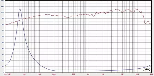

This F18 is available on Aliexpress, it is the ''old'' version,
the new version is posted on the Lii Audio site.
https://www.aliexpress.com/item/1005001403012788.html
He is his freq chart:

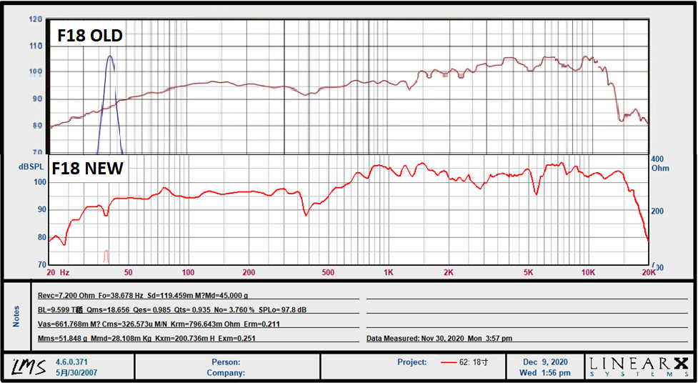

Here below is the current F18 version specs and freq chart:

Here is a comparative collage for your enjoyment:

New version looks better at the frequency extremes but more ragged.

Correct, seems both models have a hot treble what makes a sweet small tube amp recommended.
