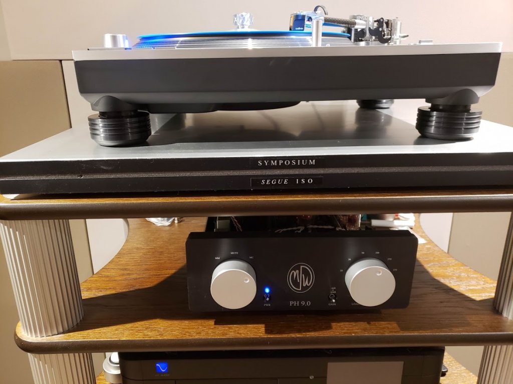

Here is a picture when I first received my unit

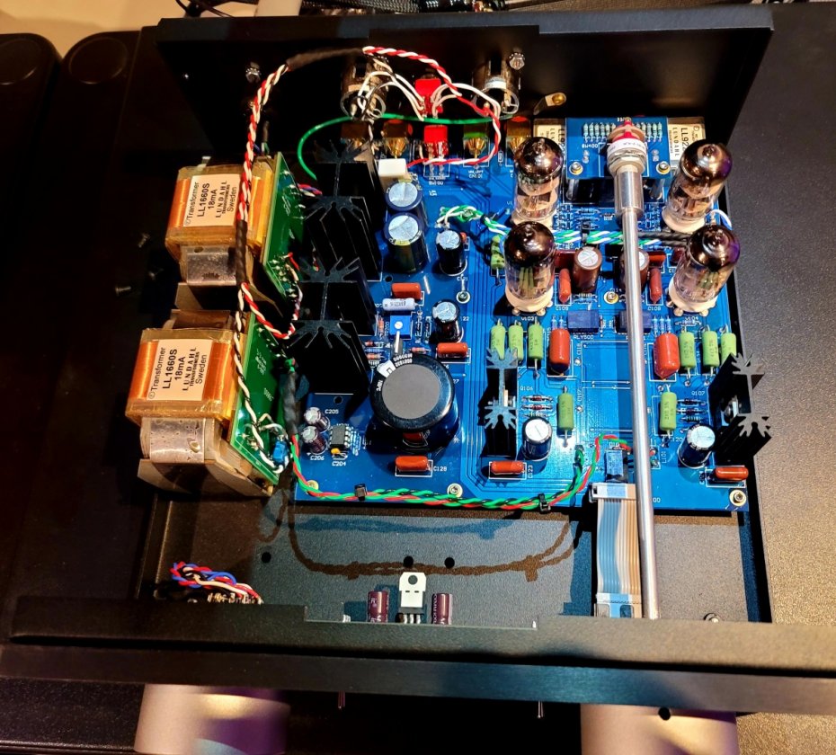

The New Modwright PH9.0X
Thank You Daniel Wright
First impressions clear as a window

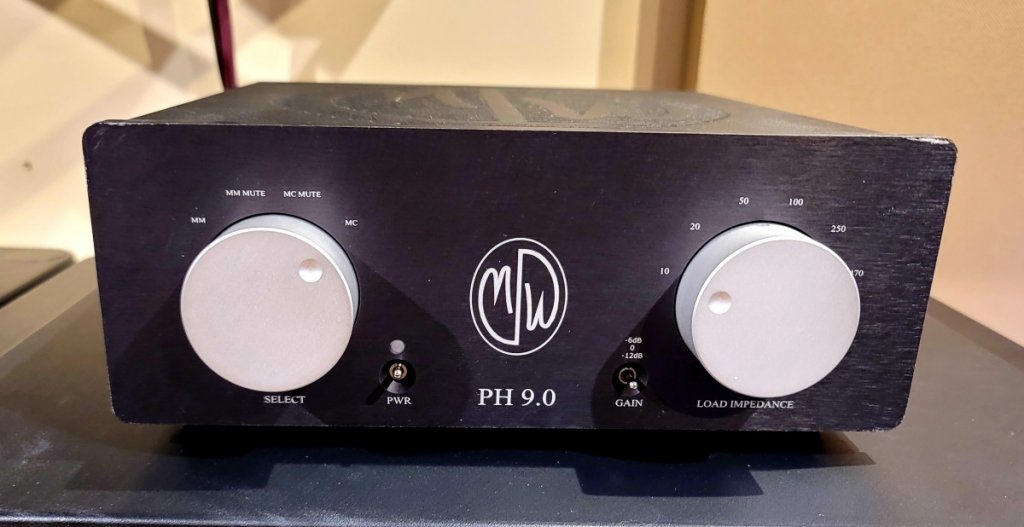

jtsnead
