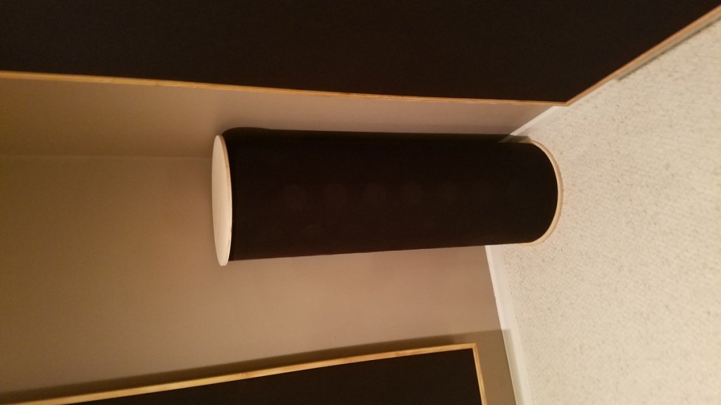

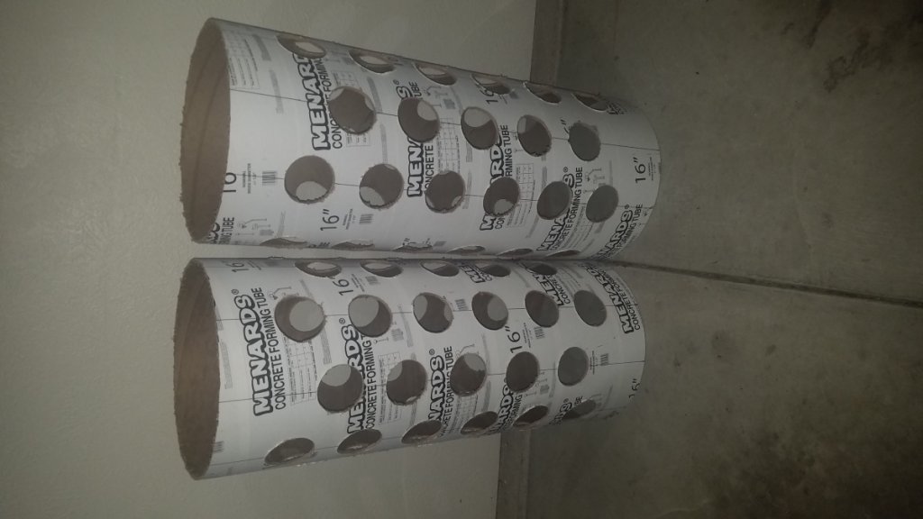

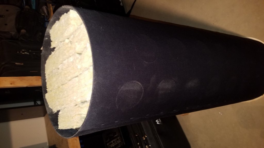

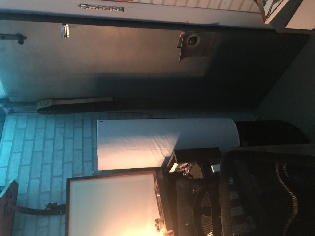

Wanted to share photos of my own tube trap design. I used round concrete forms from the local hardware store. I drilled 3-1/2 inch holes around the form, covered it with black speaker fabric, stuffed it with sound absorption material and then finished it with wood end caps. These provide both diffusion and absorption. So far I am pleased with the results.
Sorry for the sideways images. I could not figure out how to rotate the images.

The look great!  How's the performance sonically?

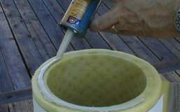

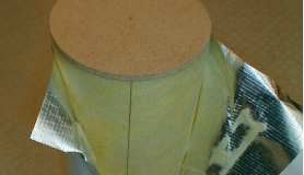

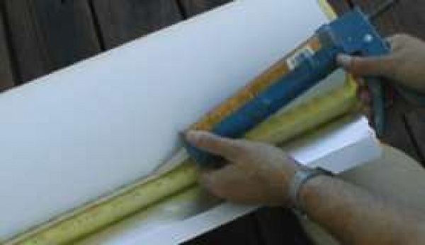

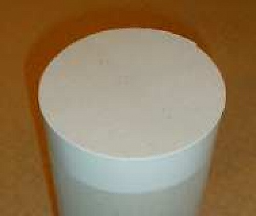

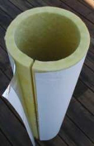

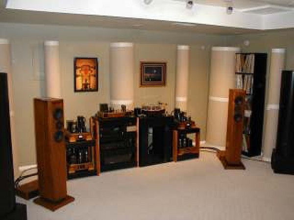

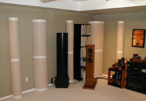

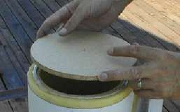

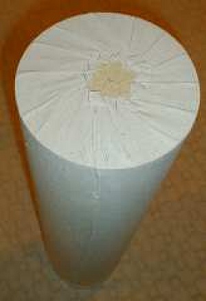

Grabbed these from a site a long time ago - sorry no text and wish I could credit the poster
picture quality is lacking as they d/l smaller and I made them a little larger for posting here. They are made of pipe insulation of which the distributor had when I made my OC 705 absorbers way back when.
HTH
tull skull
  • Posts: 319
  • I can't send hare in search of anything!
Re: Any ideas for DIY plans for tube traps
« Reply #14 on: 15 Jul 2021, 07:37 am »
I think those pictures are from Chris Brady, the guy that produced the Teres turntables. He had a lot of good info on there. Hope he is still around.
