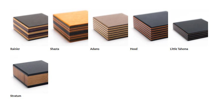

I found a layered product that appears very interesting, but I don't know how well it would work for speaker cabinets. Anyone familiar, or have experience with Richlite?

I've seen the solid Richlite countertops made of paper and phenolic resin, which are quite expensive and heavy, on par with quartz and granite.
This new countertop material Stratum, consisting of a Richlite and Plyboo sandwich, I haven't seen before, but it's also probably too expensive for large speaker cabinets.  I believe a 4' X 8' X 1" sheet retails for ~ $1300 and weighs 206lbs.
1" thick prototype samples are available directly from Richlite in 1' X 1' or 2' X 2' at $72/sq. ft.
Stratum is just one of Richlite's Cascade Series of layered products.
Ouch. That is expensive. I'd still be tempted to use it for the front baffle of a two-way monitor or stand-mounted three-way.

…Richlite...
I believe that is the material the fellow is using for the TAD 1601 monster miniOnkens i designed for him.

Richlite was mentioned earlier as well, my countertop fabricator gave me a piece to play with.  He cuts it with diamond tooling, I tried it with carbide, which I doubt I'd do again. It's incredibly hard and cutter life would be shortened significantly.
