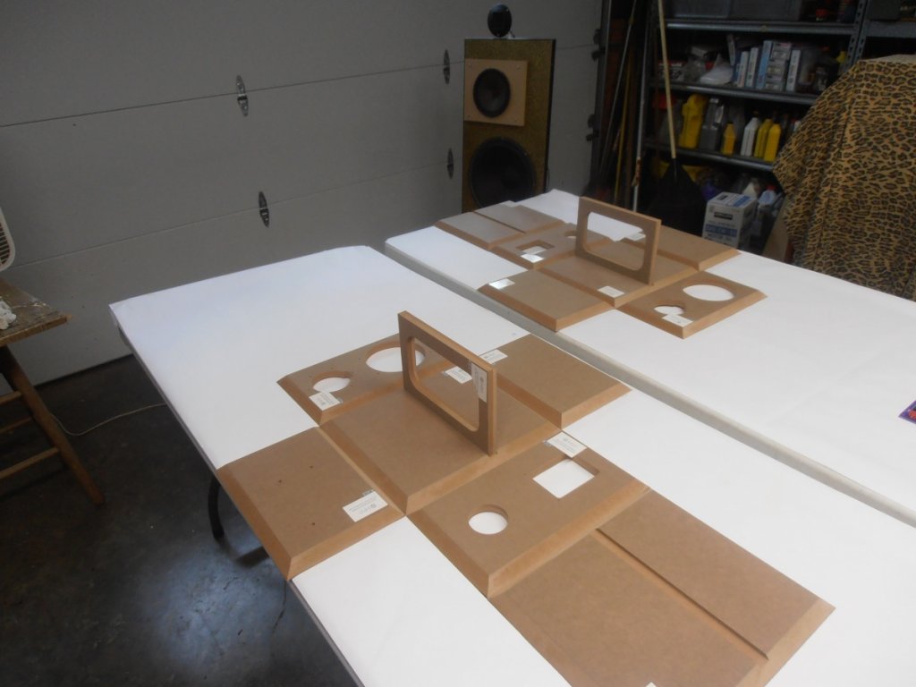

« on: 1 Oct 2020, 10:26 am »

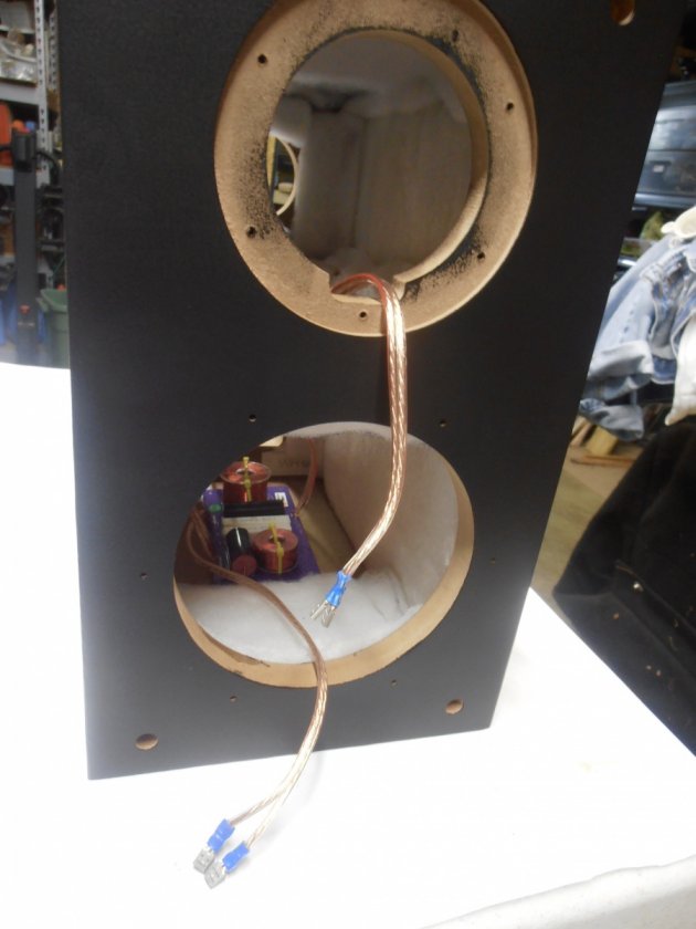

The Swans are high quality easy DIY's that put those PE kit speakers to shame. There are several videos on their construction which can be completed in a couple of hours not counting glueing time. Unique in that the 3/4" MDF is cut in 45 degree angles so that all edges fold inward.

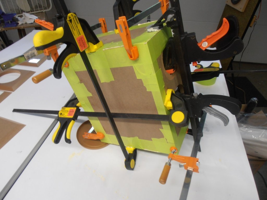

« Reply #1 on: 1 Oct 2020, 10:31 am »
Green tape is used to keep the glue in check. Clamps aren't used in the videos but I used them with light pressure.

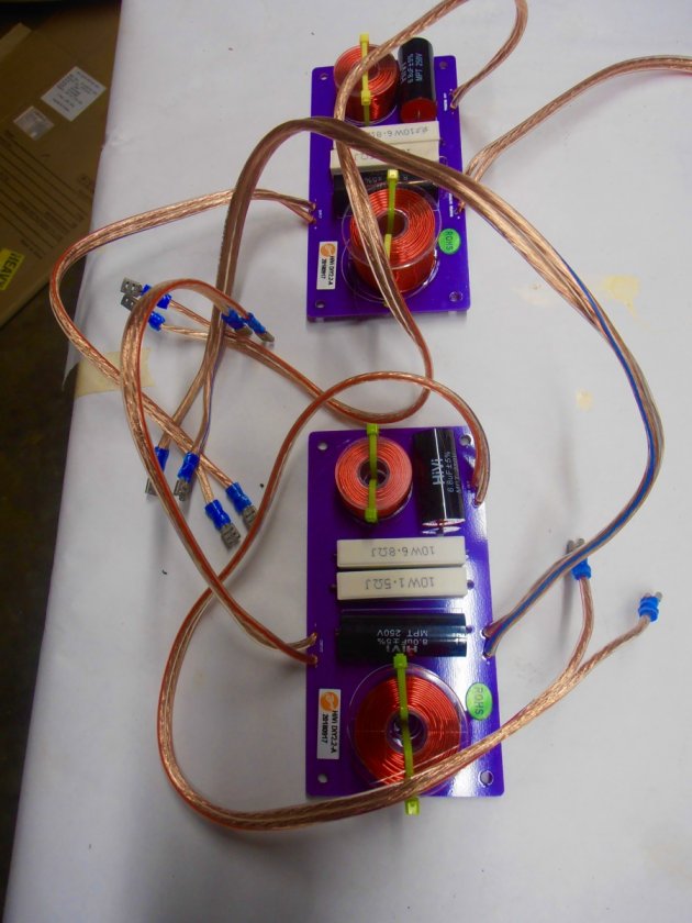

Good quality crossovers with diagrams on the board to show where components go. Easy soldering to the traces on the underside even for ham fisted guys like me.

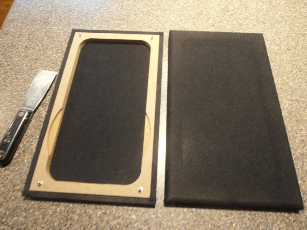

« Reply #4 on: 1 Oct 2020, 10:48 am »
The kit comes with grills and stretchy cloth that tucks into grooves with a putty knife. I would recommend them to help protect the protruding fabric dome tweeter that's very fragile.

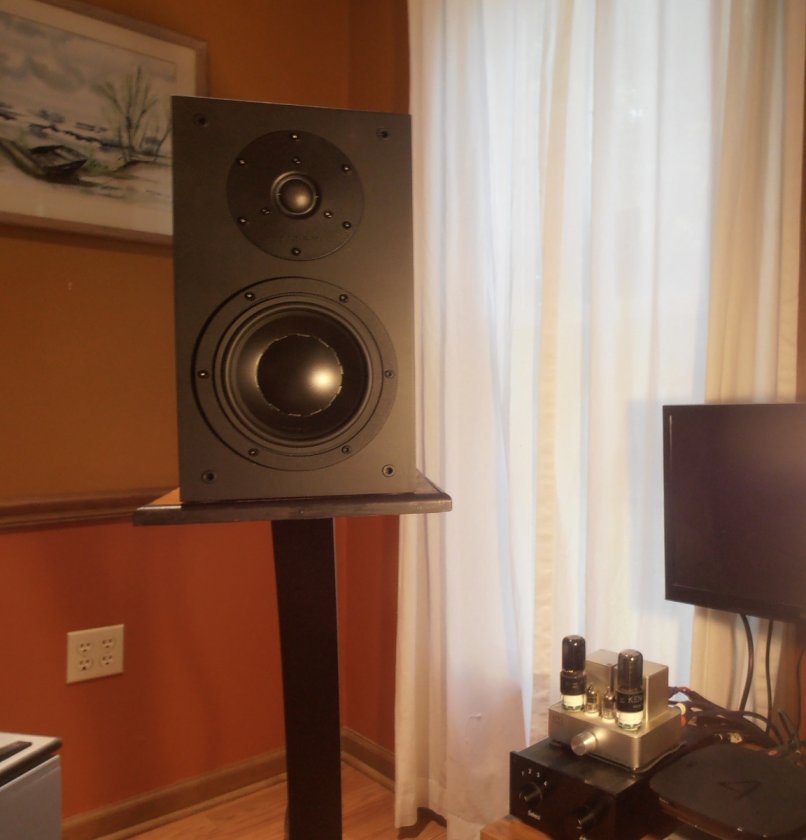

« Reply #11 on: 11 Oct 2020, 12:22 pm »
With grills on and a new stand top plate.

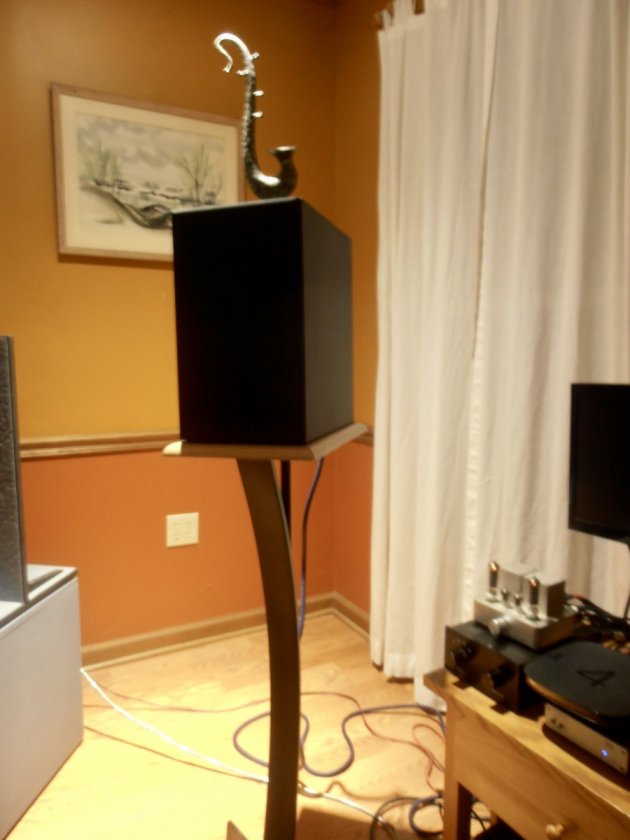

Poultrygeist
Re: Swan HIVI 2.2a shockingly good at $239
« Reply #12 on: 11 Oct 2020, 12:25 pm »

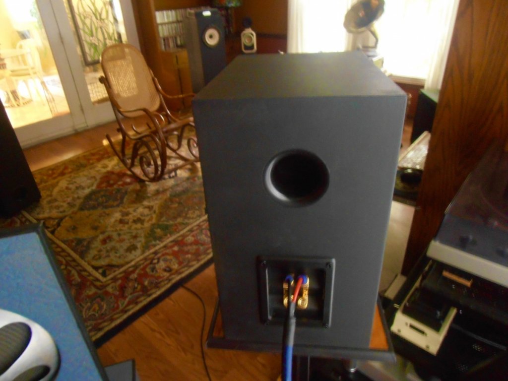

Poultrygeist
« Reply #13 on: 11 Oct 2020, 12:26 pm »

Poultrygeist
« Reply #15 on: 11 Oct 2020, 02:41 pm »
I noticed both kits are sold out.
So how do they sound? Any brightness to distract from one's enjoyment?
Michael
No brightness but very smooth and detailed. That's what I'm hearing when paired with flea watt single ended tube amps. Source is the Node2i streaming Amazon HD through a Schiit MB. Diana Krall in the Ultra rez selections literally brings tears to my eyes. I only listen on 37.5 inch stands in near field which is what the Swans were designed for.
