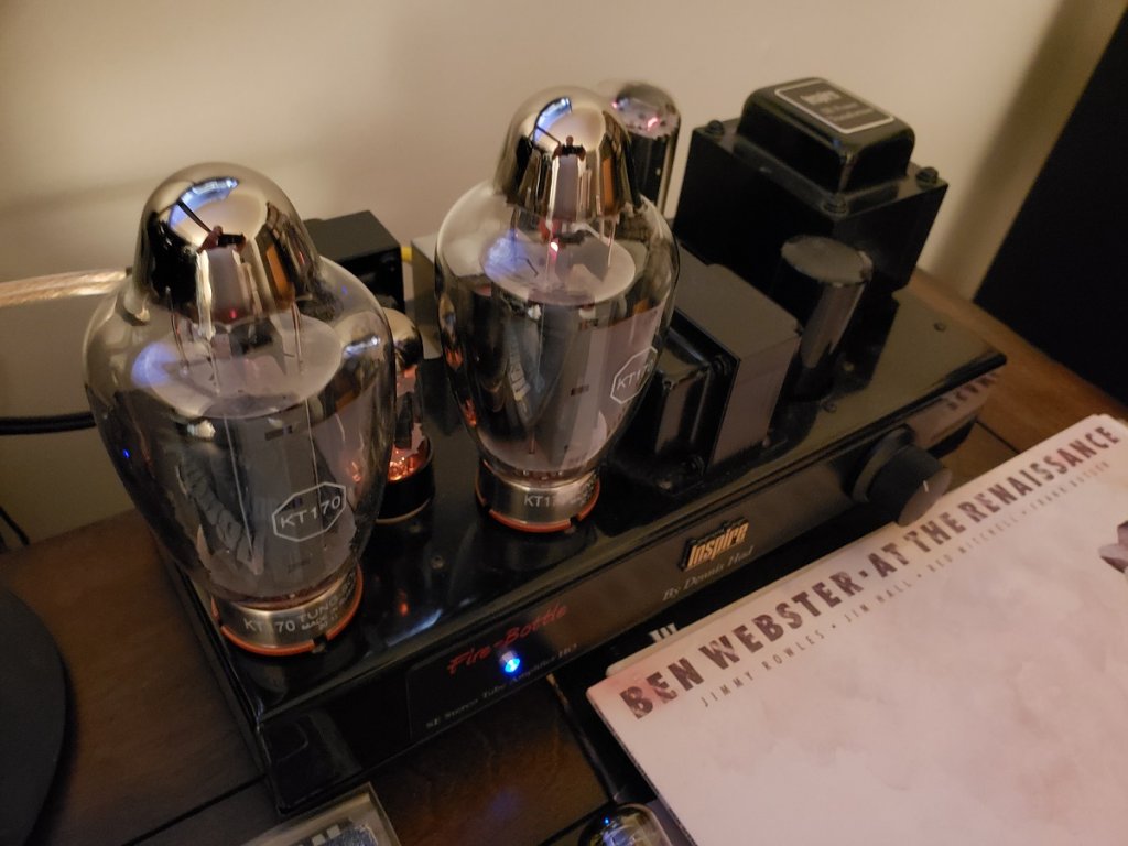

Hey Tubefly, I'm running some KT170's and they're really nice.

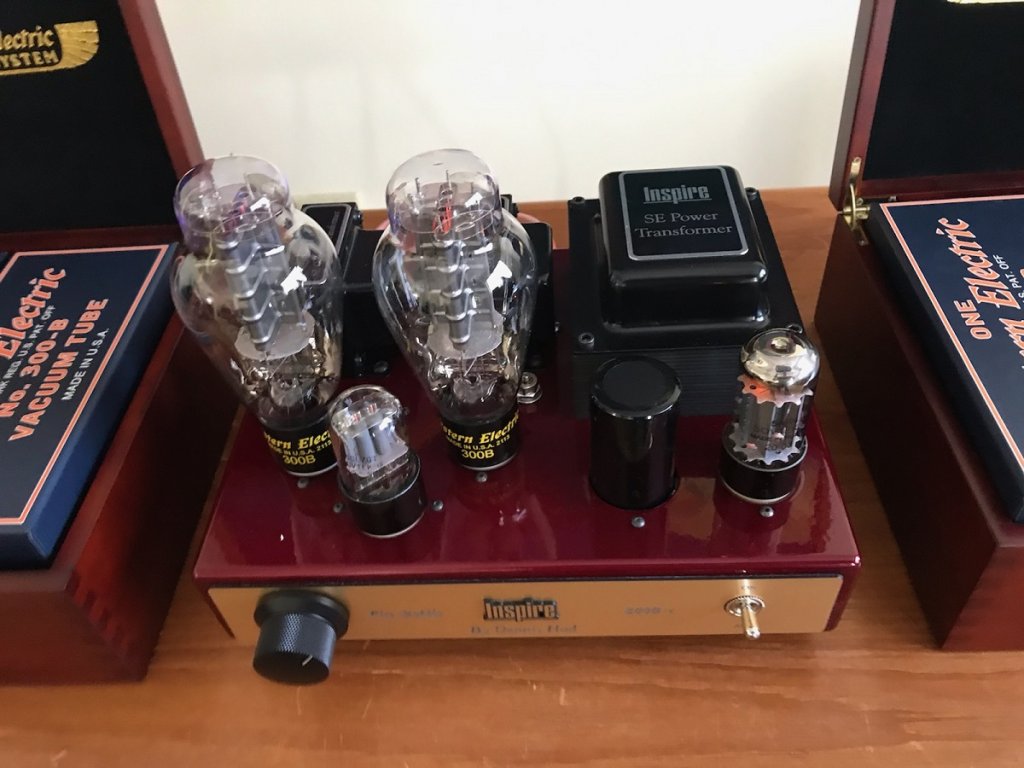

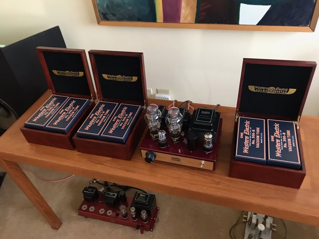

Here's some pics of the new 300B amp.

I must say I agree Straitwire. The KT-170's are sounding wonderful in the SE HO. Very nice deep bass, and clean, detailed and smooth.

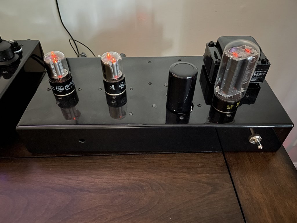

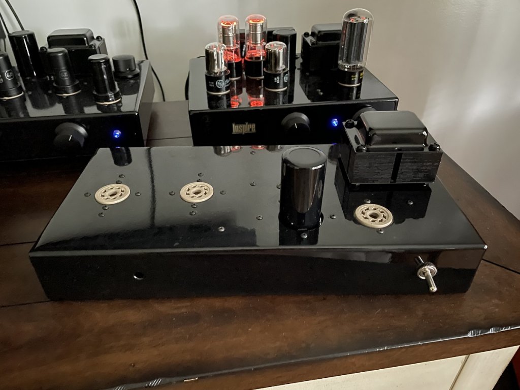

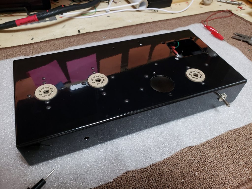

Working on a phono preamp.
 Built a prototype on an LP-3 chassis and put in some voltage regulator tubes for the heck of it.
The production prototype chassis is smaller and configured differently without using VR tubes.
