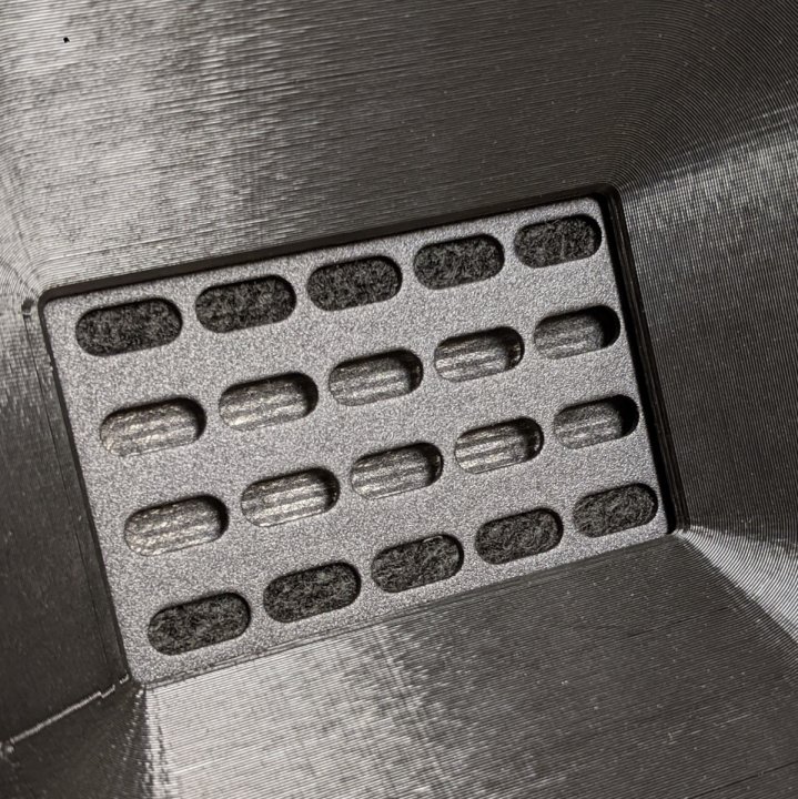

It was a nice cool overcast day, so I did my testing outside, but noticed the tests weren't as clean as thry should be & slowly getting worse, when I looked at my GRS driver, I think the heat from the sun softened the diagram or the foil adhesive too much, shifting the traces away from the center...
It's leading to a lot of heavy distortion. Along with a loss in the upper mid range from 4K-10K.
Before:
After:
So if you plan to do testing outside, keep it in the shade!  :nono:
Even my Neo3 shows signs of the same problem, tho because it had far less testing its not nearly as bad of shape..

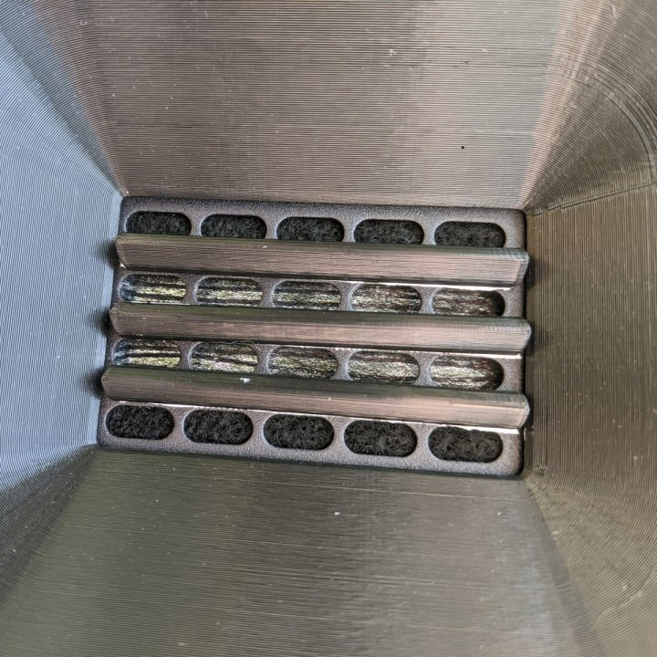

On the better hand, I did get some interesting results from using the plastic rods. Having 3 tall rods (as seen in 2nd pic) causes a MASSIVE hole in the response around 8K hz, it's caused by the outer two rods. However, the inner rod actually allows for a small 3-5db rise in the 18-20K Hz range, without the drop at 8K.

Hoo boy it's MUCH WORSE than I thought...
I opended up the GRS-3 to find this:
The diaphragm is absolutely SHREDDED. :o
I'm guessing the heat & higher output absolutely destroyed the driver... Bummer.
I'm guessing the Neo3 is going to look the same, but to a lesser extent.. *sigh* lol

Danny Richie
Re: GRS-3 vs Neo 3
« Reply #66 on: 30 Sep 2020, 06:43 pm »
I'd say roughly hour & 15 minutes or so judging by the time stamps of the tests I ran.
And that is why we use Kapton film on ours instead of Kaladax.

It looks more like power got them as there looks like 3 burn places in the voice coil metalization, if I see the picture correctly.

That said, heres how it reacts with the faceplate rods:
Teal: Stock
Magenta: Outer rods only
Purple: Center rod only
Reminder: The tweeter was long ruined at this point, so once the replacement arrives, ill be re-testing the different rods to see if the differences percist/change.

They failed before I ever put the rods on. I actually only noticed the issue once I put the rods on. Even on a cloudy day with a light breeze, it was too much heat for the kaladex to handle under the stress of the movement.
I didnt use glue, I used thermal transfer tape intended for small heatsinks on small electronics.
