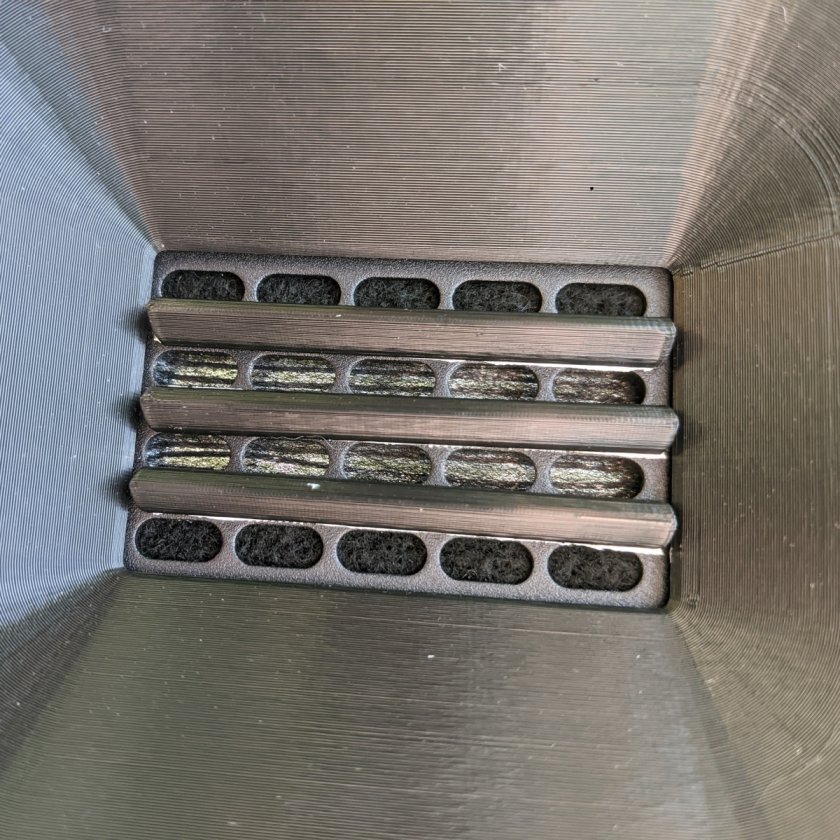

Some bad news..  :duh:

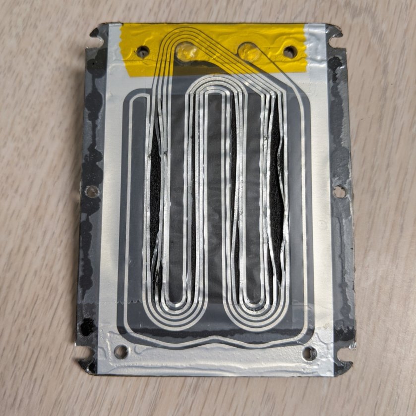

It was a nice cool overcast day, so I did my testing outside, but noticed the tests weren't as clean as thry should be & slowly getting worse, when I looked at my GRS driver, I think the heat from the sun softened the diagram or the foil adhesive too much, shifting the traces away from the center...
It's leading to a lot of heavy distortion. Along with a loss in the upper mid range from 4K-10K.
Before:
After:
So if you plan to do testing outside, keep it in the shade!  :nono:
Even my Neo3 shows signs of the same problem, tho because it had far less testing its not nearly as bad of shape..

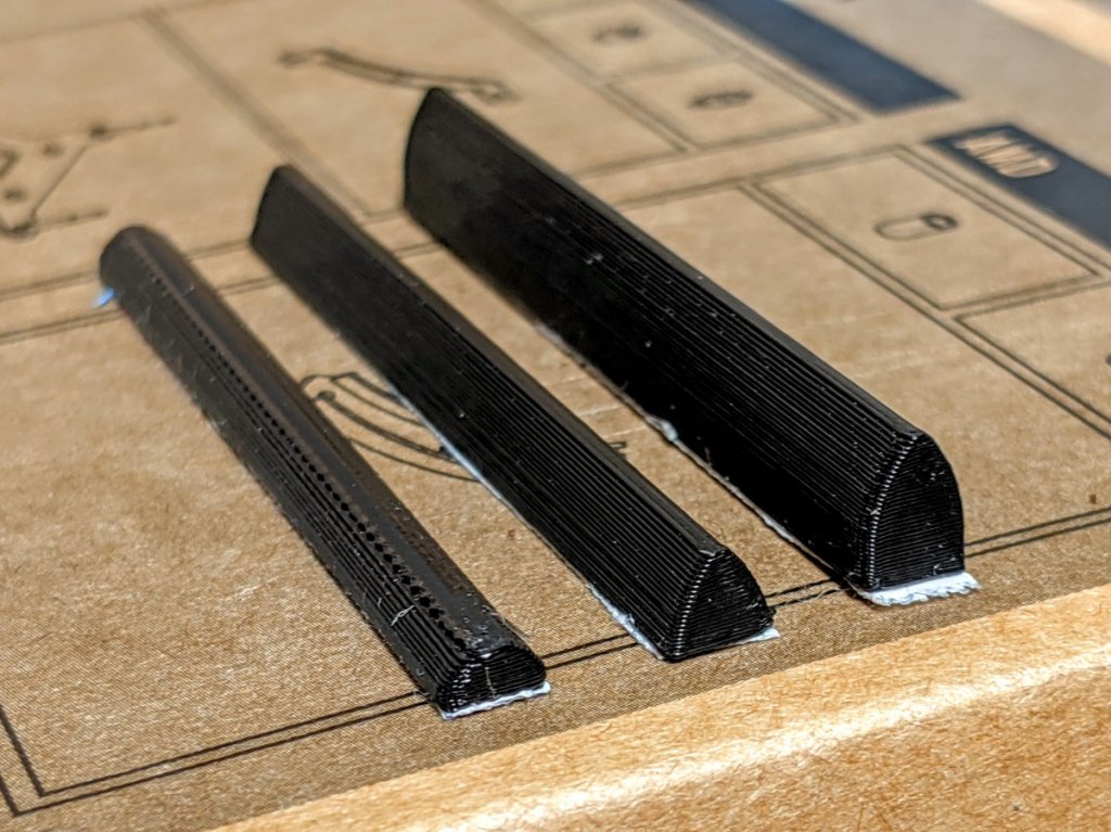

On the better hand, I did get some interesting results from using the plastic rods. Having 3 tall rods (as seen in 2nd pic) causes a MASSIVE hole in the response around 8K hz, it's caused by the outer two rods. However, the inner rod actually allows for a small 3-5db rise in the 18-20K Hz range, without the drop at 8K.

Hoo boy it's MUCH WORSE than I thought...
I opended up the GRS-3 to find this:
The diaphragm is absolutely SHREDDED. :o
I'm guessing the heat & higher output absolutely destroyed the driver... Bummer.
I'm guessing the Neo3 is going to look the same, but to a lesser extent.. *sigh* lol

And that is why we use Kapton film on ours instead of Kaladax.

It looks more like power got them as there looks like 3 burn places in the voice coil metalization, if I see the picture correctly.

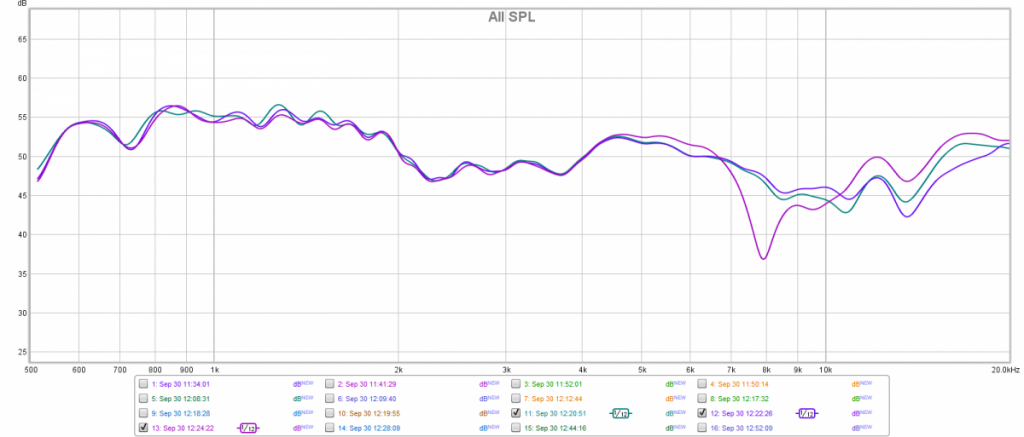

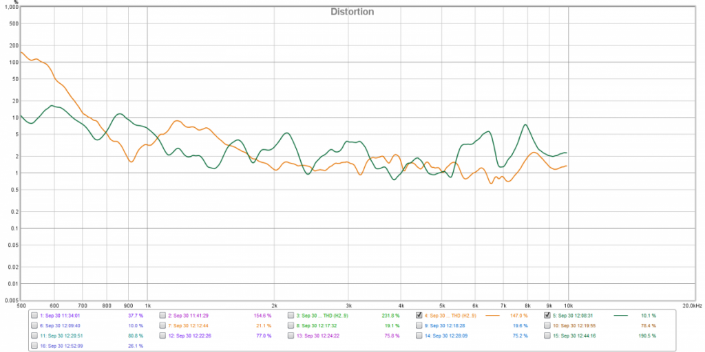

I finally got a chance to do a little more digging thru the results and you can see in the distortion graph where the diaphram failed..
Yellow: Good     Green: Failed
That said, heres how it reacts with the faceplate rods:
Teal: Stock
Magenta: Outer rods only
Purple: Center rod only
Reminder: The tweeter was long ruined at this point, so once the replacement arrives, ill be re-testing the different rods to see if the differences percist/change.
Couple of thoughts.
Could the rods be acting as insulators, preventing heat dissipation/cooling ???
If you used glue, could it have acted as a solvent weakening membrane ???
They failed before I ever put the rods on. I actually only noticed the issue once I put the rods on. Even on a cloudy day with a light breeze, it was too much heat for the kaladex to handle under the stress of the movement.
I didnt use glue, I used thermal transfer tape intended for small heatsinks on small electronics.

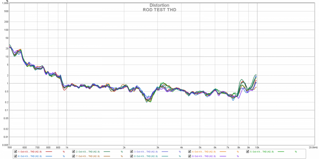

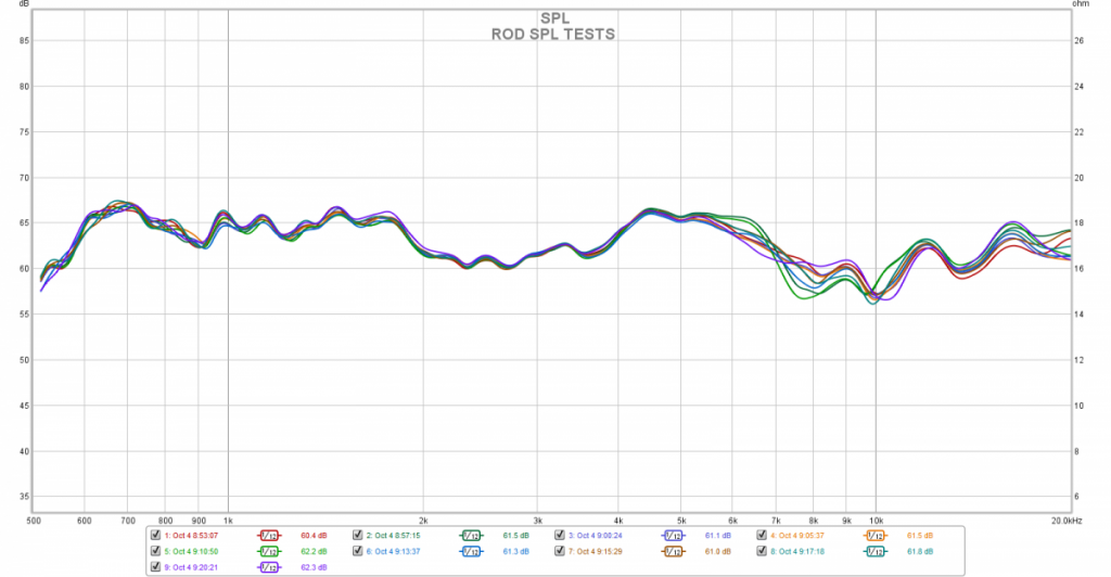

Finally got a chance to test my new GRS-3 with 3 different rod sizes.
Small round-overs, Medium and tall "waveguides"
Rather than post 1000 charts again I'll just be sharing the MDAT file for y'all to look thru. Each measurement is labeled in the notes section, with the last measurement being stock measurement.
MDAT:
https://drive.google.com/file/d/1EHCbDWIFV7KVVfvPiBZ49gwto_B2_DBd/view?usp=drivesdk
SPL
THD
It maybe the due to the differences in testing, but the SPL graph isnt as good as the previous sample, and measures more similarly to the damaged model? That said, the THD graphs are a lot more consistent, esp above 1K Hz.

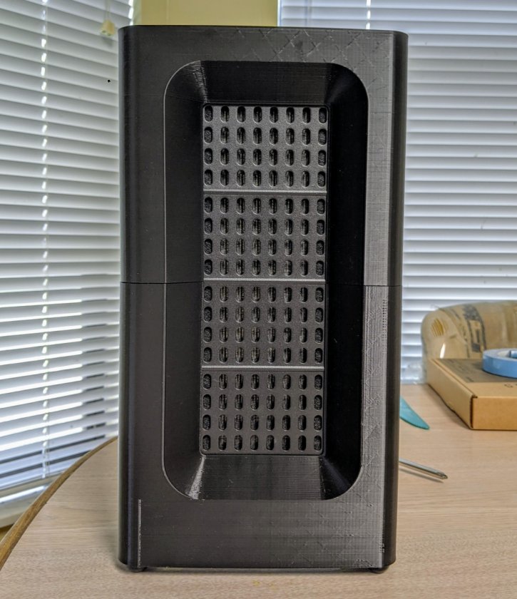

That said, I designed & am currently printing a "super-mini" clone front baffle for testing the GRS-10 (not able to include a mount for the GRS-3/Neo3 tho. Should be finished early tomorrow morning and ready for gluing/assembly, and I'll do my testing once the opportunity arrises, but i can't make any promises it'll be any time in the immediate future. Esp since I've also got my housemates schedules to contend with, on top of working everyday until Thursday when I leave for Dallas, TX.

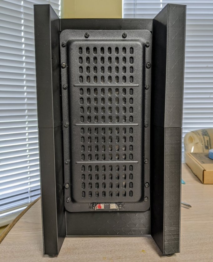

Print finished just as soon as i got home for my lunch break!
Its not perfect, but here's the rough test fit before i permanently epoxy the two halves together! :thumb:
Bonus is i can use tape/cardboard to create a faux side wing to match the original design. :D

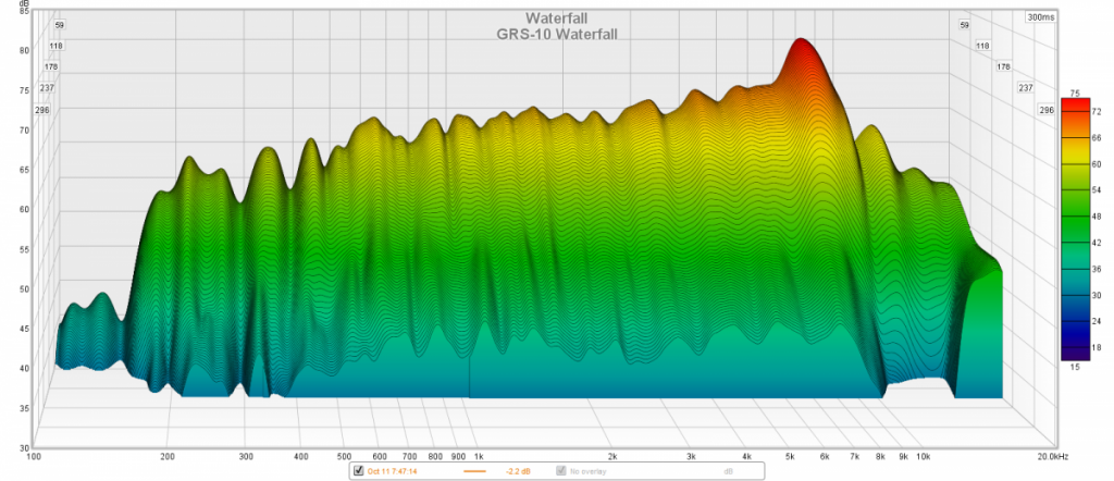

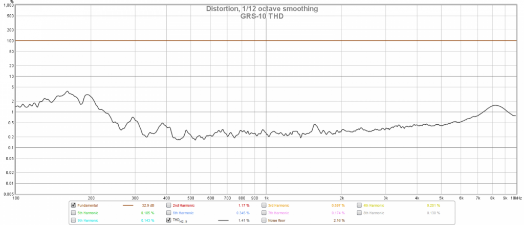

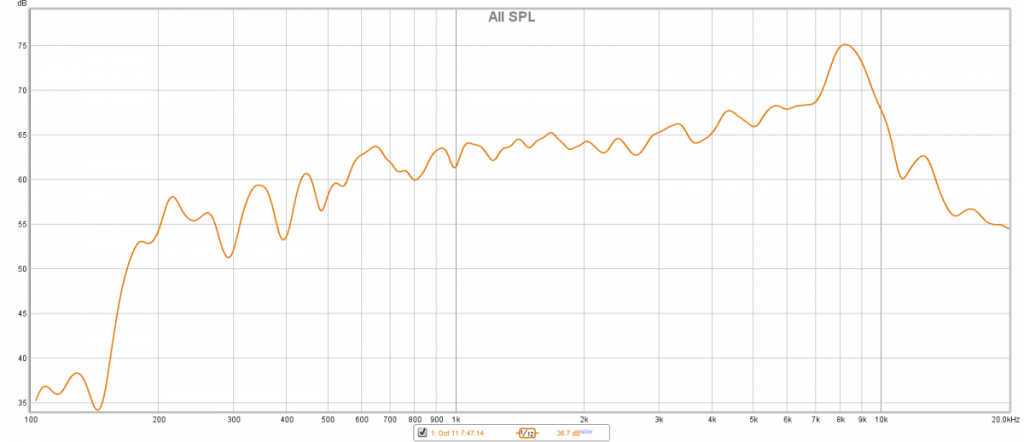

Here are some quick & dirty graphs i made this morning:
SPL:
THD:
Waterfall:
Ill post better ones after i get off work, cuz i know the waterfall & THD only show to ~500Hz
Okay! Graphs are updated! The distortion below 400Hz doesnt look good, but it also seems to be related to the fall or rise in SPL. Namely the dips at 300&400Hz and then down to 100Hz.
The next chance I get to run some tests, I want to attempt with addition of a side wing to see if it helps smooth out the response and helps extend the bass & reduce the distortion in those regions as well.
