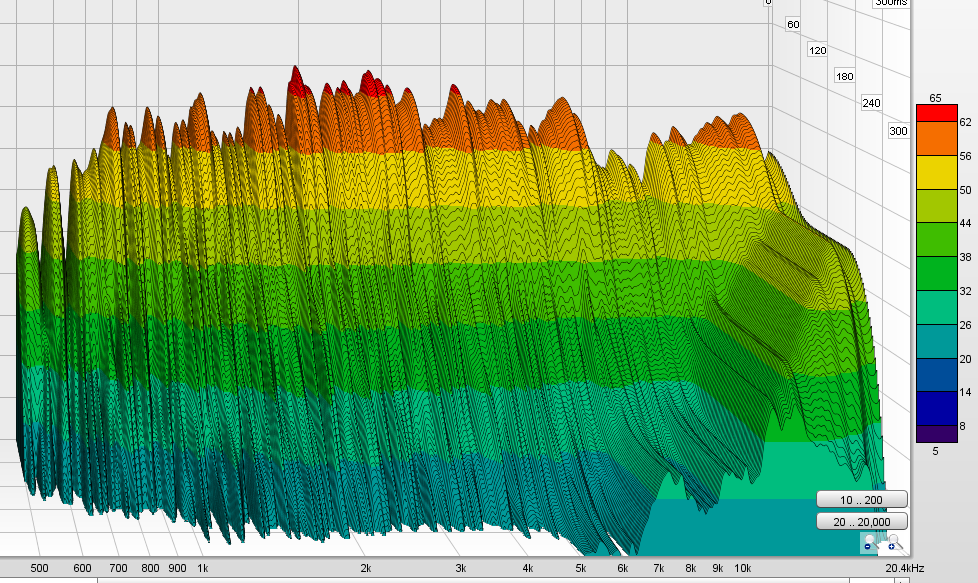

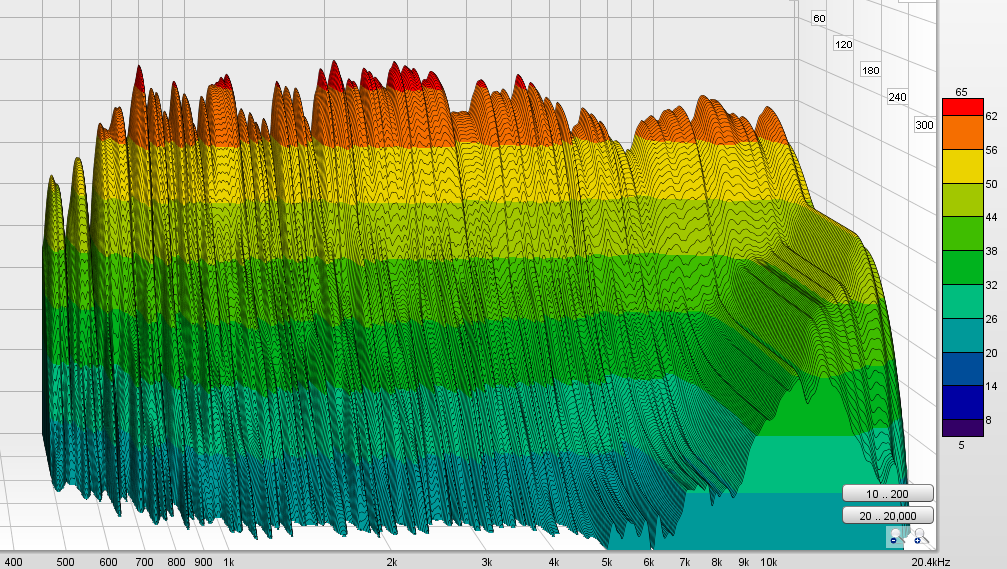

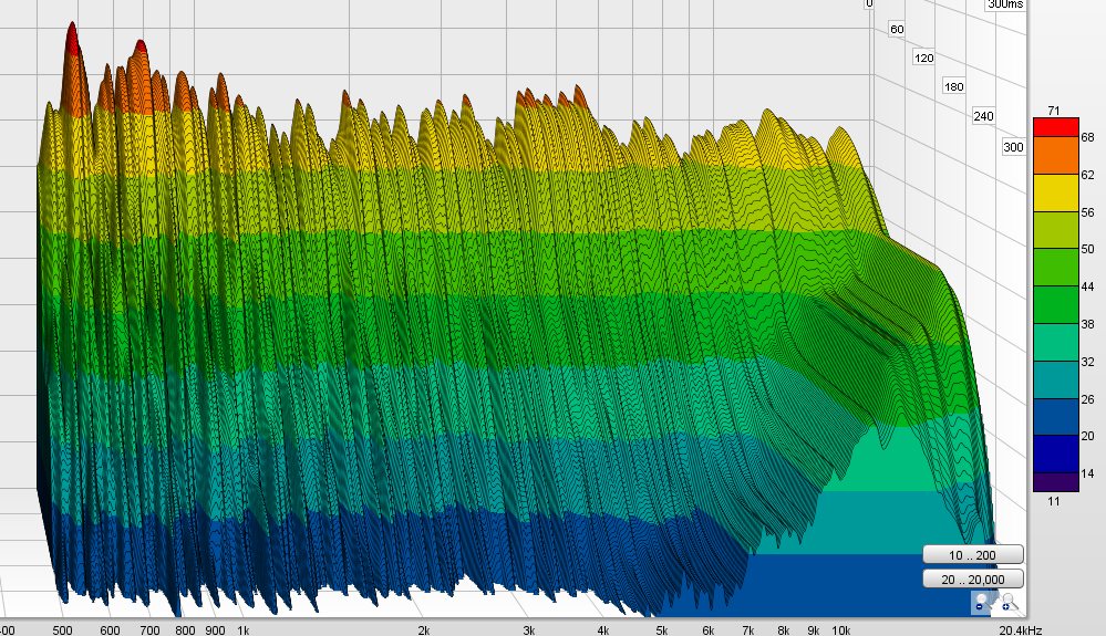

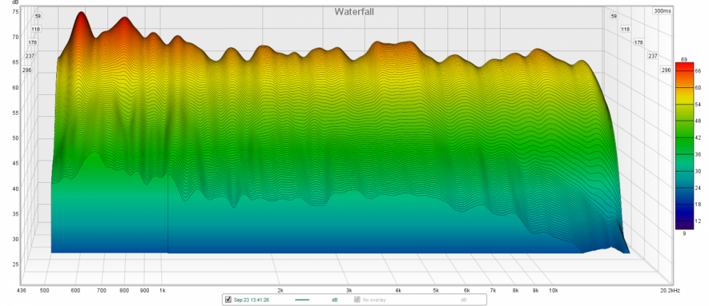

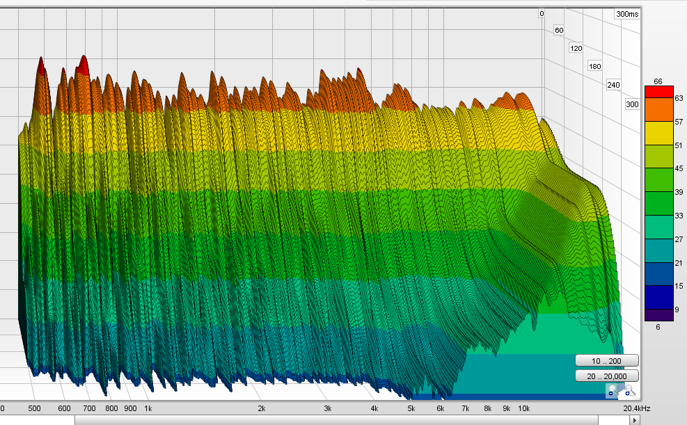

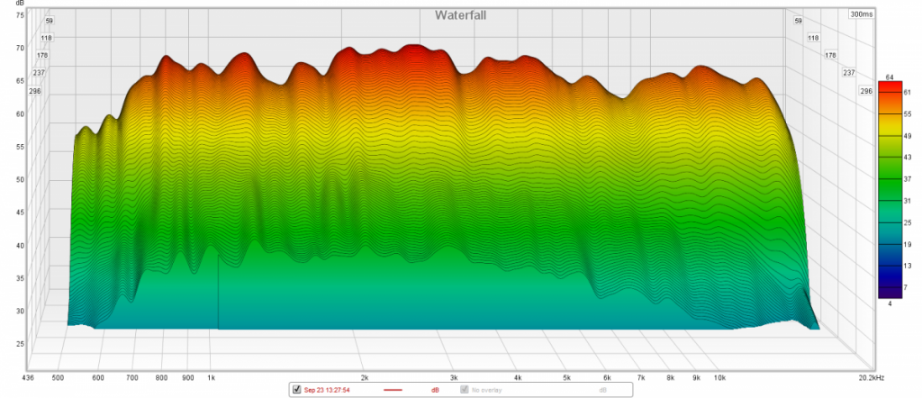

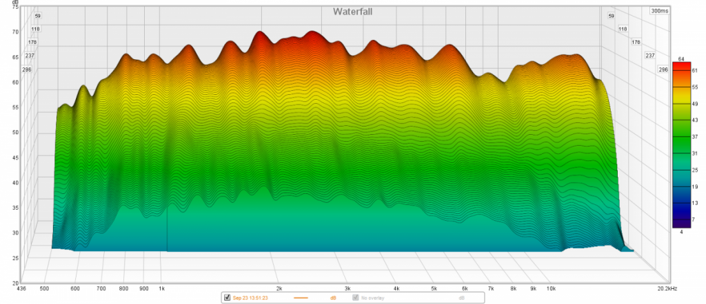

I wish I could get the same waterfalls as clio does, but they all still look really good. I'm not 100% sure why there's the extension in the upper ranges... I'm guessing that's from the other sweeps within the test?
Scale: 20dB-80dB
Neo3 OB:
GRS3 OB:
Neo3 Deep Cup:
GRS3 Deep Cup:

I've installed Danny's yarn mod into my Neo3, so I'll be testing that later tonight once one of my house mates is no longer asleep.
I'm genuinely curious how it will affect the results, since its mostly intended for better off-axis results.
I have most of Saturday off, which I'll use for more testing, likely near-field (~1 inch past the wave guide) & off axis, along with some different combinations of the taller plastic rods on both drivers.
I may also rerun todays current test results outdoors to help remove any in-room reflections.

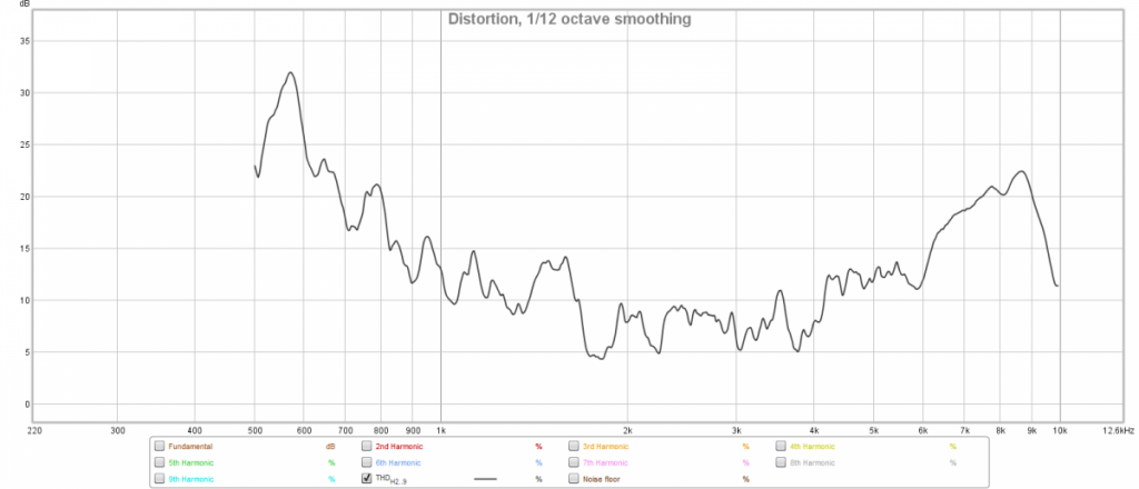

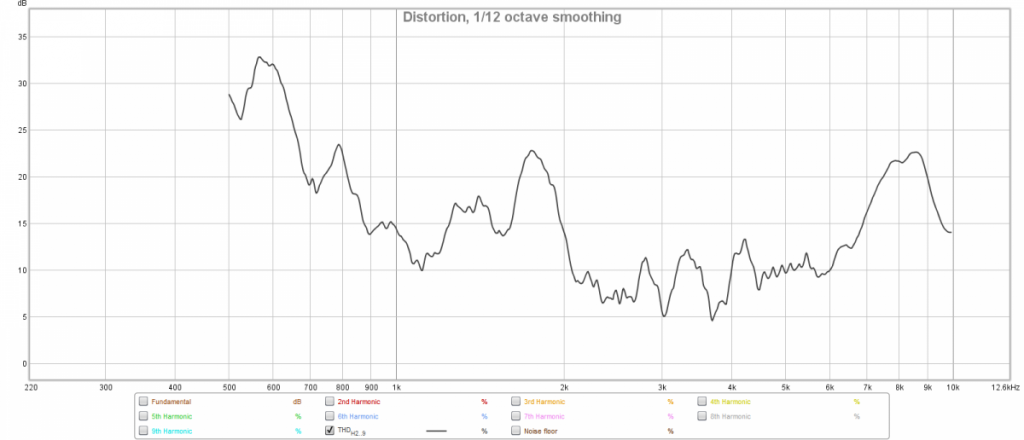

The ringing is due the settings I had the gated window open too long. Here's the adjusted graphs, that also have the smoothing set to 1/12 to make it easier to read.
Neo3 OB:
GRS3 OB:
NEO3 Cup:
GRS3 Cup:
And yes, the waveguide was used for all tests, with only the cup removed for the OB tests.

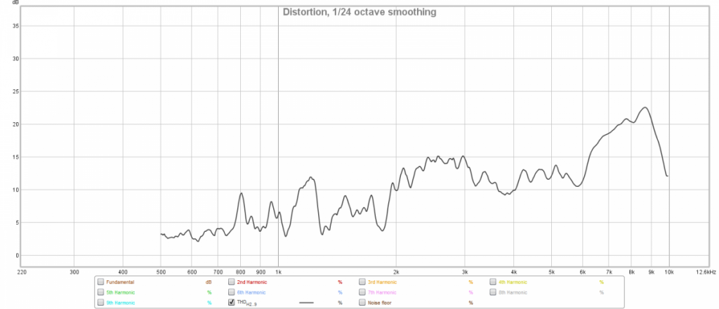

I downloaded the file mdat, and the GRS3 distortion from 1.2 to 2 kHz appears 10 times higher that of NEO3 in OB use ...
If my analysis is correct it is a great disappointment.
« Last Edit: 24 Sep 2020, 09:08 am by scararabe »

Yeah that 1.2-2K peak seems to persist in all tests, tho to be honest I'm not really sure how to read the graph beyond "lower is better" ?
I wouldn't call it 10x, but it might explain why mids sounded different between each model.

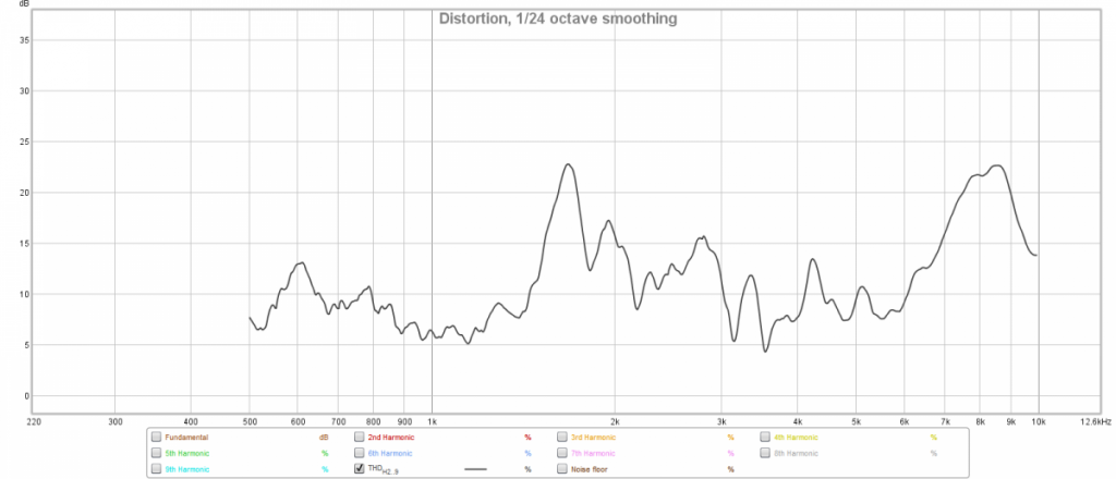

Here's the graphs for Total Harmonic Distortion for anyone interested:
Neo3 Cup:
GRS 3 Cup:
Neo3 OB:
GRS3 OB:
emailtim
Re: GRS-3 vs Neo 3
« Reply #28 on: 24 Sep 2020, 03:01 pm »
If you change the scale from dB to Percent, you can see the distortion at
1.8kHz ranges from [0.2% to almost 2%, @ 10X] and at
570Hz ranges from [0.13% to 4.3%, @ 30X].
Distortion appears highest for OB/without the deep cup for both the Neo3 and the GRS clone at the lowest frequencies.
The hump at 1.8kHz is the GRS clone with or without the cup.

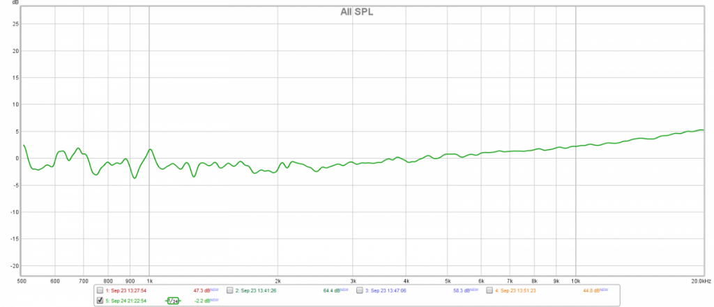

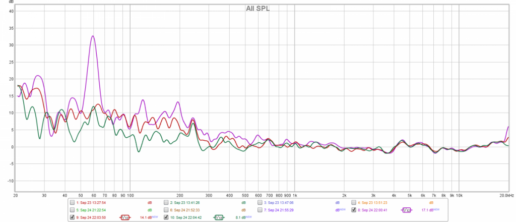

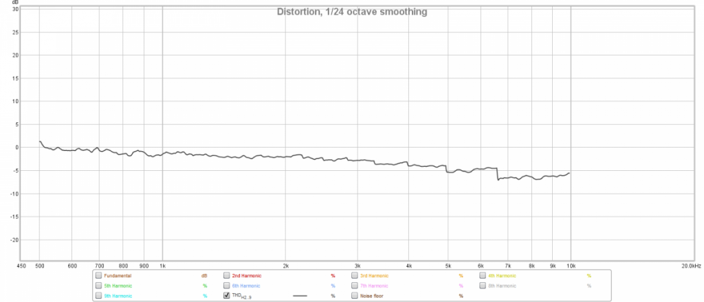

Okay here's the measurements for the room I tested in, same rough position, but without the driver.
Room SPL:
Room THD:
Danny Richie
Re: GRS-3 vs Neo 3
« Reply #36 on: 25 Sep 2020, 01:46 am »
Your room must be a lot quieter than most. That's really good. But you are also cutting it at 500Hz. Below that is usually where a lot shows up.
Hobbsmeerkat
  • Posts: 2741
Re: GRS-3 vs Neo 3
« Reply #37 on: 25 Sep 2020, 02:13 am »
Maybe? But It might be just depend on what devices are running? But I was cutting if off at 500 to prevent risk of damage to the drivers.
Here's 3 tests:
Magenta: with AC unit running outside about 10 ft away
Red: With upstairs unit defrosting
Green: No AC running, the room is near silent.
