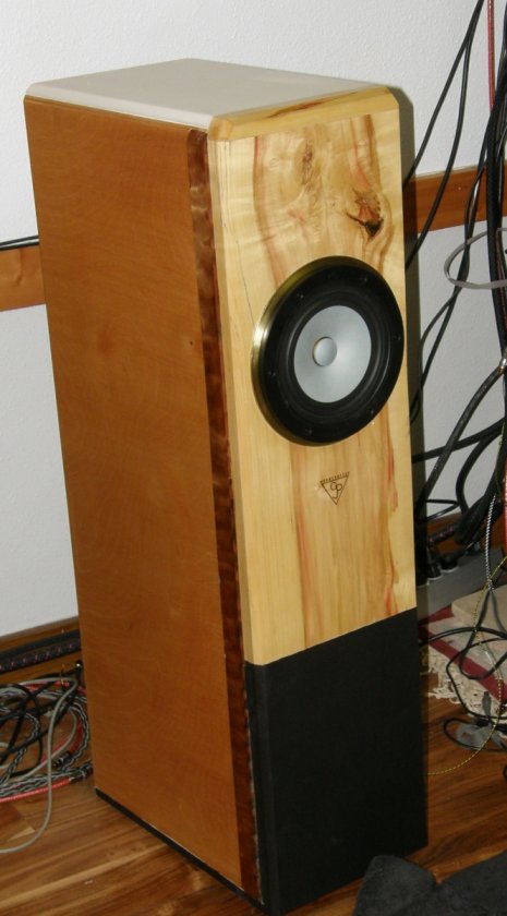

  I agree mostly with your observations. For over a decade, I have taken off the lid from every component that comes through my shop, and found a way to deaden the chassis. Instead of blue tack, I found a material used to hang pictures (small ones) in museums that stays tacky and has the same consistency of Blue tack. It costs about $3-4 per pack and goes a long way. When you look at how many of component chassis are built to begin with, it becomes obvious to place some sort of damping material especially in the corners of the chassis. When complete, I will tap the chassis on all sides and listen. To my surprise it of takes more than one try to get things to have a thud rather than a 'poink' rattle, or hollow sound. Two exceptions that I found among my gear were a BPT power conditioner, which is very massively built and a Cayin CD22 plater. which is built much the same way (at 28 pounds!). I added a bit here and there anyway.
 I would say that speakers, at least most of them would benefit from  attention in this way more than components. Each of my speakers are heavy at 100 lbs. but there is a 30 lb. granite block sitting atop anyway. Since they are a of a horn design, and the port hole hole leading to the throat of the horn is at the top of the speaker, this seems to be a good place for extra mass.
 Here is a shot without the block on top. The top of the cabinet is made from 3/4" MDF covered with 3/4" Corian.
