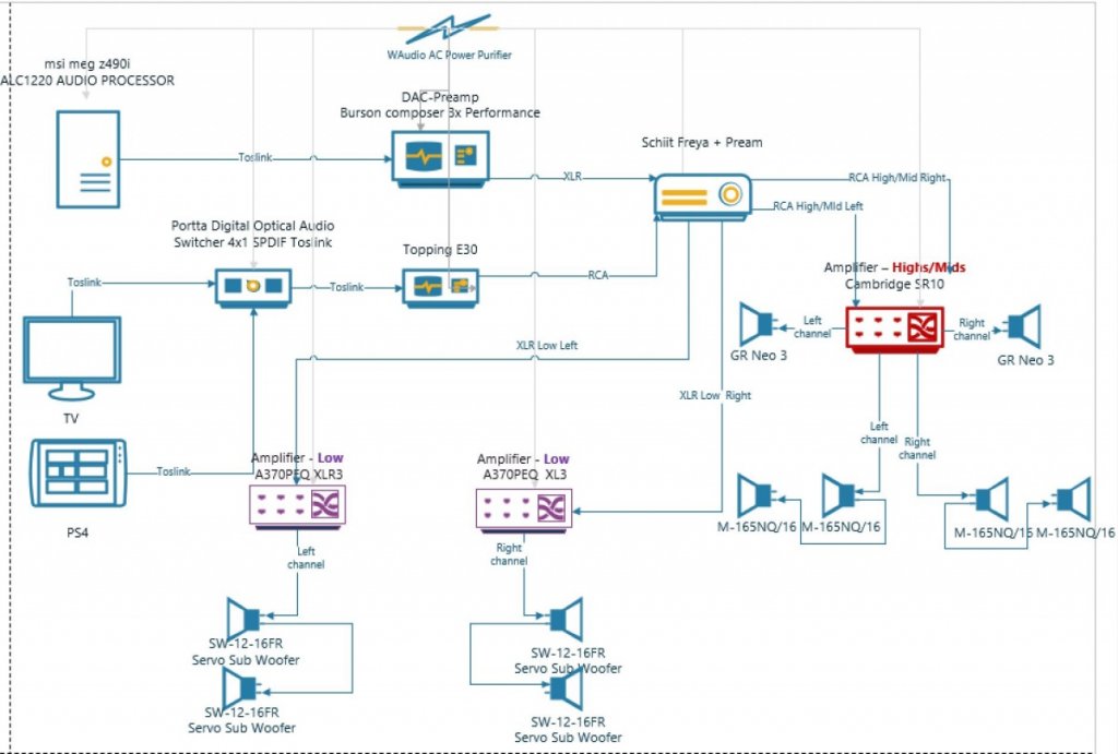

Hello Everybody,
As per the previous topic, The Stereo Receiver in the following diagram is being identified as the main bottleneck of my future set-up.
Right Now I only have the sources & Dacs, and I am planning to get the NX Ottica MTM and Servo Subs by Next Year (when the border reopens).
To replace my Old Topaz SR10 Receiver I thought about couple options with pros and cons, but I am kind of stuck with this not being able to think out of the box, maybe you can help with your experience.
Current plan is here
Here are the options I am thinking about

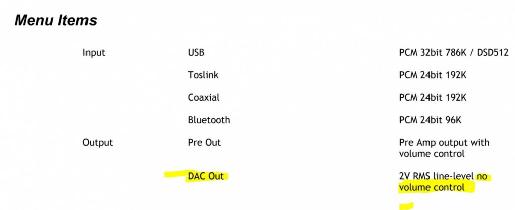

Burson  preamp  feeding a Schiit preamp = disaster
KISS
Shawn
They tought about that I guess, you can bypass the DAC Preamp in the menu
Source: https://drive.google.com/file/d/1EAfH_M0fnWNWGzleGB3PiljcG-VhNfrn/view

Thanks Early B
1. So yes this will be stereo - The schematic is for all drivers and amps required for a NX Ottica  MTM and Servo Subs.
2. Intersting, I checked the Thallo, excuse my ignorance, but I don't see where the difference is except that THALLOS is a 120 w instead of 80 W, and has slightly more distortion. I assumed that OB MTM is a very efficient speaker, Maybe I am wrong, I couldn't find the sensitivity anywhhere.
3. Yes I removed the toslink switch from the audiophile signal Path, following Shawn's advice.
The cleanest signal path I presume would be to get a big integrated amp, but with the challenge that the power supply is shared accross all components, and with my experience, the power supply matters a lot, so I select my components looking at the best power supply supply to get a transparent noise free sound, preferably with xlr connections.
If this makes sense.

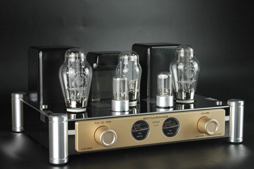

I was thinking about this guy at around 700USD, and swap tubes - I am not sure I will have the patience to build an Elekit.
BOYUURANGE A50 MKIII 300B SINGLE-END CLASS A TUBE INTERGRATED AMPLIFIER REISONG
Specification:
Voltage amplification and promotion tubes: 6N8P (6SN7) × 2
Power output tube: 300B × 2 (brand PSVANE)
Rectifier: 5Z3PAT × 1
Output power: 7.6W x 2 (Class A) (No negative feedback)
Frequency response: 30Hz-42KHz
Output impedance: 4Ω, 8Ω
