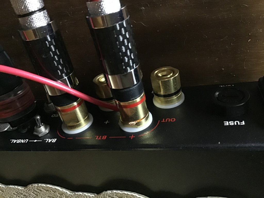

Hi, I had attached the photos of the back of my amp with connection for Nuprime factory review, many thanks!
